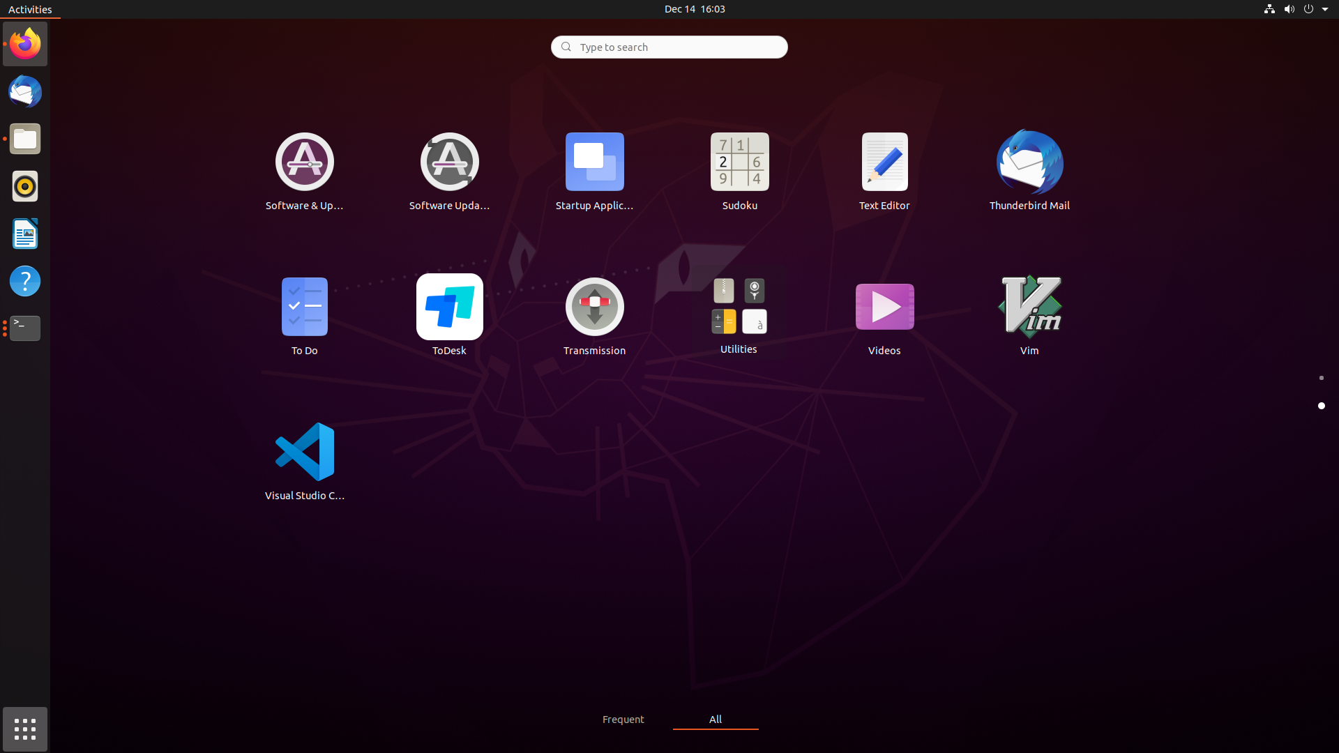

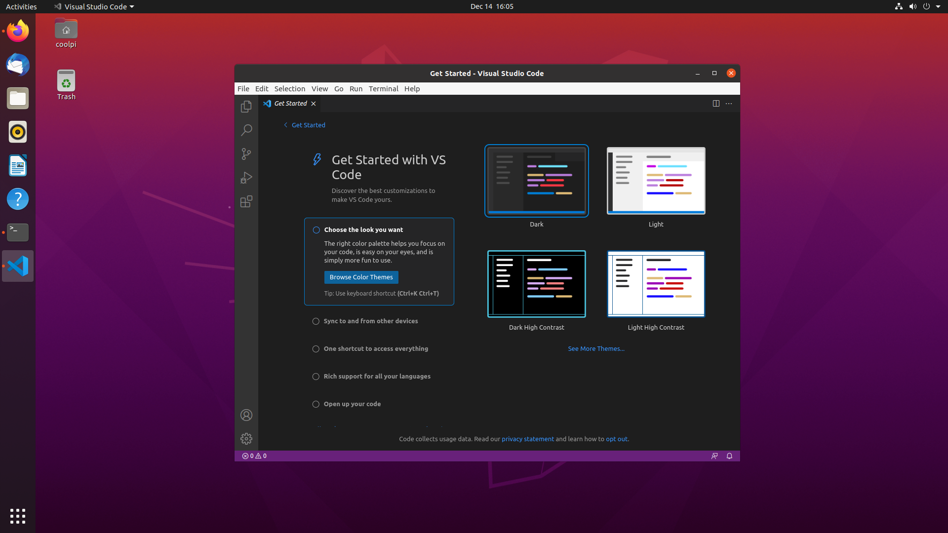

      download deb file: https://code.visualstudio.com/docs/?dv=linuxarm64_deb
      coolpi@coolpi:~/Downloads$ lsb_release -a
      No LSB modules are available.
      Distributor ID:	Ubuntu
      Description:	Ubuntu 20.04 LTS
      Release:	20.04
      Codename:	focal
      coolpi@coolpi:~/Downloads$ sudo dpkg -i code_1.74.0-1670258379_arm64.deb
      [sudo] password for coolpi:
      Selecting previously unselected package code.
      (Reading database ... 132779 files and directories currently installed.)
      Preparing to unpack code_1.74.0-1670258379_arm64.deb ...
      Unpacking code (1.74.0-1670258379) ...
      Setting up code (1.74.0-1670258379) ...
      Processing triggers for gnome-menus (3.36.0-1ubuntu1) ...
      Processing triggers for desktop-file-utils (0.24-1ubuntu3) ...
      Processing triggers for mime-support (3.64ubuntu1) ...
      Processing triggers for shared-mime-info (1.15-1) ...
