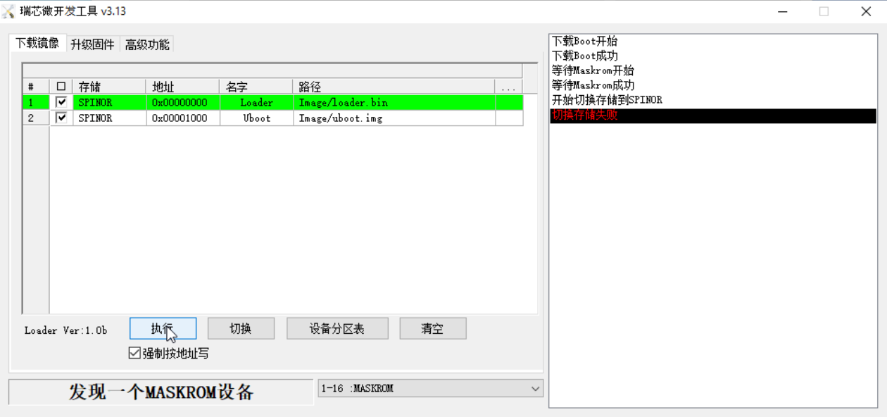

          @George tried the tool, that gives me an error

            @Momo-0
            This firmware is fine, you can try again a few times. If it still doesn't work, follow the following steps:
            1.Remove the back cover of the machine. There is a button on the motherboard near the SSD connector。
            2.Press the button, then press the power button on the laptop to turn it on, and the machine will enter maskrom mode.
            3.Burn in the firmware again using the previous method.
            M 2 Replies Last reply Reply Quote 0
