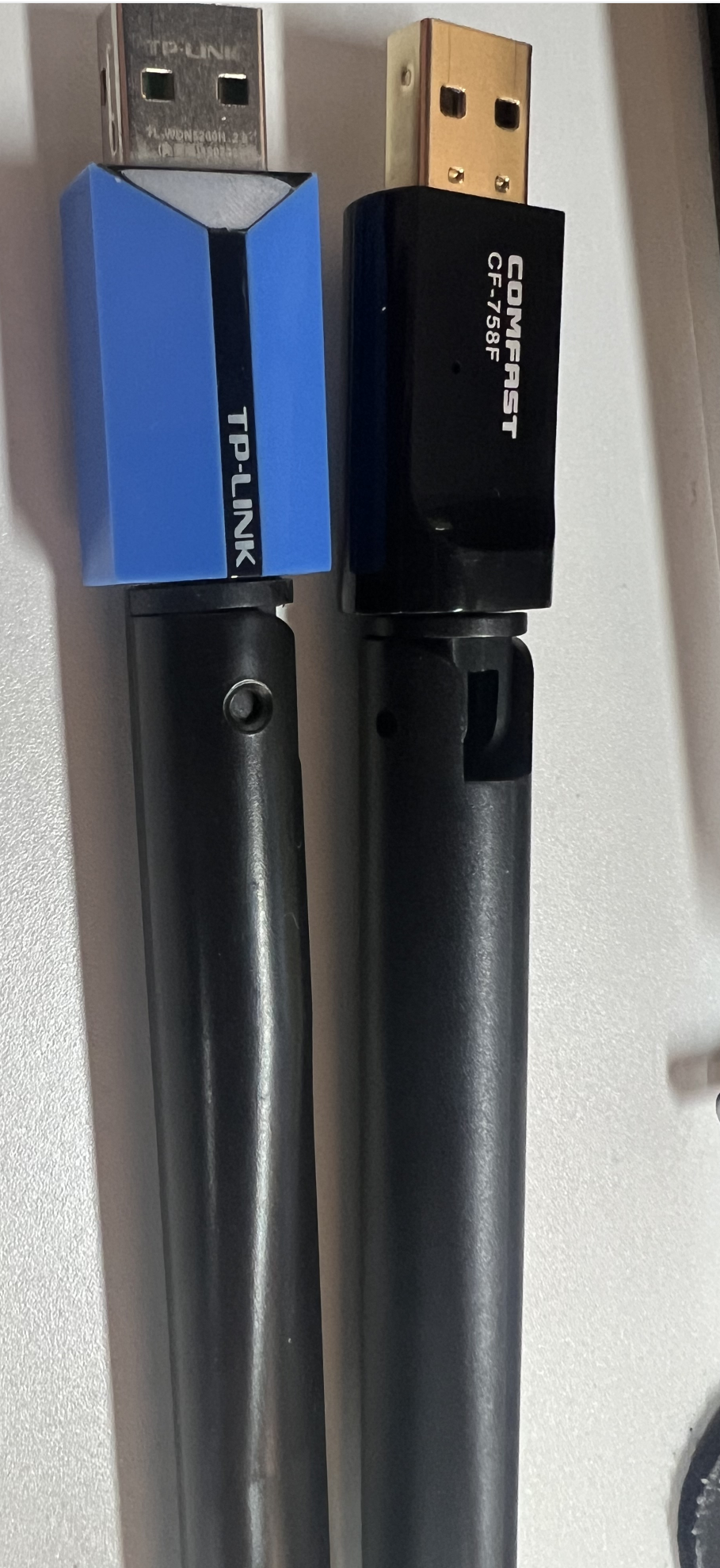

      开机之前接入USB无线网卡 会导致无法开机 拔掉无线网卡 开机过程会继续
      用的是图片中的网卡
      开机过程的日志如下 之间空白的地方卡住 拔掉网卡后又继续了
      系统是debian11

      [   16.983473] rkcif-mipi-lvds2: There is not terminal subdev, not synchronized with ISP
      [   16.992497] RKNPU fdab0000.npu: can't request region for resource [mem 0xfdab0000-0xfdabffff]
      [   17.001016] RKNPU fdab0000.npu: can't request region for resource [mem 0xfdac0000-0xfdacffff]
      [   17.009526] RKNPU fdab0000.npu: can't request region for resource [mem 0xfdad0000-0xfdadffff]
      [   17.021635] debugfs: Directory 'fdab0000.npu-rknpu' with parent 'vdd_npu_s0' already present!
      [   17.050222] RKNPU fdab0000.npu: failed to find power_model node
      [   17.056132] RKNPU fdab0000.npu: RKNPU: failed to initialize power model
      [   17.062732] RKNPU fdab0000.npu: RKNPU: failed to get dynamic-coefficient
      [   17.809743] rk-pcie fe180000.pcie: PCIe Link Fail
      [   17.814445] rk-pcie fe180000.pcie: failed to initialize host
      [   17.846411] rk-pcie fe160000.pcie: PCIe Link Fail
      [   17.846451] rk-pcie fe150000.pcie: PCIe Link Fail
      [   17.851110] rk-pcie fe160000.pcie: failed to initialize host
      [   17.855801] rk-pcie fe150000.pcie: failed to initialize host
      [   18.174213] rk_hdmirx fdee0000.hdmirx-controller: hdmirx_cancel_cpu_limit_freq freq qos nod add
      [   50.663077] scsi 1:0:0:0: rejecting I/O to dead device
      writable: recovering journal
      writable: clean, 307973/3777312 files, 11793258/15132672 blocks
      [   51.822102] rkcif-mipi-lvds2: rkcif_update_sensor_info: stream[2] get remote terminal sensor failed!
      [   51.826966] rkcif-mipi-lvds2: rkcif_update_sensor_info: stream[3] get remote terminal sensor failed!
      [   51.826966] stream_cif_mipi_id3: update sensor info failed -19
      [   51.830136] rkcif-mipi-lvds2: rkcif_update_sensor_info: stream[2] get remote terminal sensor failed!
      [   51.830137] stream_cif_mipi_id2: update sensor info failed -19
      [   51.831241] rkcif_tools_id2: update sensor info failed -19
      [   51.832961] rkcif-mipi-lvds2: rkcif_update_sensor_info: stream[0] get remote terminal sensor failed!
      [   51.832963] rkcif_scale_ch0: update sensor info failed -19
      [   51.840250] rkcif-mipi-lvds2: rkcif_update_sensor_info: stream[0] get remote terminal sensor failed!
      [   51.840251] rkcif_tools_id0: update sensor info failed -19
      [   51.840689] rkcif-mipi-lvds2: rkcif_update_sensor_info: stream[2] get remote terminal sensor failed!
      [   51.850908] rkcif-mipi-lvds2: rkcif_update_sensor_info: stream[1] get remote terminal sensor failed!
      [   51.850910] rkcif_tools_id1: update sensor info failed -19
      [   51.854725] rkcif-mipi-lvds2: rkcif_update_sensor_info: stream[0] get remote terminal sensor failed!
      [   51.854727] stream_cif_mipi_id0: update sensor info failed -19
      [   51.855342] rkcif_scale_ch2: update sensor info failed -19
      [   51.905401] rkcif-mipi-lvds2: rkcif_update_sensor_info: stream[1] get remote terminal sensor failed!
      [   51.949330] rkcif_scale_ch1: update sensor info failed -19
      [   51.979595] rkcif-mipi-lvds2: rkcif_update_sensor_info: stream[3] get remote terminal sensor failed!
      [   51.988766] rkcif_scale_ch3: update sensor info failed -19
      [   51.999913] rkcif-mipi-lvds2: rkcif_update_sensor_info: stream[1] get remote terminal sensor failed!
      [   52.009148] stream_cif_mipi_id1: update sensor info failed -19
      [   38.568607] rc.local[952]: cat: '/sys/bus/sdio/devices/mmc1\:*\:1/modalias': 没有那个文件或目录
        尝试把uboot升级到最新版本。百度网盘有最新的镜像。
