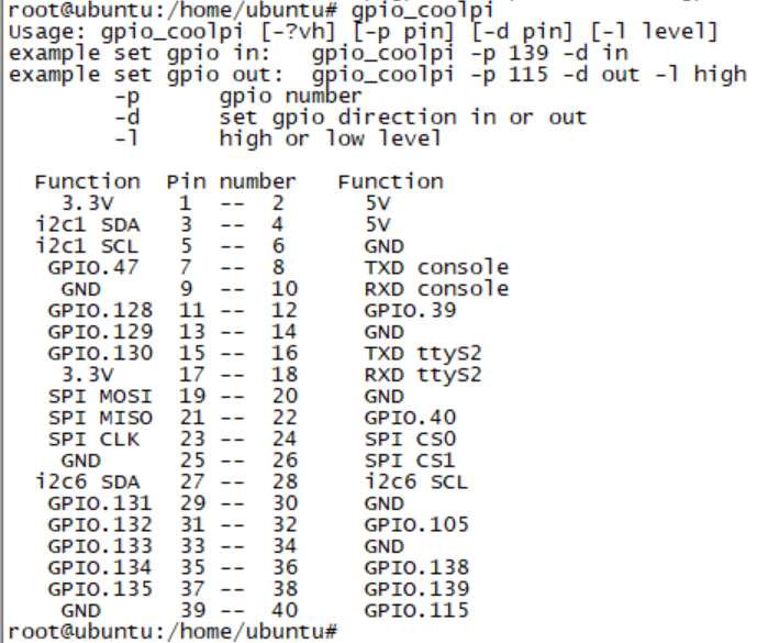

      default gpio cfg with system image:
      gpio_coolpi
      test.py

              jack_admin @花月 last edited by
              @花月
              系统中若无该命令,请将附件文件拷贝到/usr/sbin/,再执行chmod a+x /usr/sbin/gpio_coolpi
              gpio_coolpi
              SPI与I2C操作使用标准python或标准C调用API

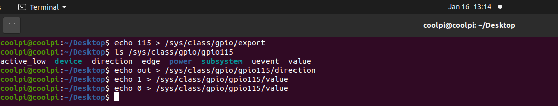

                    @george Is there any way to use GPIOs without sudo priviledge, such as in a ros package?
                      大法师 @dreamer last edited by 大法师
                      @dreamer
                      hi, please add extra operation for coolpi user.
                      Add rules for normal user:
                      sudo echo "SUBSYSTEM==\"gpio*\", ACTION==\"add\", PROGRAM=\"/bin/bash -c 'chown root:coolpi /sys/class/gpio/export /sys/class/gpio/unexport;chmod 220 /sys/class/gpio/export /sys/class/gpio/unexport'\"" > /lib/udev/rules.d/99-gpio.rules
                      sudo echo "SUBSYSTEM==\"gpio*\", ACTION==\"add\", PROGRAM=\"/bin/bash -c 'chown root:coolpi /sys%p/direction /sys%p/value /sys%p/edge /sys%p/active_low; chmod 0660 /sys%p/direction /sys%p/value /sys%p/edge /sys%p/active_low'\"" >> /lib/udev/rules.d/99-gpio.rules
                      sudo reboot
                      Check rules:
                      coolpi@coolpi:~/Desktop$ cat /lib/udev/rules.d/99-gpio.rules
                      SUBSYSTEM=="gpio*", ACTION=="add", PROGRAM="/bin/bash -c 'chown root:coolpi /sys/class/gpio/export /sys/class/gpio/unexport;chmod 220 /sys/class/gpio/export /sys/class/gpio/unexport'"
                      SUBSYSTEM=="gpio*", ACTION=="add", PROGRAM="/bin/bash -c 'chown root:coolpi /sys%p/direction /sys%p/value /sys%p/edge /sys%p/active_low; chmod 0660 /sys%p/direction /sys%p/value /sys%p/edge /sys%p/active_low'"
                      Test case:
                      coolpi@coolpi:~/Desktop$ echo 115 > /sys/class/gpio/export
                      coolpi@coolpi:~/Desktop$ ls /sys/class/gpio/gpio115
                      active_low  device  direction  edge  power  subsystem  uevent  value
                      coolpi@coolpi:~/Desktop$ echo out > /sys/class/gpio/gpio115/direction
                      coolpi@coolpi:~/Desktop$ echo 1 > /sys/class/gpio/gpio115/value
                      coolpi@coolpi:~/Desktop$ echo 0 > /sys/class/gpio/gpio115/value
