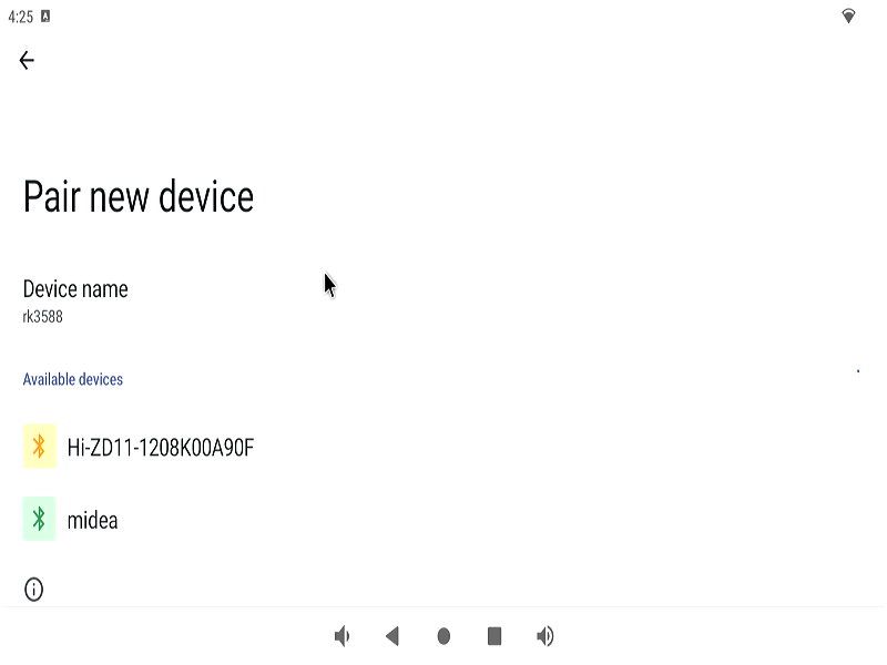

                                  • R
                                    retroman last edited by
                                    Hello! Thank you for working hard during your Chinese New Year! I don't want to bug you on your break, but when you get a chance can you enable bluethooth on Android? I really need bluetooth for my project. Thanks!
                                      大法师 @retroman last edited by 大法师
                                      @retroman Bluetooth feature has been added to support. I will upload a new image file (20230118) to onedrive.
                                      R 1 Reply Last reply Reply Quote 0
                                      • R
                                        retroman @大法师 last edited by
                                        @大法师 Thank you very much!
