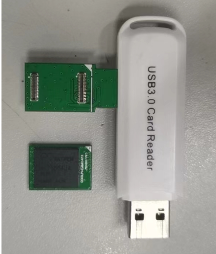

        How do you flash this onto the emmc? Can anyone outline the steps in English? Thanks in advance.
          george @HiramXMaxim last edited by
          @HiramXMaxim The EMMC small board has an adapter for converting to TF card, which can be written to the EMMC using a common card reader. As shown in the figure below.

          • H
            Thank you. This is my first time working with emmc.

                              I purchased the reader and when I insert it into any of my computers Windows 11, Debian 11 none of them recognize the emmc module. Etcher, et al, do not show any available flash devices. Am I missing some device drivers or should it just work? I have 3 CoolPi's and I've tried all the adapters and emmc modules.
                                @HiramXMaxim This may be the compatibility problem of the card reader. You can first make the image into the TF card, and then use the migration script of armbian to migrate the image to EMMC.
                                  @HiramXMaxim Please provide the model of the card reader you use, or take a photo and send it to us. Let's buy the same model and test it. thank you.
