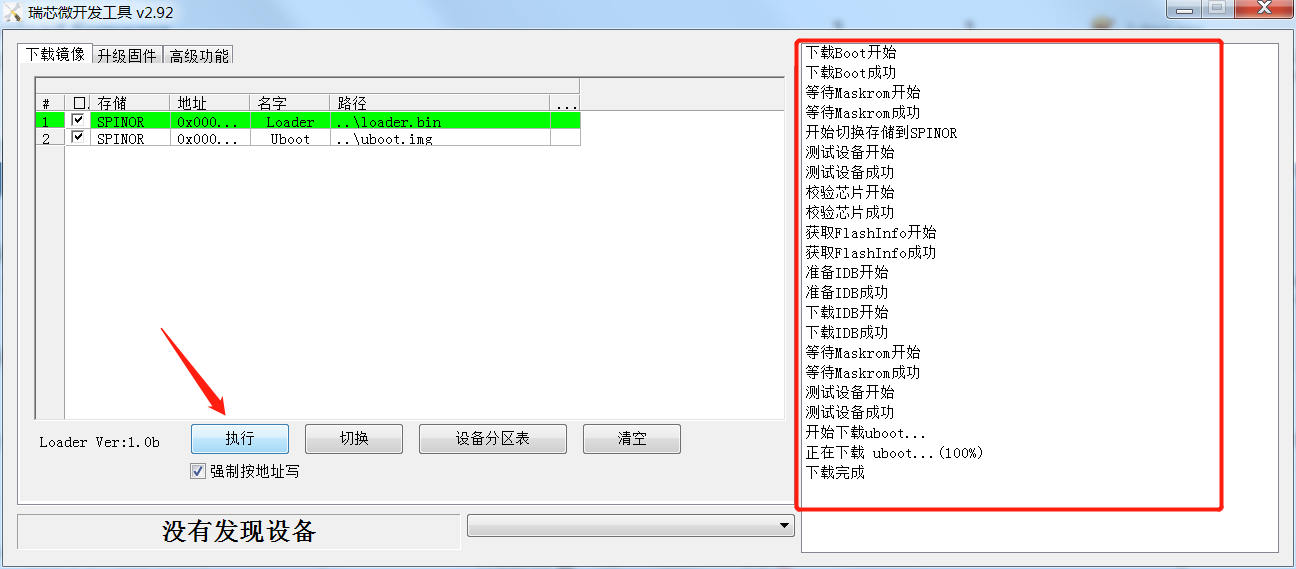

      If you need to boot armbian normally, you need to update the loader file to version 0104.
      Follow the steps below to update the loader:

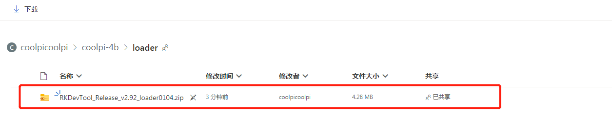

      • Download the latest loader file One Drive
        ![5594e1d4-3a7b-46fc-a7b5-2a9fe418dfc0-image.png]
      • Short the 2 pins shown by the arrow.

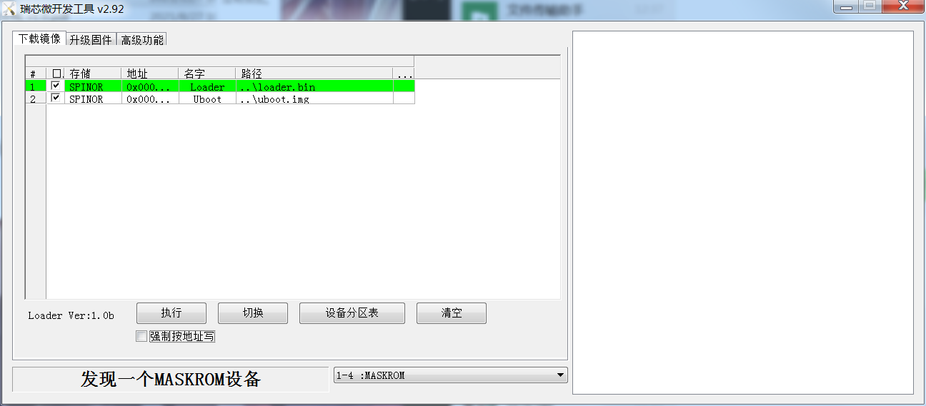

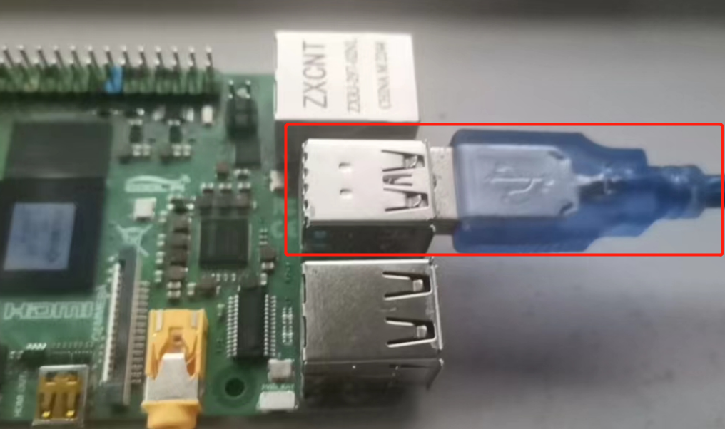

      • The USB interface and computer connection.
      • Plug in the power supply and open the upgrade software. The machine enters the maskrom upgrade mode.

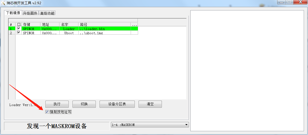

      • choose to write by address
      • Click Execute to complete the loader update.

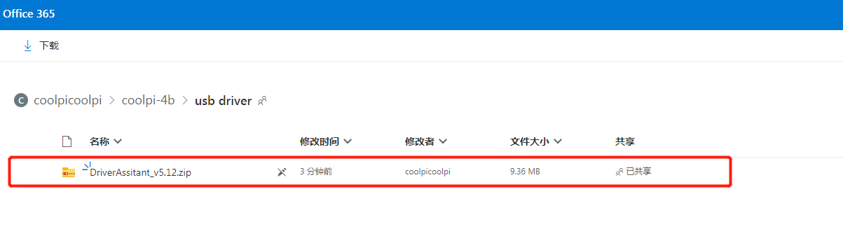

      • If the computer prompts that the USB driver cannot be found, please download and install the driver software first.One Drive

        reddfoxx @george last edited by
        @george Could you give some guidance on what type of USB cable is needed?
          george @reddfoxx last edited by
          @reddfoxx Refer to attachment link:
