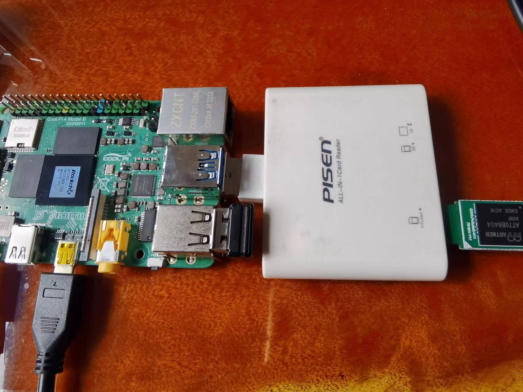

          @大法师 Interesting. It looks like the emmc is connected to the USB port. Have you tried to put the emmc on the coolpi board yet? I got the infinite loop while putting the emmca on the coolpi board. Did I miss anything in set up?Thx
            大法师 @nickliu last edited by 大法师
            @nickliu emmc onboard also nice!

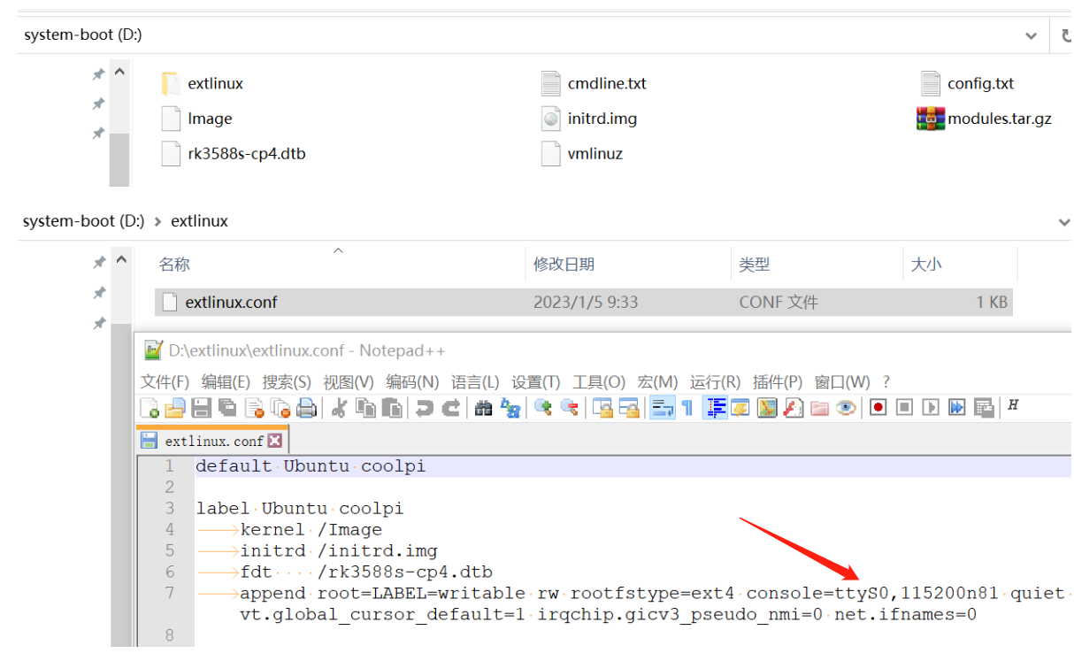

            change console to ttyS1, and then boot again if something output message from HDMI.
            N 1 Reply Last reply Reply Quote 0
