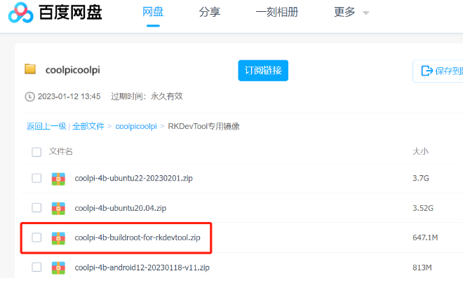

      OV5647模块适用于Cool Pi 4b

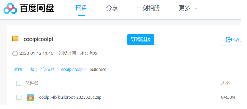

      Use buildroot system image for test camera ov5647.
      离线刷机镜像
      在线刷机镜像

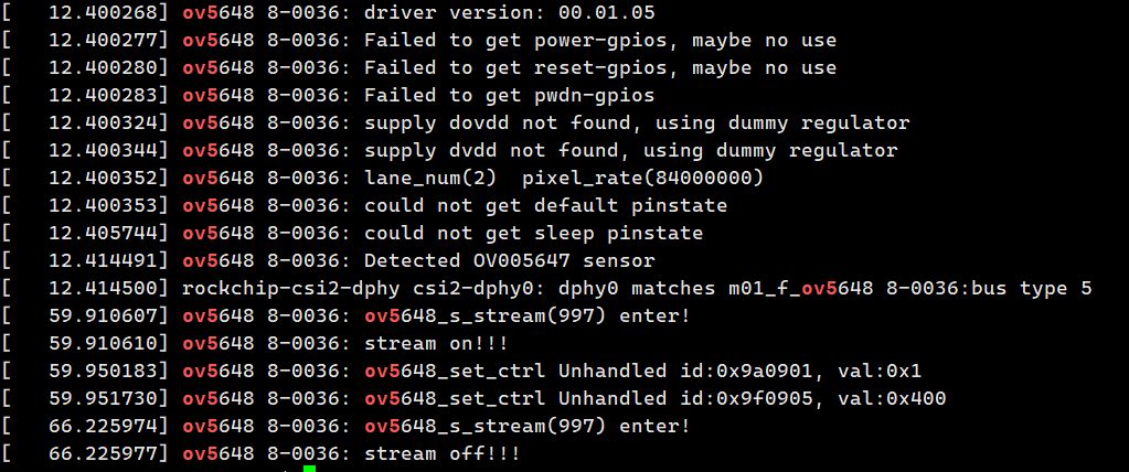

                  @大法师 刷入提供的最新的ubuntu20.04 执行dmesg
                  10.083104] ov5647 8-0036: Unsupported clock frequency: 24000000
                  [ 10.089129] ov5647: probe of 8-0036 failed with error -22
                  如何配置?
                  另最新的20.04 ros2 opencv miniconda 安装正常了
                    大法师 @bg8wj last edited by 大法师
                    @bg8wj github已更新内核驱动代码。二进制执行文件明天测试好再上传

                    root@coolpi:/home/coolpi# dmesg | grep ov564
                    [   11.285152] ov5648 8-0036: driver version: 00.01.05
                    [   11.285181] ov5648 8-0036: Failed to get power-gpios, maybe no use
                    [   11.285193] ov5648 8-0036: Failed to get reset-gpios, maybe no use
                    [   11.285205] ov5648 8-0036: Failed to get pwdn-gpios
                    [   11.285305] ov5648 8-0036: supply dovdd not found, using dummy regulator
                    [   11.285372] ov5648 8-0036: supply dvdd not found, using dummy regulator
                    [   11.285409] ov5648 8-0036: lane_num(2)  pixel_rate(84000000)
                    [   11.285416] ov5648 8-0036: could not get default pinstate
                    [   11.290827] ov5648 8-0036: could not get sleep pinstate
                    [   11.299689] ov5648 8-0036: Detected OV005647 sensor
                    [   11.299707] rockchip-csi2-dphy csi2-dphy0: dphy0 matches m01_f_ov5648 8-0036:bus type 5

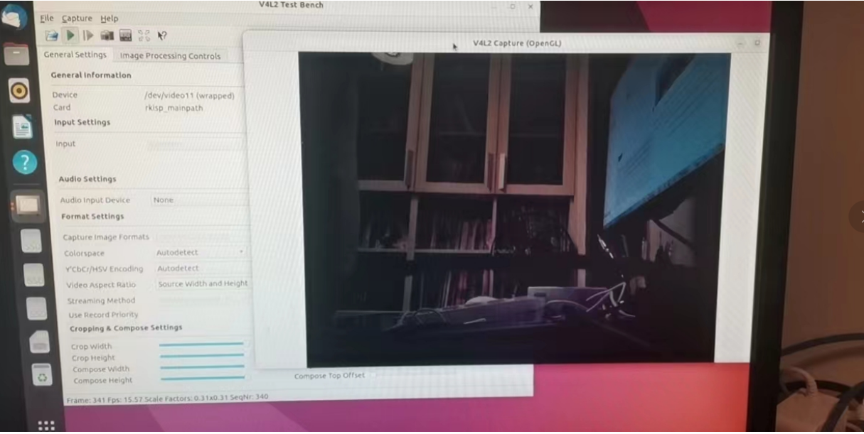

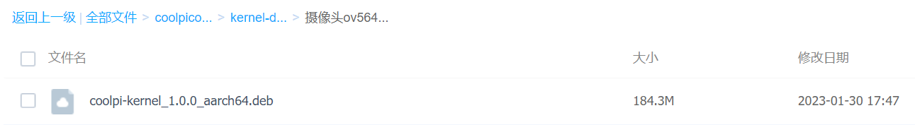

                          @bg8wj 谢谢!我们验证好了会同步发布出来。这款主板还有很多功能可以挖掘,需要更多的伙伴一起共赢!
                            暂时未重新打包刷机镜像,可以先独立更新内核驱动包。
                            百度网盘
                            coolpi@coolpi:~$ sudo dpkg -i coolpi-kernel_1.0.0_aarch64.deb
                            coolpi@coolpi:~$ sync
                            coolpi@coolpi:~$ sudo reboot
                            重启系统,如有连接ov5647摄像头,可以识别到video设备。
                            coolpi@coolpi:~$ sudo apt install v4l-utils
                            coolpi@coolpi:~$ v4l2-ctl --list-devices
                            rkisp-statistics (platform: rkisp):
                                    /dev/video18
                                    /dev/video19
                            rkcif (platform:rkcif-mipi-lvds2):
                                    /dev/video0
                                    /dev/video1
                                    /dev/video2
                                    /dev/video3
                                    /dev/video4
                                    /dev/video5
                                    /dev/video6
                                    /dev/video7
                                    /dev/video8
                                    /dev/video9
                                    /dev/video10
                            rkisp_mainpath (platform:rkisp0-vir0):
                                    /dev/video11
                                    /dev/video12
                                    /dev/video13
                                    /dev/video14
                                    /dev/video15
                                    /dev/video16
                                    /dev/video17
                            B 1 Reply Last reply Reply Quote -1

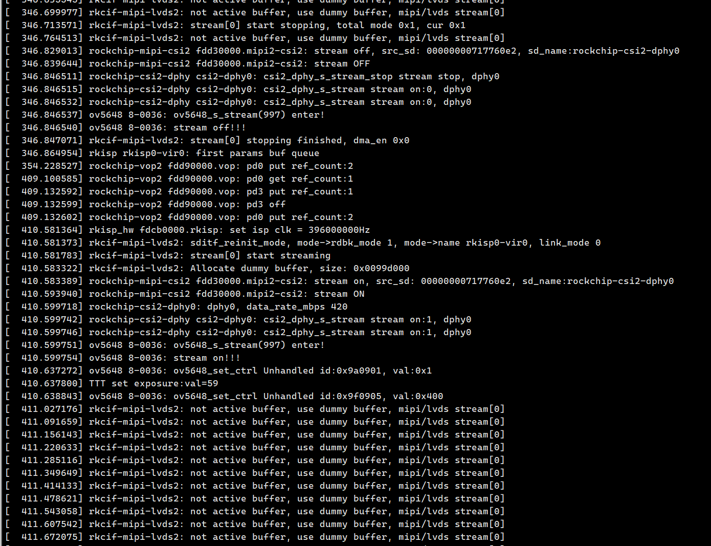

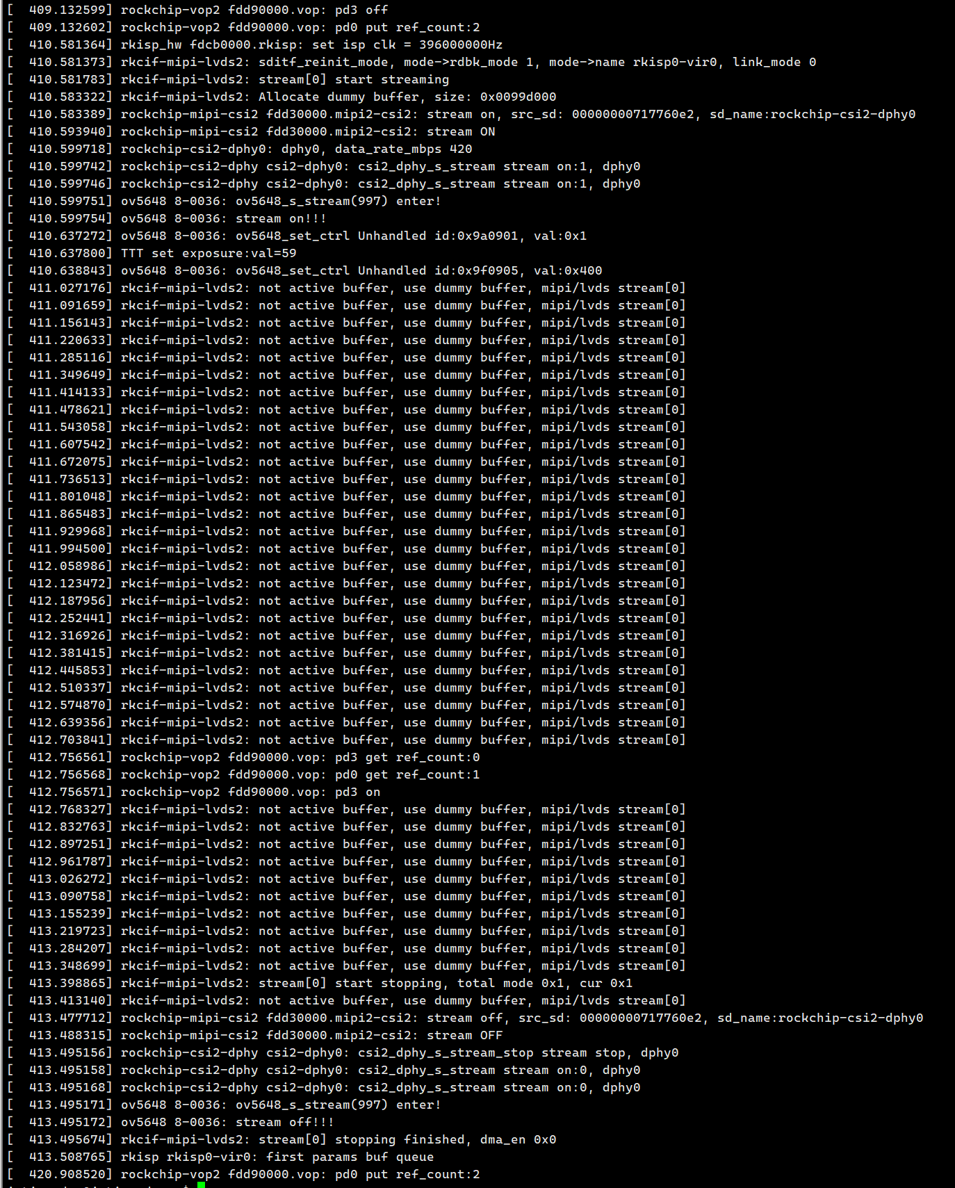

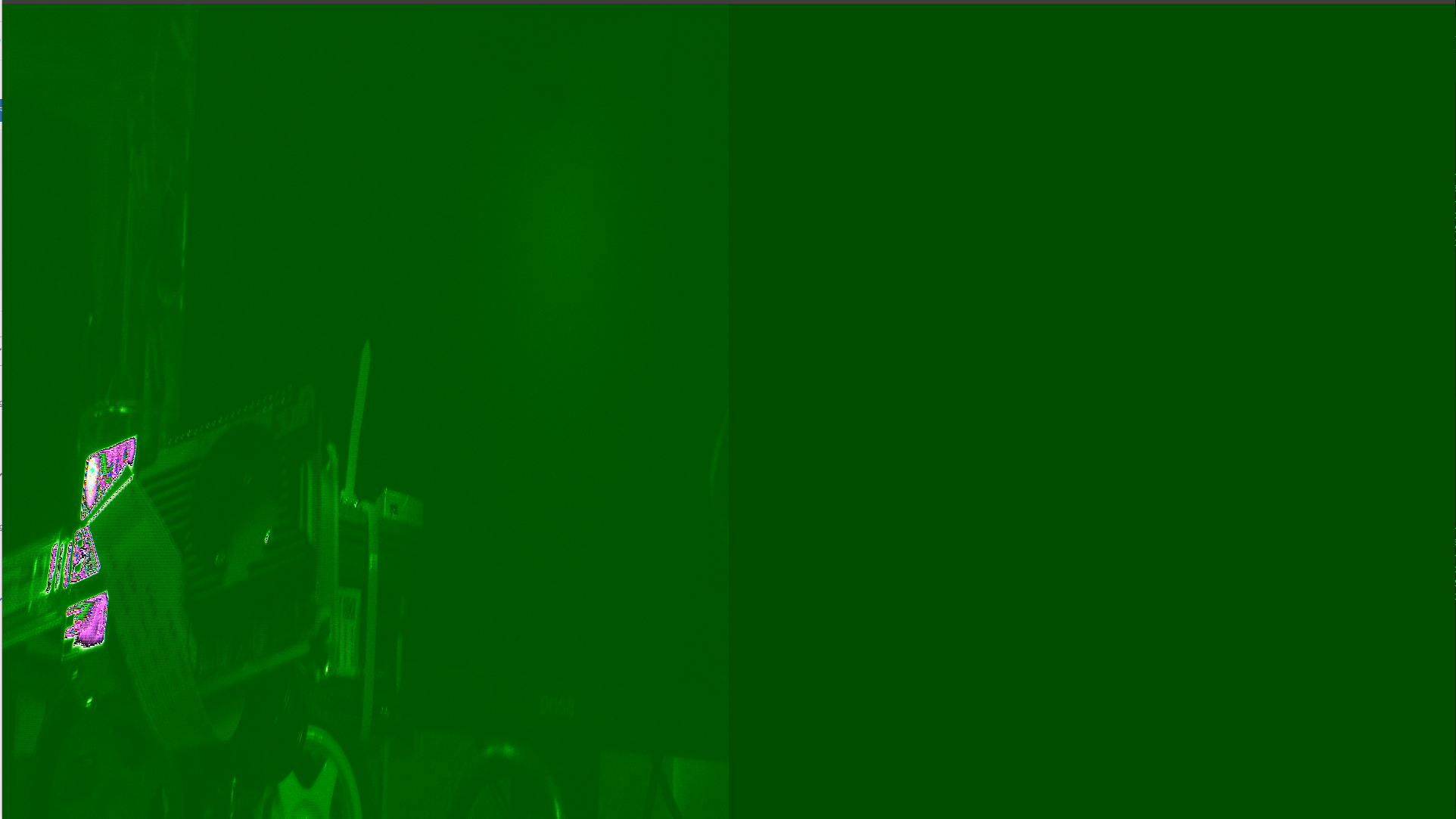

                                  Hi, I tried the new kernel with two OV5647 camera.
                                  It looks the default configuration is not correct.
                                  The command I used
                                  sudo v4l2-ctl --verbose -d /dev/video0 --set-fmt-video=width=1920,height=1080,pixelformat='NV12' --stream-mmap=4 --set-selection=target=crop,flags=0,top=0,left=0,width=1920,height=1080 --stream-to=out1.yuv
                                  ffplay out1.yuv  -pixel_format nv12 -video_size 1920x1080
                                  The system message
                                  @Ubuntu:~$ dmesg | grep 'ov5'
                                  [    7.644913] ov5648 8-0036: driver version: 00.01.05
                                  [    7.644958] ov5648 8-0036: Failed to get power-gpios, maybe no use
                                  [    7.644976] ov5648 8-0036: Failed to get reset-gpios, maybe no use
                                  [    7.644994] ov5648 8-0036: Failed to get pwdn-gpios
                                  [    7.645126] ov5648 8-0036: supply dovdd not found, using dummy regulator
                                  [    7.645216] ov5648 8-0036: supply dvdd not found, using dummy regulator
                                  [    7.645268] ov5648 8-0036: lane_num(2)  pixel_rate(84000000)
                                  [    7.645277] ov5648 8-0036: could not get default pinstate
                                  [    7.650710] ov5648 8-0036: could not get sleep pinstate
                                  [    7.660168] ov5648 8-0036: Detected OV005647 sensor
                                  [    7.660205] rockchip-csi2-dphy csi2-dphy0: dphy0 matches m01_f_ov5648 8-0036:bus type 5
                                  [  123.522013] ov5648 8-0036: ov5648_s_stream(997) enter!
                                  [  123.522018] ov5648 8-0036: stream on!!!
                                  [  123.574530] ov5648 8-0036: ov5648_set_ctrl Unhandled id:0x9a0901, val:0x1
                                  [  123.577105] ov5648 8-0036: ov5648_set_ctrl Unhandled id:0x9f0905, val:0x400
                                  [  141.109425] ov5648 8-0036: ov5648_s_stream(997) enter!
                                  [  141.109431] ov5648 8-0036: stream off!!!
                                  [  352.460709] ov5648 8-0036: ov5648_s_stream(997) enter!
                                  [  352.460714] ov5648 8-0036: stream on!!!
                                  [  352.506940] ov5648 8-0036: ov5648_set_ctrl Unhandled id:0x9a0901, val:0x1
                                  [  352.508804] ov5648 8-0036: ov5648_set_ctrl Unhandled id:0x9f0905, val:0x400
                                  [  359.915797] ov5648 8-0036: ov5648_s_stream(997) enter!
                                  [  359.915807] ov5648 8-0036: stream off!!!
                                  [  522.868438] ov5648 8-0036: ov5648_s_stream(997) enter!
                                  [  522.868438] ov5648 8-0036: stream on!!!
                                  [  522.907120] ov5648 8-0036: ov5648_set_ctrl Unhandled id:0x9a0901, val:0x1
                                  [  522.908828] ov5648 8-0036: ov5648_set_ctrl Unhandled id:0x9f0905, val:0x400
                                  [  527.994503] ov5648 8-0036: ov5648_s_stream(997) enter!
                                  [  527.994509] ov5648 8-0036: stream off!!!
                                  [  567.407434] ov5648 8-0036: ov5648_s_stream(997) enter!
                                  [  567.407435] ov5648 8-0036: stream on!!!
                                  [  567.448267] ov5648 8-0036: ov5648_set_ctrl Unhandled id:0x9a0901, val:0x1
                                  [  567.450267] ov5648 8-0036: ov5648_set_ctrl Unhandled id:0x9f0905, val:0x400
                                  [  572.471164] ov5648 8-0036: ov5648_s_stream(997) enter!
                                  [  572.471167] ov5648 8-0036: stream off!!!

                                      george @大法师 last edited by

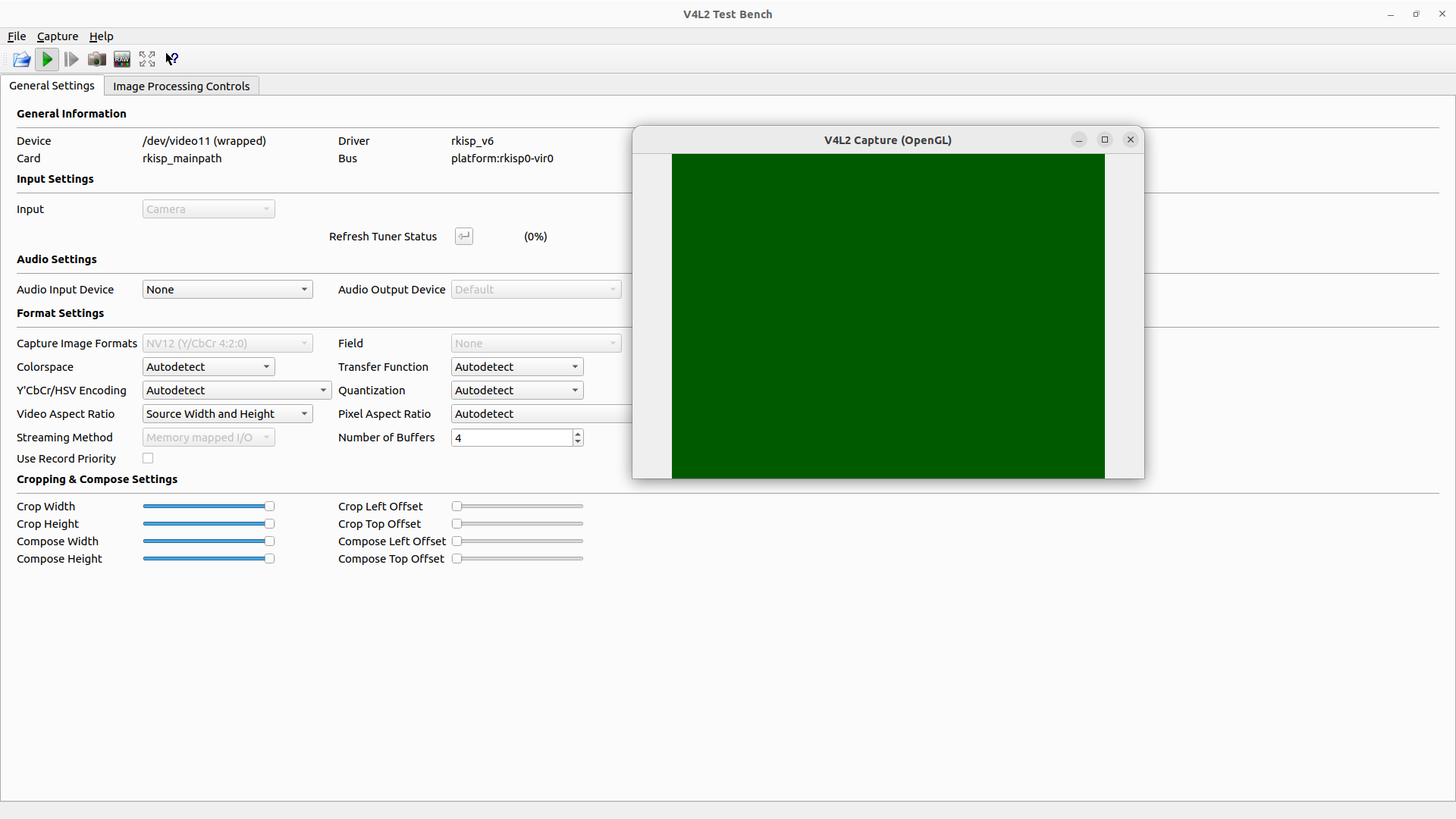

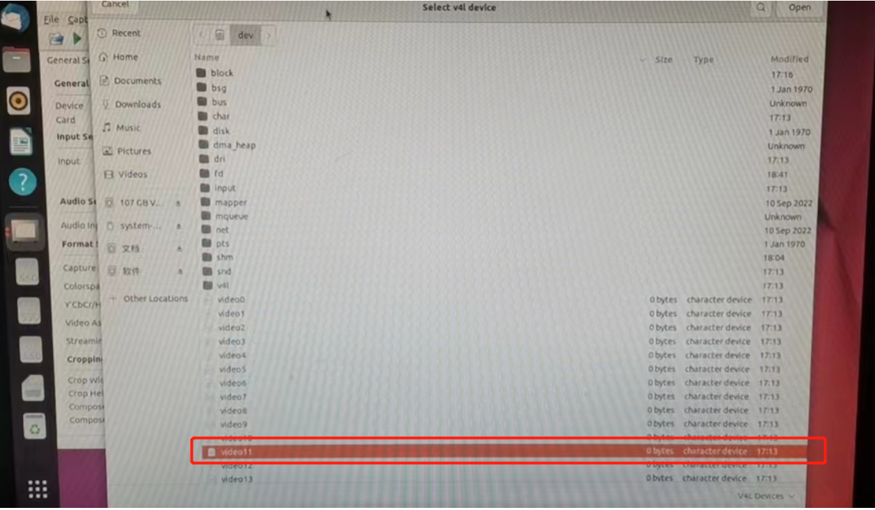

                                      @大法师 The latest ubuntu22.04 image can already support this camera.
                                      • 20230210-ubuntu-22.04-preinstalled-desktop-arm64-coolpi.rar
                                      • V4L2-TEST can start the camera by operating the video11 node
                                      175f6719-6fa9-4acb-bc1e-b9c2fbf623f5-image.png 0ef06ad8-64c6-4d7c-b1a2-4f62d01ea452-image.png

                                                  这是我接的CSI的摄像头
                                                  用V4L2-TEST无法打开 选的/dev/video11
                                                  需要怎么样才能打开 内核是我自己编译的
                                                    这是用V4L2-TEST打开时demsg打印的
