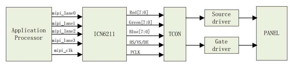

      • Block diagram

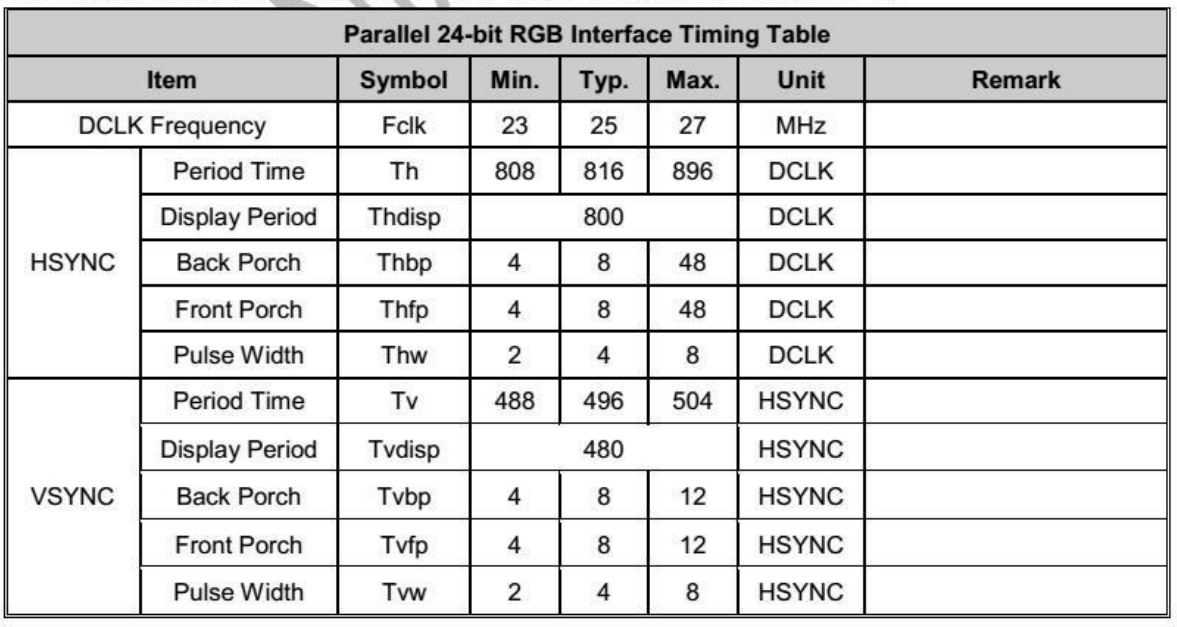

      • Configure lcdc parameters according to LCD specifications.
        LCD specification 5inch DSI LCD (B).pdf
      		disp_timings0: display-timings {
      			native-mode = <&dsi0_timing0>;
      			dsi0_timing0: timing0 {
      				clock-frequency = <25000000>;
      				hactive = <800>;
      				vactive = <480>;
      				hfront-porch = <8>;
      				hsync-len = <4>;
      				hback-porch = <8>;
      				vfront-porch = <8>;
      				vsync-len = <4>;
      				vback-porch = <8>;
      				hsync-active = <0>;
      				vsync-active = <0>;
      				de-active = <0>;
      				pixelclk-active = <0>;

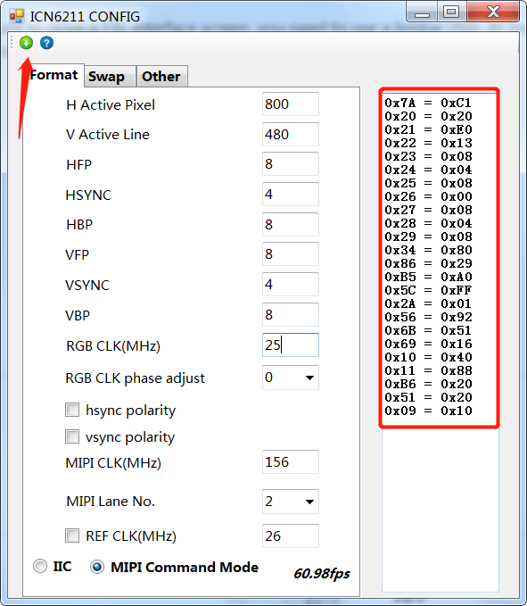

      • Generate the initialization sequence of ICN6211 according to the LCD specification.
        ICN6211 initialization tool ICN6211 Config.rar
      Copy the initialization sequence to DTS according to the command format of rockchip.

      Note that the last 11 29 command is reserved. This is the DSI standard command to open the display.

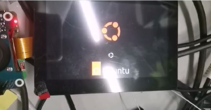

      • The TTL signal can be output normally by recompiling and replacing the kernel.
