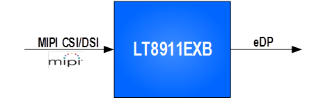

      • Mipi dsi to edp
        Specification LT8911EXB_Datasheet_R1.0.pdf
