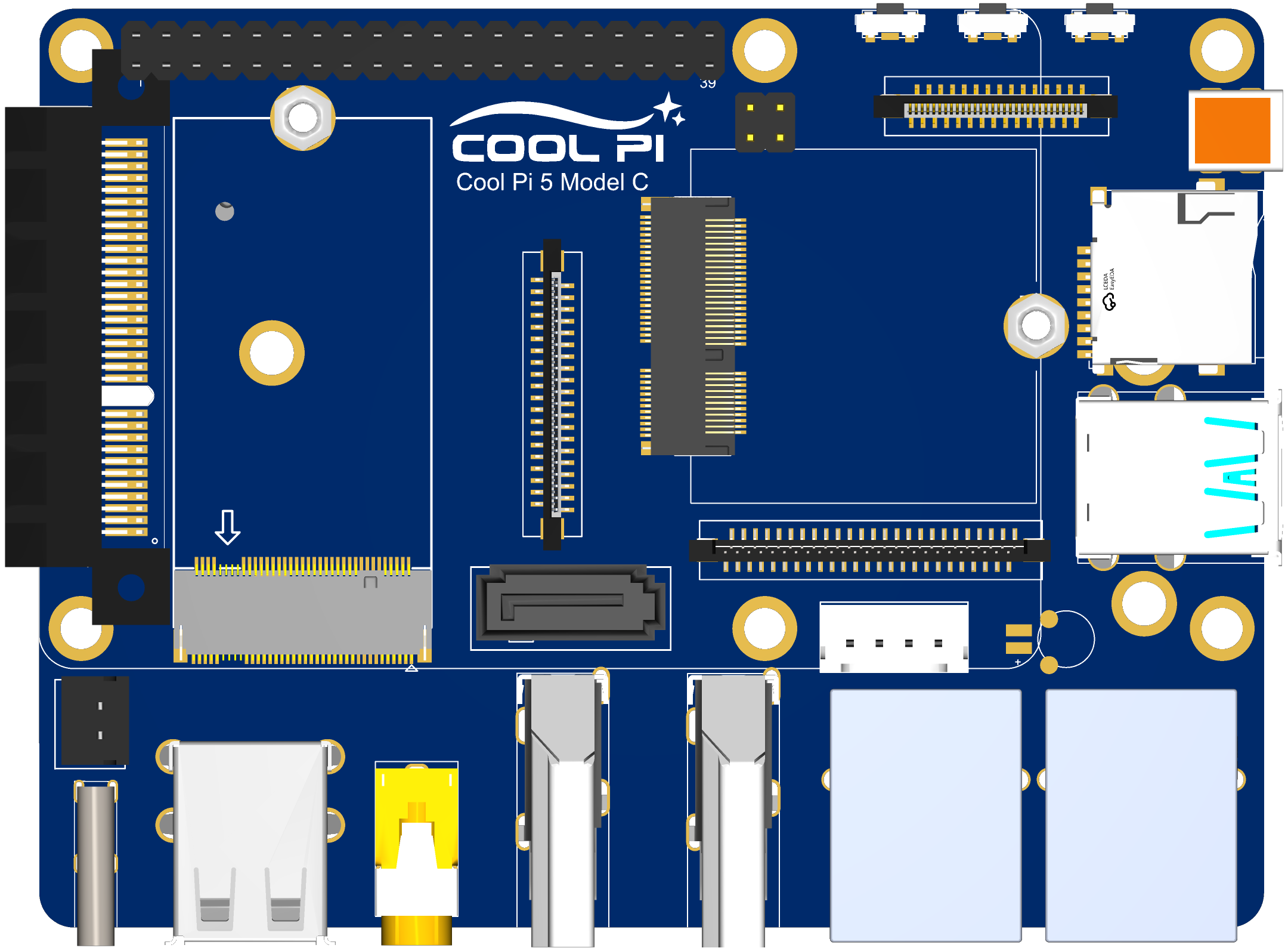

      Top-level interface

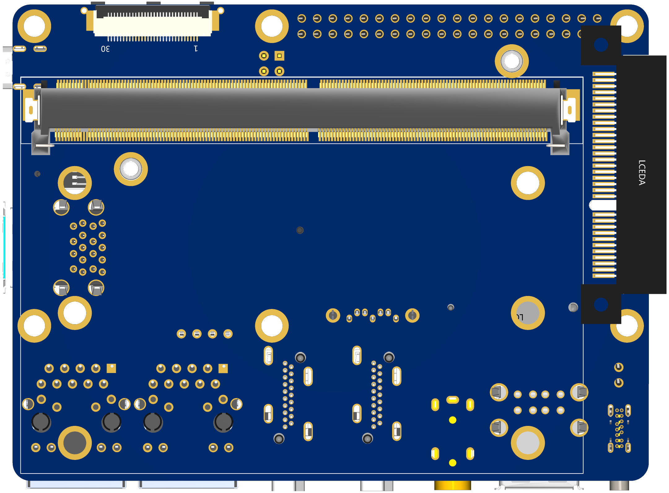

      • The 2X20 pin interface is compatible with CP4 and integrates multiple UART, I2C, SPI, CAN and other functions.
      • Three function keys are PWR, RST and LOADER.
      • 2X2 PIN POE connector,such as CP4.
      • 30pin fpc vertical connector can directly drive standard 30PIN EDP interface LCD. Resolution up to 3840 * 2160
      • The MICRO HDMI-RX interface can support up to 4KP60 video signal input.
      • TF card with self-locking.
      • Two native USB3.0 interfaces, one of which supports OTG function.
      • Two Gigabit Ethernet interfaces, one of which supports POE function.
      • Two HDMI2.1 interfaces with a maximum resolution of 8K.
      • Stereo headphone stand with MIC input function.
      • Two native USB2.0 interfaces.
      • One TYPEC power supply interface, consistent with CP4.
      • The external power interface of 2PIN can support DC power input.
      • 1 standard PCIE 4X connector, currently only supports PCIE3.0 2X/1X mode.
      • SSD interface, only PCIE-M2-2242 size hard disk is supported.
      • Standard 7PIN SATA3.0 interface, 4PIN power interface.
      • M.2 WIFI module interface, supporting multiple general WIFI modules.
      • Dual MIPI LCD interfaces support simultaneous output of two MIPI interface LCDs. The resolution of a single LCD is up to 1920 * 1200. It supports the MIPI DSC function.
      • Four independent MIPI camera interfaces support four camera inputs at the same time. It can be configured as 2X4LINE or 4X2LINE mode.
      Bot-level interface
      • One 30PIN EDP interface can directly drive LCD output.
      • MXM 314PIN core board connector.

                george @Twsuts last edited by
                @Twsuts 底板已经在制版中。预计月底可以出来。
                  george @顾真牛 last edited by
                  @顾真牛 有标准PCIE接口,USB3.0不够可以扩展。外置4个USB接口,2个U2 两个U3。一般场景可以满足。
                    george @Twsuts last edited by 大法师
                    @Twsuts 正常需要初步验证和测试完成以后,底板资料才可以开放。目前核心板已经是稳定版本。
                      顾真牛 @george last edited by
                      @george 已经拿到板子在测试验证了吧 放些图吧
                        @顾真牛 这个还没有贴片回来,拿到后会第一时间反馈。

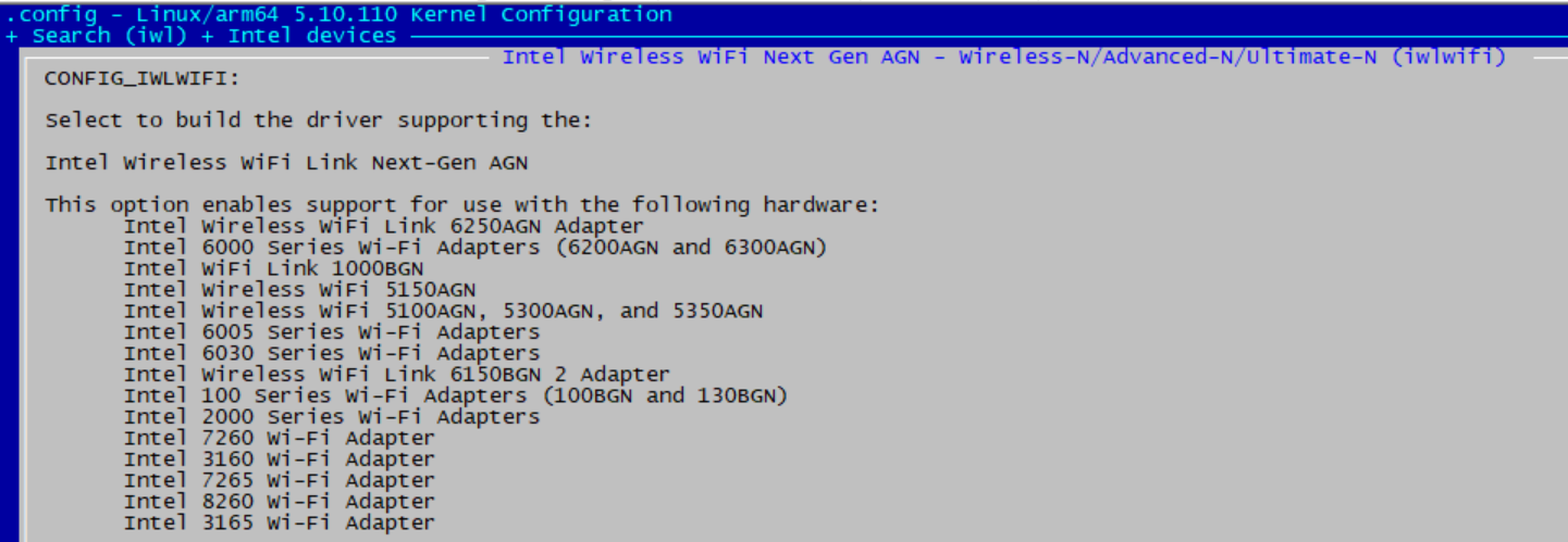

                              wuming last edited by
                              安装了AX210wifi网卡,怎么配置内核驱动,请给一个详细的教程
                                wuming @大法师 last edited by
                                安装了AX210wifi网卡,怎么配置内核驱动,请给一个详细的教程,而且文件iwlwifi-ty-59.601f3a66.0.tgz链接打不开
                                  george @wuming last edited by
                                  @wuming 驱动默认已经集成。只需要拷贝BIN文件进去。晚点发链接出来,先帮忙上传一下dmesg

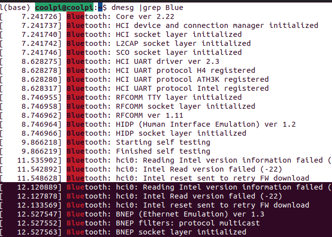

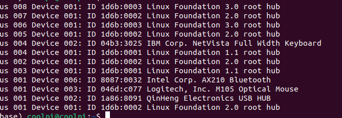

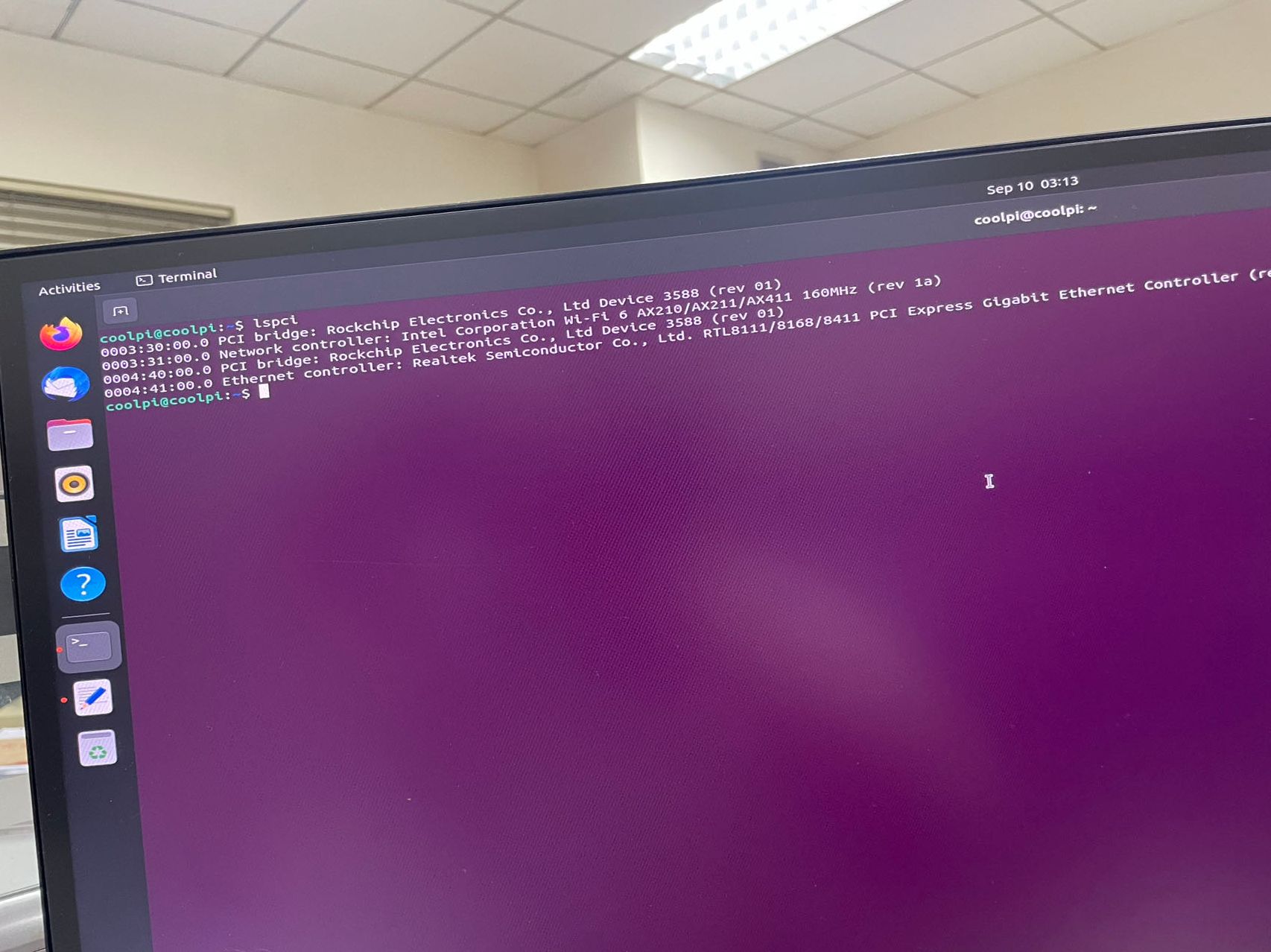

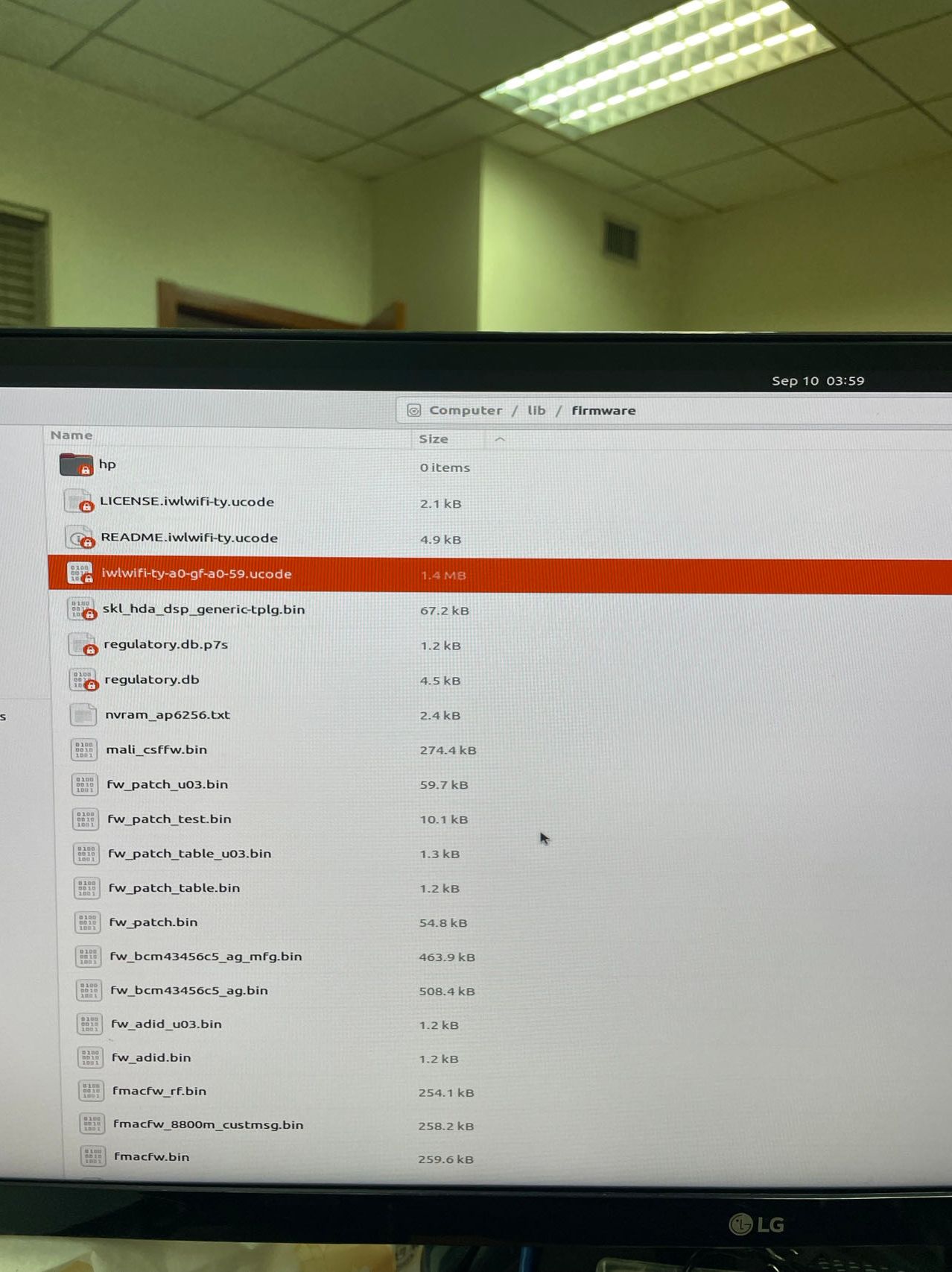

                                          三个*.ucode文件已经拷贝到/lib/firmware文件夹中,重启系统还是没有反应,看不到wifi的相关信息。
                                            jack_admin @wuming last edited by
                                            @wuming dmesg输出传一份
                                              wuming @jack_admin last edited by
                                              @jack_admin :我这么把dmesg命令生成的文件传给你。
                                                @wuming 直接上传附件就好了
                                                W 3 Replies Last reply Reply Quote 0
                                                  wuming @george last edited by
                                                  @george message.txt

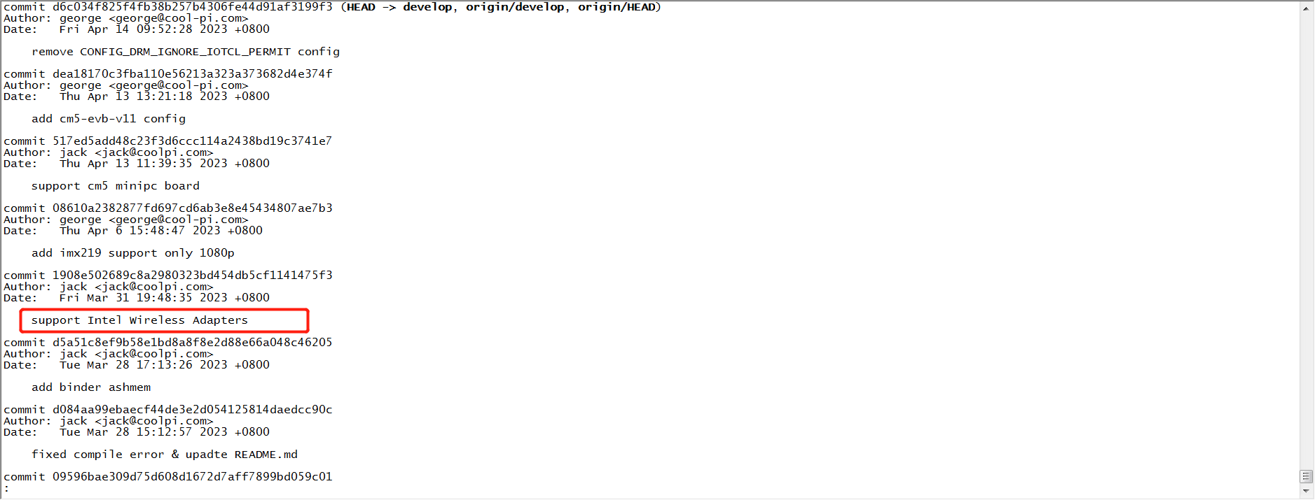

                                                        @wuming dmesg |grep iwl
                                                          @wuming 你的内核版本不对!内核请更新到最新,使用cm5-evb-v11的配置编译
                                                          W 2 Replies Last reply Reply Quote 0

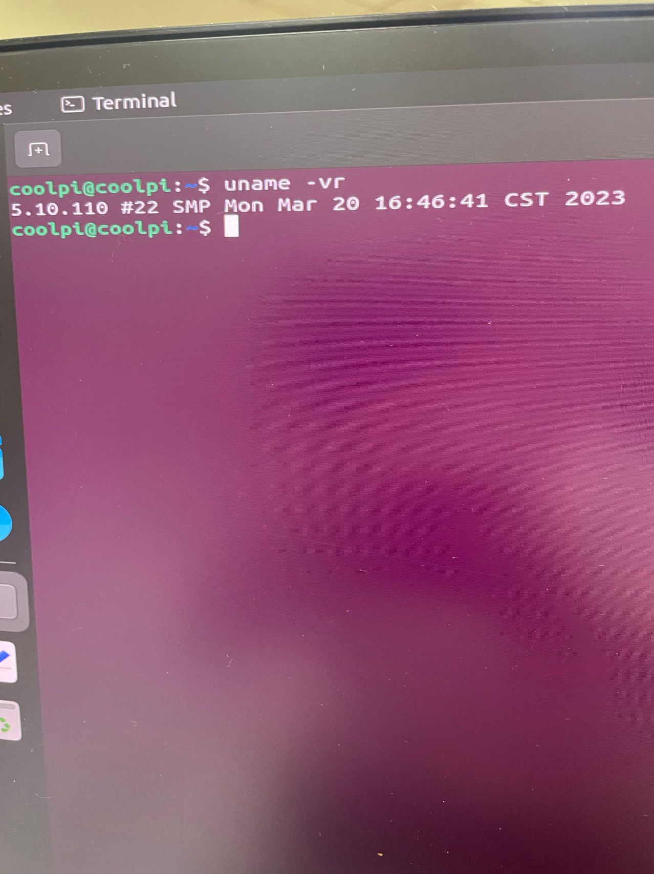

                                                              @george 我的这个版本不行吗?
