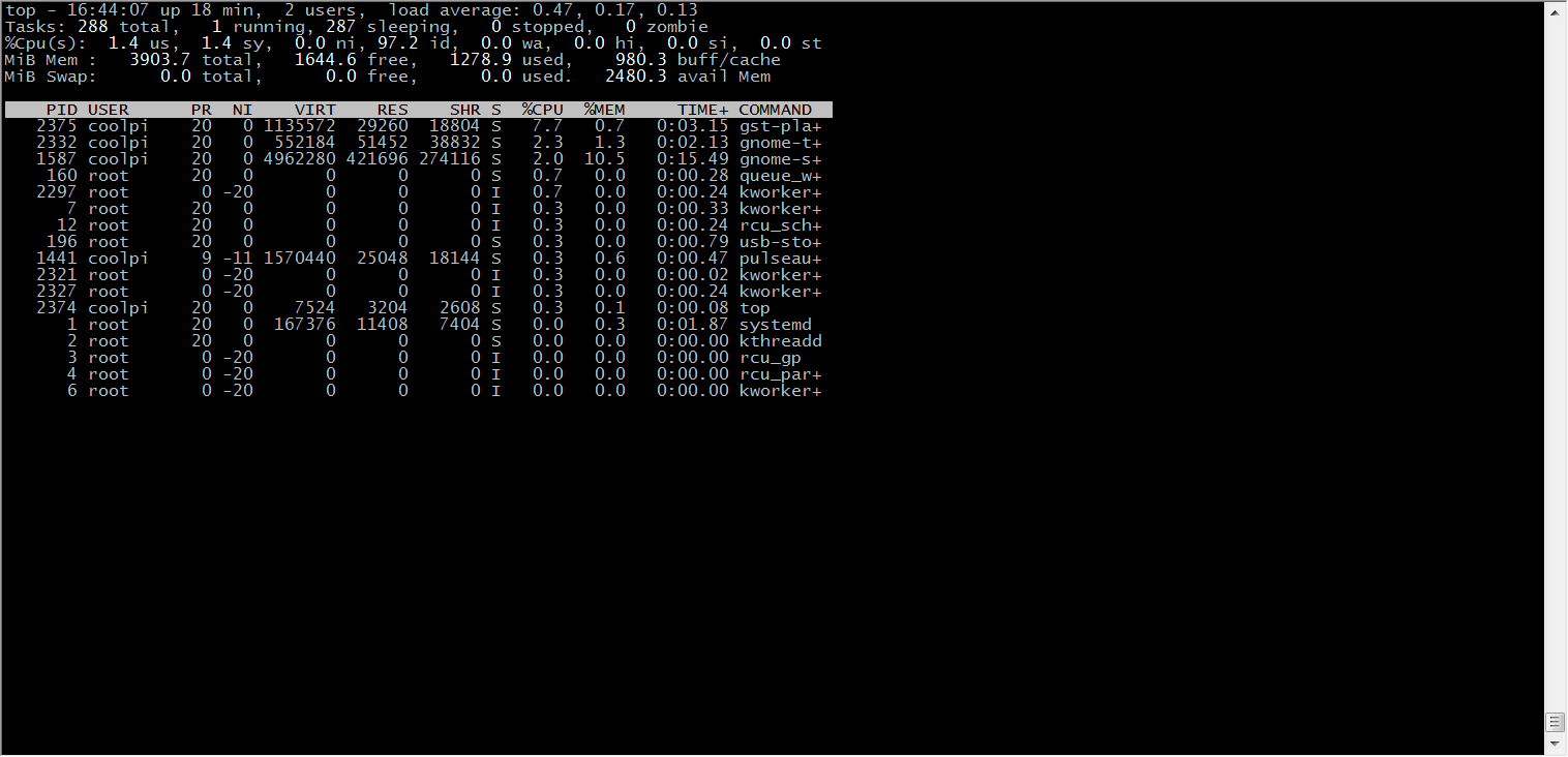

      • With kmssink, the CPU utilization of 4K video playback is reduced to about 10%.The disadvantage is that it occupies one layer.

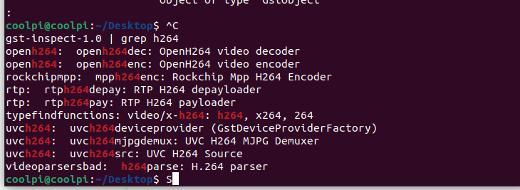

            gstramer的硬件解码插件叫什么 只有openh264dec ?
