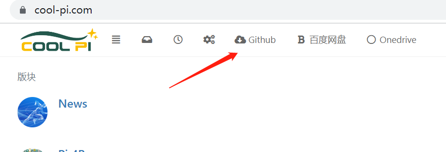

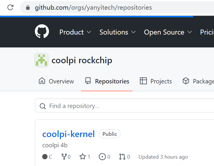

          大法师 last edited by
          C 1 Reply Last reply Reply Quote 0
