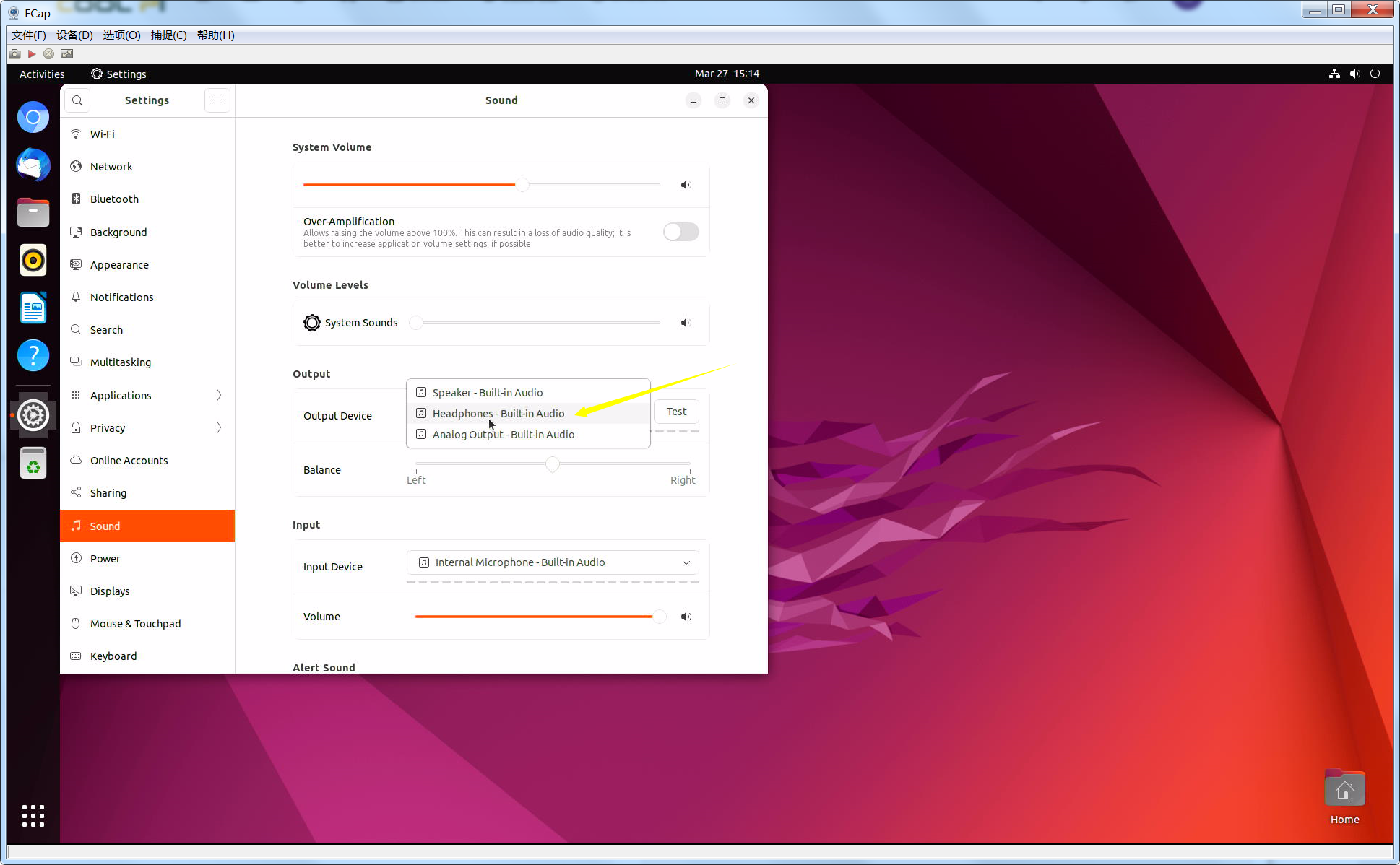

                george @xingzhan2012 last edited by
                @xingzhan2012 声卡选到耳机输出
                X 1 Reply Last reply Reply Quote 0
                • X
                  xingzhan2012 @george last edited by
                  原因找到了,是configuration 那里要设置选择HFP
