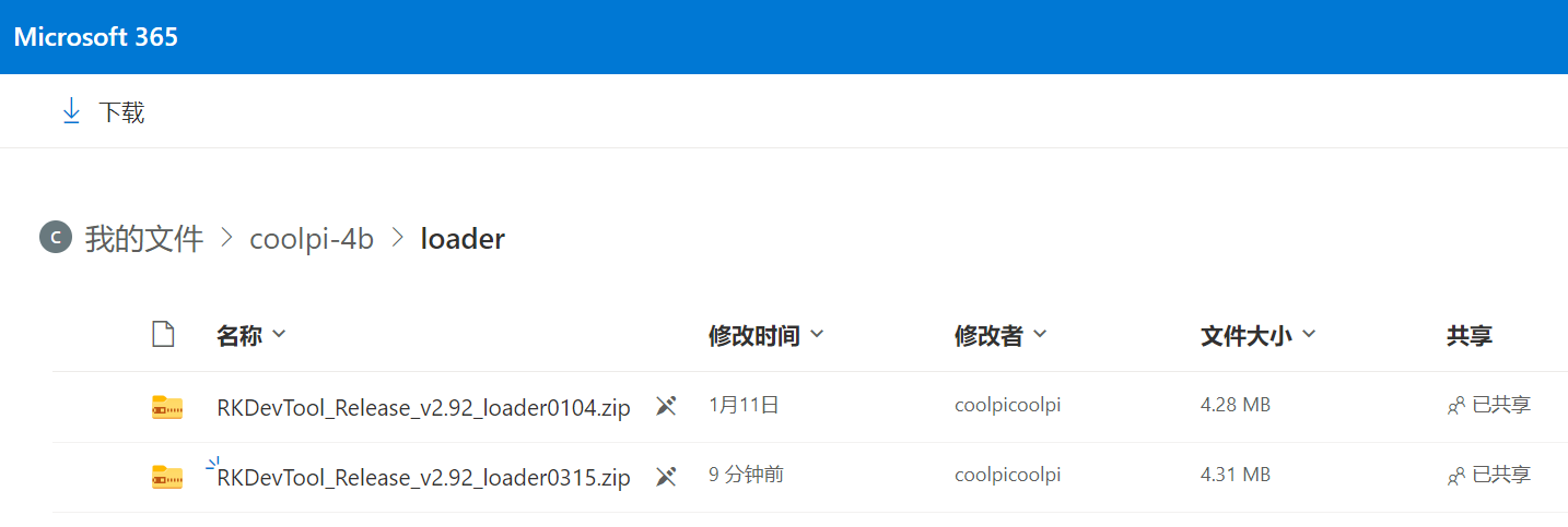

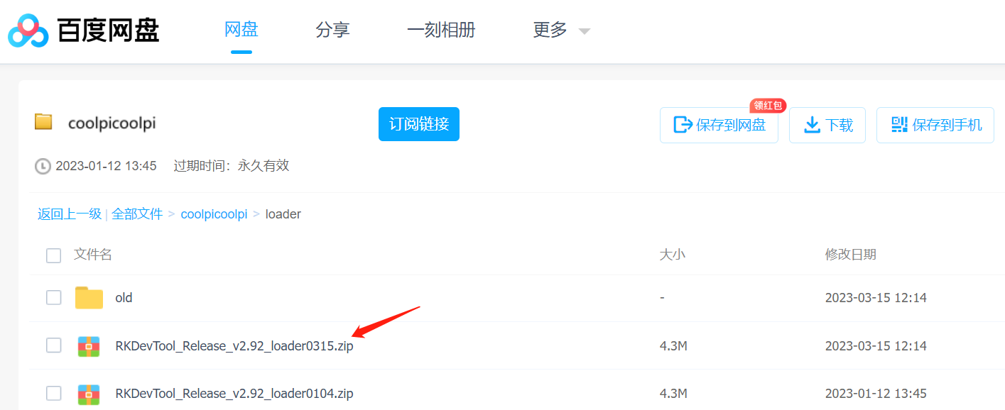

      This topic is specifically designed to describe cool pi 4b loader version updates.
      Source code repo:
      https://github.com/yanyitech/coolpi-loader.git
      Onedrive
      百度网盘
        tonyone0902 @大法师 last edited by
        @大法师 請問這版bootloader差異是?
          1. Update to support two USB3 interface USB hard drive boot support.
          2. Update fixes an abnormal offline flash startup problem.
          3. Increase support press power key to switch to maskrom function when system boot.

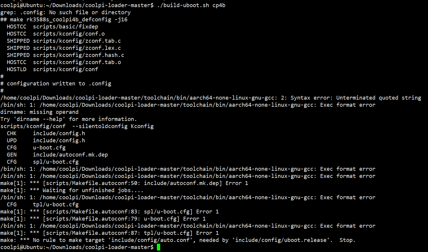

                          安装github上面的 uboot 安装
                          直接在4B的板子上编译的 不成功
                            @jugg loader编译请在x86主机linux环境操作
                              jack_admin @jugg last edited by jack_admin
                              @jugg 现在可以支持在coolpi机器上直接编译uboot。
                              https://www.cool-pi.com/topic/380/cool-pi-4b-cm5-linux-system-support-compile-u-boot/3
