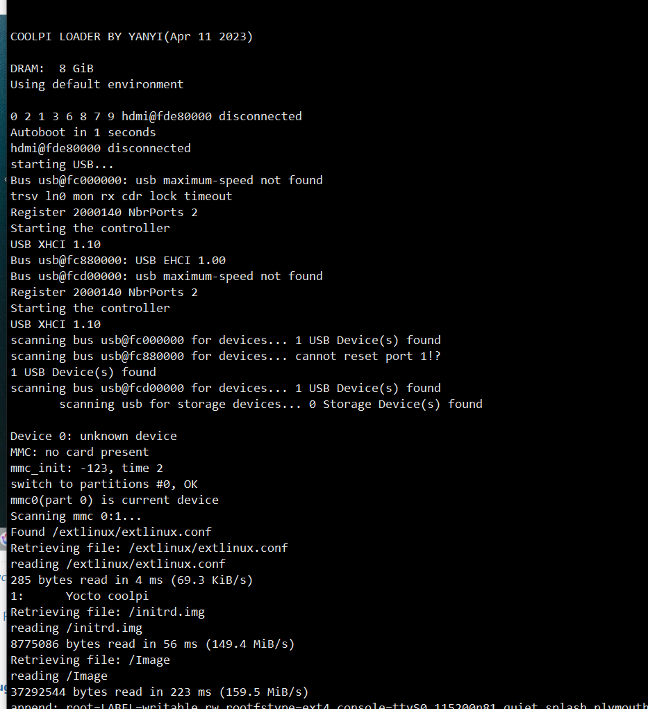

      好像也不是不能还原 只是还原出来的系统好像只还原了一半
      系统能进去 但是有些能操作 有些不能操作

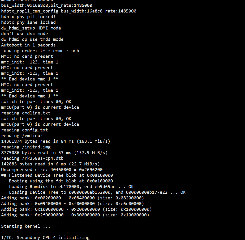

      COOLPI LOADER BY YANYI(Apr 11 2023)
      DRAM:  8 GiB
      Using default environment
      0 2 1 3 6 8 7 9 Monitor has basic audio support
      hdmi info isn't saved in main block
      mode:1920x1080 bus_format:0x100a
      hdmi@fde80000:  detailed mode clock 148500 kHz, flags[5]
          H: 1920 2008 2052 2200
          V: 1080 1084 1089 1125
      bus_format: 100a
      VOP update mode to: 1920x1080p0, type: HDMI0 for VP0
      dclk:148500,if_pixclk_div;2,if_dclk_div:4
      rockchip_vop2_init: hdmi1_phy_pll may not define
      hdptx_ropll_cmn_config bus_width:16a8c8 rate:1485000
      hdptx phy pll locked!
      VP0 set crtc_clock to 1485KHz
      VOP VP0 enable Esmart0[356x124->356x124@782x478] fmt[1] addr[0xedf21000]
      CEA mode used vic=16
      mtmdsclock:148500000
      bus_width:0x16a8c8,bit_rate:1485000
      hdptx phy lane locked!
      dw_hdmi_setup HDMI mode
      don't use dsc mode
      dw hdmi qp use tmds mode
      Autoboot in 1 seconds
      starting USB...
      Bus usb@fc000000: usb maximum-speed not found
      Register 2000140 NbrPorts 2
      Starting the controller
      USB XHCI 1.10
      Bus usb@fcd00000: usb maximum-speed not found
      USB XHCI 1.10
      scanning bus usb@fc000000 for devices... 1 USB Device(s) found
      scanning bus usb@fcd00000 for devices... 1 USB Device(s) found
             scanning usb for storage devices... 0 Storage Device(s) found
      Device 0: unknown device
      MMC: no card present
      mmc_init: -123, time 2
      switch to partitions #0, OK
      mmc0(part 0) is current device
      Scanning mmc 0:1...
      Found /extlinux/extlinux.conf
      289 bytes read in 4 ms (70.3 KiB/s)
      1:	Linux coolpi
      Retrieving file: /initrd.img
      reading /initrd.img
      8775086 bytes read in 51 ms (164.1 MiB/s)
      Retrieving file: /Image
      reading /Image
      38031872 bytes read in 212 ms (171.1 MiB/s)
      append: root=LABEL=writable rw rootfstype=ext4 console=ttyS0,115200n81 quiet splash plymouth.ignore-serial-consoles vt.global_cursor_default=1 irqchip.gicv3_pseudo_nmi=0 net.ifnames=0 rtleth=ethaddr:7a:46:da:5f:3e:bd
      Retrieving file: /rk3588s-cp4-dsi.dtb
      reading /rk3588s-cp4-dsi.dtb
      142879 bytes read in 5 ms (27.3 MiB/s)
      ## Flattened Device Tree blob at 0x0a100000
         Loading Ramdisk to eb176000, end eb9d45ae ... OK
         Loading Device Tree to 00000000eb150000, end 00000000eb175e1e ... OK
      Adding bank: 0x100000000 - 0x200000000 (size: 0x100000000)
      Adding bank: 0x2f0000000 - 0x300000000 (size: 0x10000000)
      Starting kernel ...

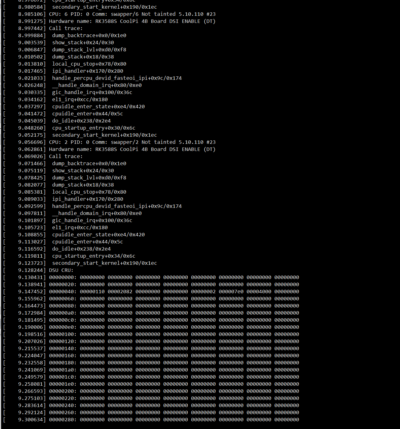

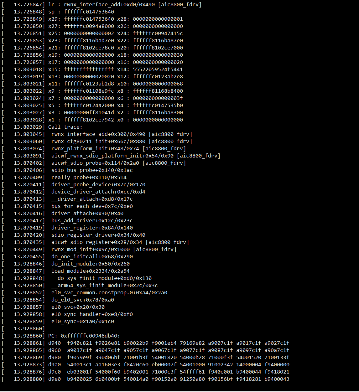

      [   17.042671] Unable to handle kernel NULL pointer dereference at virtual address 0000000000000000
      [   17.042672] Mem abort info:
      [   17.042673]   ESR = 0x96000045
      [   17.042675]   EC = 0x25: DABT (current EL), IL = 32 bits
      [   17.042675]   SET = 0, FnV = 0
      [   17.042676]   EA = 0, S1PTW = 0
      [   17.042677] Data abort info:
      [   17.042677]   ISV = 0, ISS = 0x00000045
      [   17.042678]   CM = 0, WnR = 1
      [   17.042679] user pgtable: 4k pages, 39-bit VAs, pgdp=00000001010b7000
      [   17.042681] [0000000000000000] pgd=0000000000000000, p4d=0000000000000000, pud=0000000000000000
      [   17.042685] Internal error: Oops: 96000045 [#1] SMP
      [   17.042686] Modules linked in: aic8800_fdrv(+) aic8800_bsp
      [   17.042691] CPU: 1 PID: 565 Comm: systemd-udevd Not tainted 5.10.110 #1
      [   17.042695] Hardware name: RK3588S CoolPi 4B Board DSI ENABLE (DT)
      [   17.042700] pstate: 60400009 (nZCv daif +PAN -UAO -TCO BTYPE=--)
      [   17.122628] pc : rwnx_interface_add+0x300/0x490 [aic8800_fdrv]
      [   17.122645] lr : rwnx_interface_add+0xd0/0x490 [aic8800_fdrv]
      [   17.122646] sp : ffffffc012f63640
      [   17.122646] x29: ffffffc012f63640 x28: 0000000000000001
      [   17.122648] x27: ffffffc0094a8000 x26: 0000000000000000
      [   17.122649] x25: 0000000000000002 x24: ffffffc00947415c
      [   17.122650] x23: ffffff81010157e0 x22: ffffff81010107e0
      [   17.122652] x21: ffffff81029338c0 x20: ffffff8102933000
      [   17.122653] x19: 0000000000000000 x18: 0000000000000030
      [   17.122654] x17: 0000000000000000 x16: 0000000000000000
      [   17.122656] x15: ffffffffffffffff x14: ffffffc092f632d7
      [   17.122657] x13: 0000000000020020 x12: ffffffc0123ab2e8
      [   17.122658] x11: ffffffc0123ab2d8 x10: 0000000000000068
      [   17.122659] x9 : ffffffc01108e9fc x8 : ffffff811728db00
      [   17.122661] x7 : 0000000000000000 x6 : 000000000000003f
      [   17.122665] x5 : ffffffc0124a2000 x4 : ffffffc012f635b0
      [   17.201087] x3 : 00000000ff81042b x2 : ffffff8101010300
      [   17.201088] x1 : ffffff8102933942 x0 : 0000000000000000
      [   17.201090] Call trace:
      [   17.201106]  rwnx_interface_add+0x300/0x490 [aic8800_fdrv]
      [   17.201123]  rwnx_cfg80211_init+0x66c/0x880 [aic8800_fdrv]
      [   17.230397]  rwnx_platform_init+0x48/0x74 [aic8800_fdrv]
      [   17.230411]  aicwf_rwnx_sdio_platform_init+0x54/0x90 [aic8800_fdrv]
      [   17.230426]  aicwf_sdio_probe+0x114/0x2a0 [aic8800_fdrv]
      [   17.230430]  sdio_bus_probe+0x140/0x1ac
      [   17.230433]  really_probe+0x110/0x514
      [   17.230434]  driver_probe_device+0x7c/0x170
      [   17.230436]  device_driver_attach+0xcc/0xd4
      [   17.230437]  __driver_attach+0xd8/0x17c
      [   17.230438]  bus_for_each_dev+0x7c/0xe0
      [   17.230442]  driver_attach+0x30/0x40
      [   17.274318]  bus_add_driver+0x12c/0x23c
      [   17.274320]  driver_register+0x84/0x140
      [   17.274321]  sdio_register_driver+0x34/0x40
      [   17.274335]  aicwf_sdio_register+0x28/0x34 [aic8800_fdrv]
      [   17.274350]  rwnx_mod_init+0x9c/0x1000 [aic8800_fdrv]
      [   17.274352]  do_one_initcall+0x68/0x290
      [   17.274355]  do_init_module+0x50/0x260
      [   17.274356]  load_module+0x2334/0x2a54
      [   17.274357]  __do_sys_finit_module+0xd0/0x130
      [   17.274359]  __arm64_sys_finit_module+0x2c/0x3c
      [   17.274361]  el0_svc_common.constprop.0+0xa4/0x2a0
      [   17.274362]  do_el0_svc+0x78/0xa0
      [   17.274365]  el0_svc+0x20/0x30
      [   17.274366]  el0_sync_handler+0xe8/0xf0
      [   17.274367]  el0_sync+0x1a0/0x1c0
      [   17.274368]
      [   17.274368] PC: 0xffffffc00946db40:
      [   17.274369] d940  f940c821 f9026e81 b90022b9 f9001eb4 79169e82 a9007c1f a9017c1f a9027c1f
      [   17.274373] d960  a9037c1f a9047c1f a9057c1f a9067c1f a9077c1f a9087c1f a9097c1f a90a7c1f
      [   17.274377] d980  f9059e9f 390d06bf 71001b3f 54001820 54000b28 71000f3f 54001520 7100133f
      [   17.274381] d9a0  540013c1 aa1603e3 f8420c60 eb00007f 54001000 91002342 14000004 f9400000
      [   17.364462] d9c0  eb03001f 54000f60 b9402001 71000c3f 54ffff61 f940e001 b9400044 f9418021
      [   17.364465] d9e0  b9400025 6b0400bf 540014a0 f90152a0 91250a80 f90156bf f9418281 b9400043
      [   17.364469] da00  b9000023 79400843 79000823 b9400041 b9000001 b945a360 79400841 79128e81
      [   17.364472] da20  37080ac0 b4000bfa b9400740 7100001f 1a9f07e0 390a42a0 b9400741 f9417a80
      [   17.364476] da40  7100003f 1a9f07e1 3901a001 aa1403e0 95f0b3f8 35000ae0 d5384101 b9401020
      [   17.364480] da60  11080000 b9001020 d2800002 913492c0 52800023 f9800011 885ffc01 4a020024
      [   17.364483] da80  35000064 88047c03 35ffff84 35001101 f94016c1 f90016d5 910082c0 f9046280
      [   17.364487] daa0  f9046681 52800000 f9000035 913492c1 089ffc20 f0047ea1 92800000 aa1803fe
      [   17.364490] dac0  d50320ff f9440821 9ac12000 b6b80b3e aa0003c0 52804001 95b0cb87 397342e1
      [   17.364494] dae0  d2800020 9ad32013 0a330033 393342f3 17ffff77 7100233f 54000b60 7100273f
      [   17.364497] db00  54000601 912de280 912da281 f905b681 52800022 f905ba81 a9007c1f a9017c1f
      [   17.364501] db20  a9027c1f a9037c1f f905de9f 390d06a2 f9400ec2 91250a81 f9418280 b9400043
      [   17.364505] db40* b9000003 79400842 79000802 f9418282 39401440 4a000260 39001440 f9418280
      [   17.364509] db60  b9400002 b9000022 79400800 79128e80 b945a360 360ff580 39421ea6 f0000180
      [   17.364512] db80  39421aa5 912f2000 394216a4 394212a3 39420ea2 39420aa1 95fe305b b5fff47a
      [   17.486880] dba0  390a42bf aa1403e0 95f0b3a2 34fff560 aa1403e0 d2800015 95f082b6 17ffff44
      [   17.486883] dbc0  71001f3f 54fffb61 912f4282 f905ea82 912de280 912f8283 f905ee82 b20003e4
      [   17.486887] dbe0  f905f283 912da282 f905f683 390cc2bf b90336bf f905b682 f905ba82 f905fe84
      [   17.486891] dc00  a9007c1f a9017c1f a9027c1f a9037c1f f905de9f 17ffffc7 71000b3f 54fff8a1
      [   17.486895] dc20  f90152bf f90156bf 390ac2bf 17ffffc1 9240d800 8a2003c0 17ffffa7 912de280
      [   17.486898] dc40  912da281 f905b681 f905ba81 a9007c1f a9017c1f a9027c1f a9037c1f f905de9f
      [   17.486902] dc60  17ffffb4 52800020 f90152bf f90156bf 390ac2bf 390d06a0 17ffffae 79400824
      [   17.486906] dc80  79400841 6b01009f 54ffeb21 17ffff4c f00000c0 910b0000 910b0000 52806461
      [   17.486909] dca0  f900fa80 79047a81 17ffffa2 95b273c1 17ffff78 2a1903e2 f0000180 52800143
      [   17.486913] dcc0  912e4000 95fe3010 17fffef1 d503201f d503245f aa1e03e9 d503201f d503233f
      [   17.486916] dce0  a9bc7bfd 910003fd a90153f3 aa0003f3 a9025bf5 b4000ec0 91138016 7100287f
      [   17.486920] dd00  54000180 12001c42 aa1603e0 97fffecd 91006014 b4000ce0 aa1403e0 a94153f3
      [   17.486924] dd20  a9425bf5 a8c47bfd d50323bf d65f03c0 aa0103f5 f0000180 2a0303e1 aa1503e2
      [   17.486927]
      [   17.486927] LR: 0xffffffc00946d910:
      [   17.486928] d710  95feefdc d503245f aa1e03e9 d503201f b4000620 d503233f a9bb7bfd 910003fd
      [   17.486931] d730  a90153f3 f00001d4 aa0103f3 a9025bf5 91138015 b945a280 a90363f7 12003c57
      [   17.614247] d750  91230038 371005c0 37080480 b94b4a60 f00001d4 91168294 7100081f 540001e1
      [   17.614251] d770  f00000c0 910b0000 9116c016 f0000180 f90023f9 912d4019 b9400280 37000500
      [   17.614254] d790  52800c80 95b373d3 b94b4a60 7100081f 54ffff40 f94023f9 b94b4a60 71000c1f
      [   17.614258] d7b0  54000061 52800020 b90b4a60 2a1703e2 aa1803e1 aa1503e0 97ffc8f2 a94153f3
      [   17.614262] d7d0  a9425bf5 a94363f7 a8c57bfd d50323bf d65f03c0 d4210000 394a3302 f00000c1
      [   17.614265] d7f0  910b0021 2a1703e3 9116c021 f0000180 912c4000 95fe3140 17ffffd5 f00000c1
      [   17.614269] d810  910b0021 9116c021 f0000180 91268000 95fe3139 b945a280 17ffffcc aa1603e1
      [   17.614272] d830  aa1903e0 95fe3134 17ffffd6 d503201f aa1e03e9 d503201f d503233f a9ba7bfd
      [   17.614276] d850  910003fd f9002bfb f00001db a90153f3 aa0103f4 b945a365 a9025bf5 aa0003f6
      [   17.614279] d870  12001c55 a90363f7 aa1e03f8 a9046bf9 2a0303f9 aa0403fa 37082165 914016d7
      [   17.614283] d890  7100133f 52800080 1a9f0013 528001c5 1a8000a5 397342e6 9ad324c0 36000080
      [   17.614287] d8b0  14000010 9ad324c2 370001c2 11000673 6b05027f 54ffff8b d2800015 aa1503e0
      [   17.614290] d8d0  a94153f3 a9425bf5 a94363f7 a9446bf9 f9402bfb a8c67bfd d50323bf d65f03c0
      [   17.614294] d8f0  aa1403e1 2a1503e2 f0ffffe3 52800025 912dd063 52800a24 52807000 95f083b5
      [   17.614297] d910* aa0003f4 b4fffda0 3930029f 91236281 f9017a81 91230295 912a2280 52801fe2
      [   17.614301] d930  f9400ec1 a90106b6 f900e2b4 390a32b3 f940c821 f9026e81 b90022b9 f9001eb4
      [   17.744824] d950  79169e82 a9007c1f a9017c1f a9027c1f a9037c1f a9047c1f a9057c1f a9067c1f
      [   17.744828] d970  a9077c1f a9087c1f a9097c1f a90a7c1f f9059e9f 390d06bf 71001b3f 54001820
      [   17.744832] d990  54000b28 71000f3f 54001520 7100133f 540013c1 aa1603e3 f8420c60 eb00007f
      [   17.744835] d9b0  54001000 91002342 14000004 f9400000 eb03001f 54000f60 b9402001 71000c3f
      [   17.744839] d9d0  54ffff61 f940e001 b9400044 f9418021 b9400025 6b0400bf 540014a0 f90152a0
      [   17.744842] d9f0  91250a80 f90156bf f9418281 b9400043 b9000023 79400843 79000823 b9400041
      [   17.744846] da10  b9000001 b945a360 79400841 79128e81 37080ac0 b4000bfa b9400740 7100001f
      [   17.744849] da30  1a9f07e0 390a42a0 b9400741 f9417a80 7100003f 1a9f07e1 3901a001 aa1403e0
      [   17.744853] da50  95f0b3f8 35000ae0 d5384101 b9401020 11080000 b9001020 d2800002 913492c0
      [   17.744856] da70  52800023 f9800011 885ffc01 4a020024 35000064 88047c03 35ffff84 35001101
      [   17.744860] da90  f94016c1 f90016d5 910082c0 f9046280 f9046681 52800000 f9000035 913492c1

        @jugg said in Cool pi 4B & CM5 探索快速安装系统新方法:
        DRAM:  8 GiB
        bus_format: 100a
        don't use dsc mode
        starting USB...
        USB XHCI 1.10
        USB XHCI 1.10
        Scanning mmc 0:1...
        1:	Linux coolpi
        reading /initrd.img
        reading /Image
        Starting kernel ...

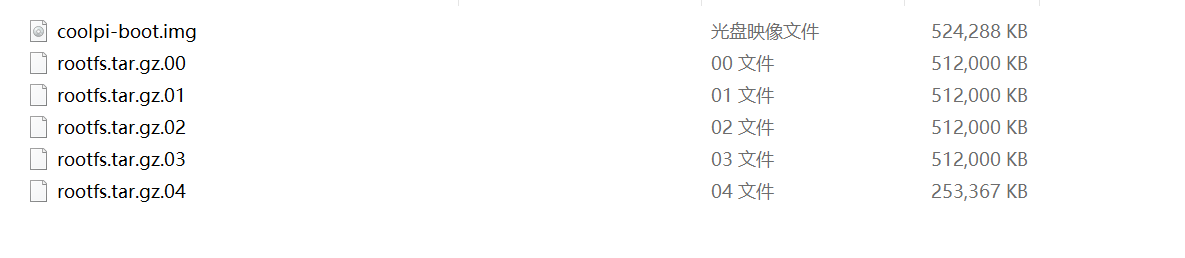

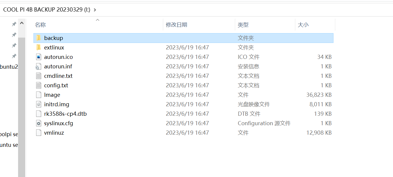

        有没有其它方法备份、还原的 手动的也行

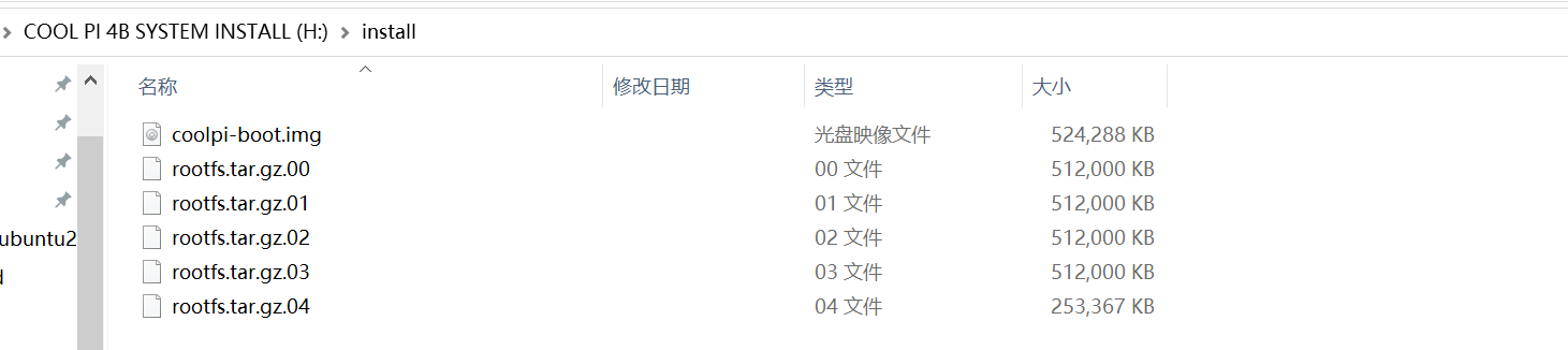

          @jugg 所以确认你的rootfs包是不是ok的。备份与安装过程,U盘是比较重要的,质量尽量选择好的
            我试过解压rootf 可以解压

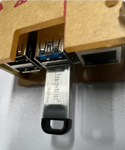

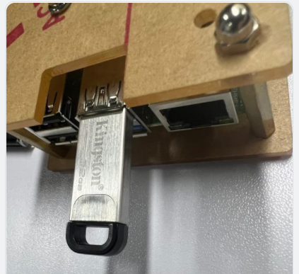

              而且我这里要接U3下面的口才能备份
              接上面的直接进系统
                @jugg 一个是接电脑刷loader,一个接U盘刷系统。
                  我的几块板都是只能接U3上才能备份
                  接U3下 直接进系统
                    jugg @jugg last edited by
                    我的几块板都是只能接U3上才能备份
                    接U3下 直接进系统
                    直接进系统
                    进入备份
                      有没有其它方法备份、还原
                      这根本还原不了 还原出来的也是残缺的系统
                        为什么我还原出来的系统上电开机就输出内核崩溃 系统能进去 但是什么软件都打不开
                          手动的方法 有没有
                            这么多板 我不能一台一台的去设置吧
                              @jugg 几个板环境确认下。接串口查看下上电loader信息
                                这些在前面的回答中都有

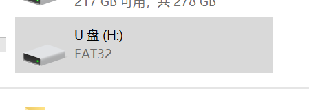

                                  明明已经识别到u盘了 但是就是不刷机 直接进系统
                                  而有些板子又能刷 这是不是可以申请换货
                                    大法师 @jugg last edited by 大法师
                                    @jugg 硬件没问题。或者用TF卡实现备份、还原安装。另一种方式,可以进入UMS模式,用USB线直接克隆还原
                                      UMS进不去
                                      卡在那个X那里 但是电脑上面识别不到
                                      其它板是可以进入UMS的

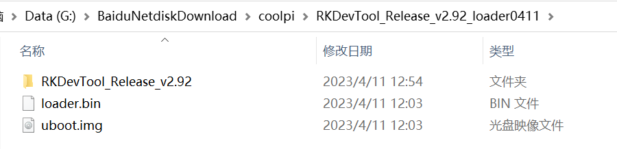

                                        @jugg 把loader擦除重新刷一次。
                                          用这个刷过了
                                            刷的这个
                                              到底怎么样才能还原系统
                                              没法自己进入还原系统啊
                                              用的金士顿的U盘
                                                是不是有什么特别的地方
                                                放两天板子的系统就进不去 又是怎么回事
                                                串口有问题 又是怎么回事
                                                  @jugg 没有什么特殊的。
                                                    是不是有什么特别的地方
                                                    放两天板子的系统就进不去 又是怎么回事
                                                    串口有问题 又是怎么回事
                                                    确认串口连接线是否松了或接对
                                                      到底怎么样才能还原系统
                                                      没法自己进入还原系统啊
                                                      用的金士顿的U盘
                                                      更新2023年发布的loader程序,更换u盘再验证

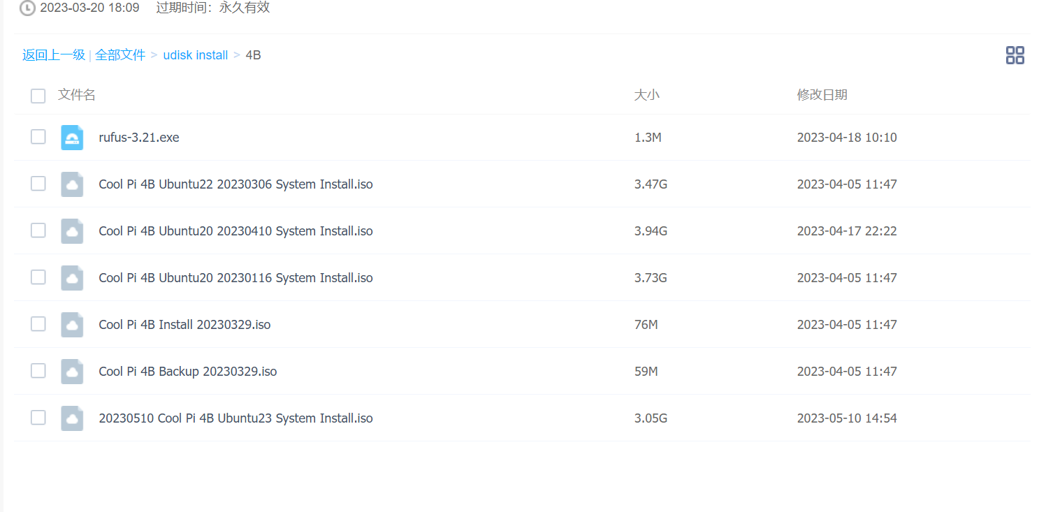

                                                        没找到下载备份镜像的地址呢?可以发一下吗?
                                                          你是要用U盘刷机吗?最近的镜像是IMG文件,只能使用USB接口连接电脑,通过etcher刷机。
