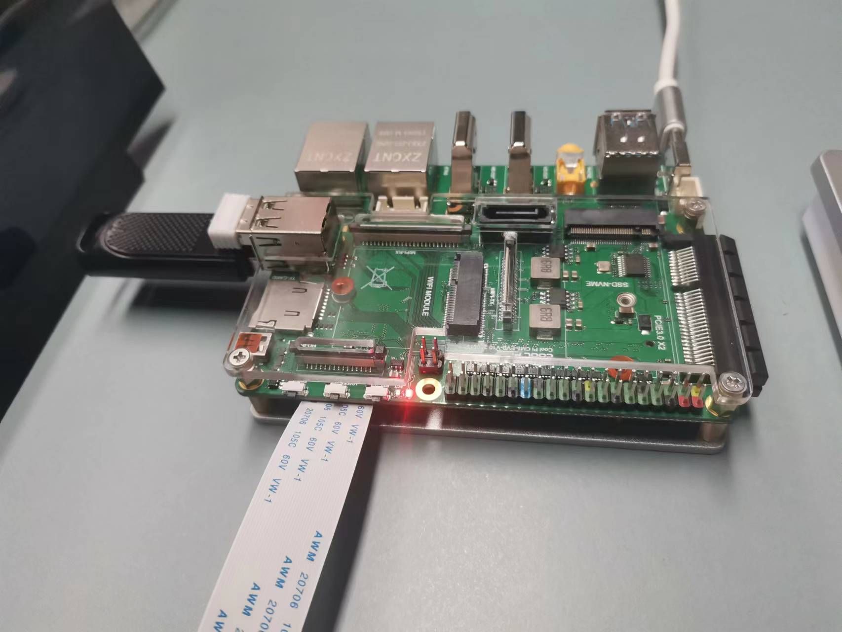

      The CM5-evb board has two native eDP interfaces, designed according to the standard 30PIN eDP interface, and can directly drive an eDP LCD without any conversion. Interface integrated backlight control circuit. LCD backlight brightness adjustment can be achieved.

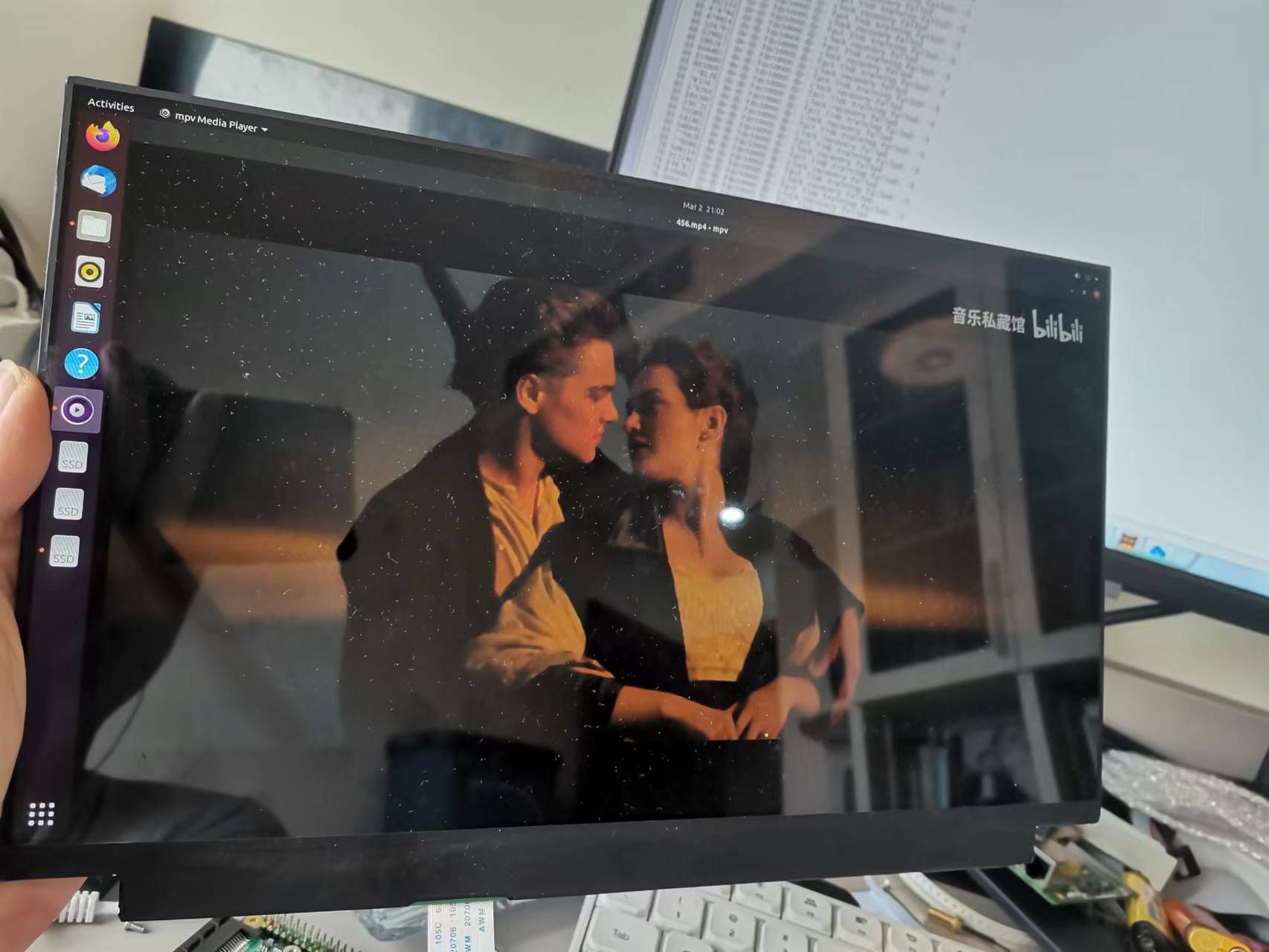

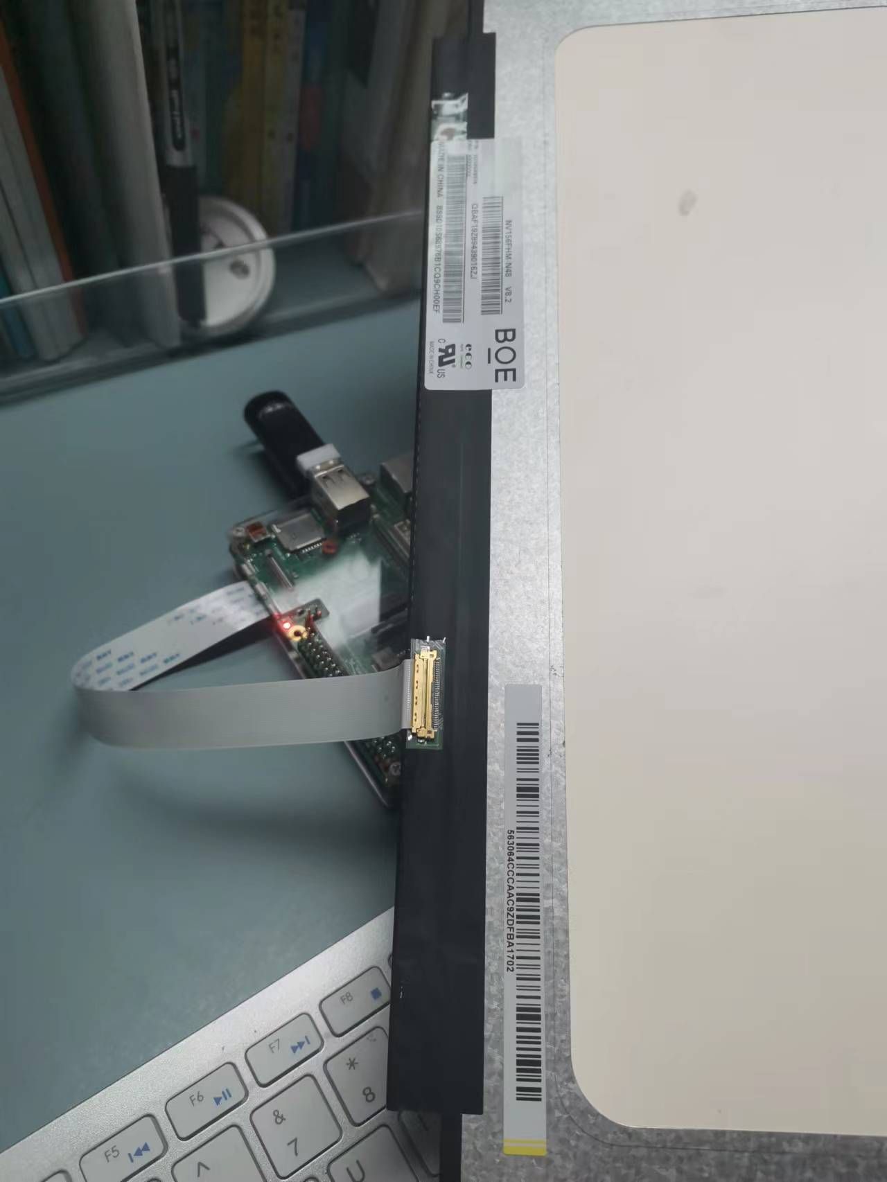

        是京东方的4K屏吗
          顾真牛 @顾真牛 last edited by
          查了下 NV156FHM-N48 1080p的 看样子不错
            george @顾真牛 last edited by
            @顾真牛 1080P的。
              顾真牛 @george last edited by
              @george 多少米呀 商城上一下?
                @顾真牛 正常标准30PIN EDP 接口的都可以用,这个是我笔记本拆下来的,不是买的。
                  @george 嘿嘿,信你个鬼,频幕上保护膜都没撕呢

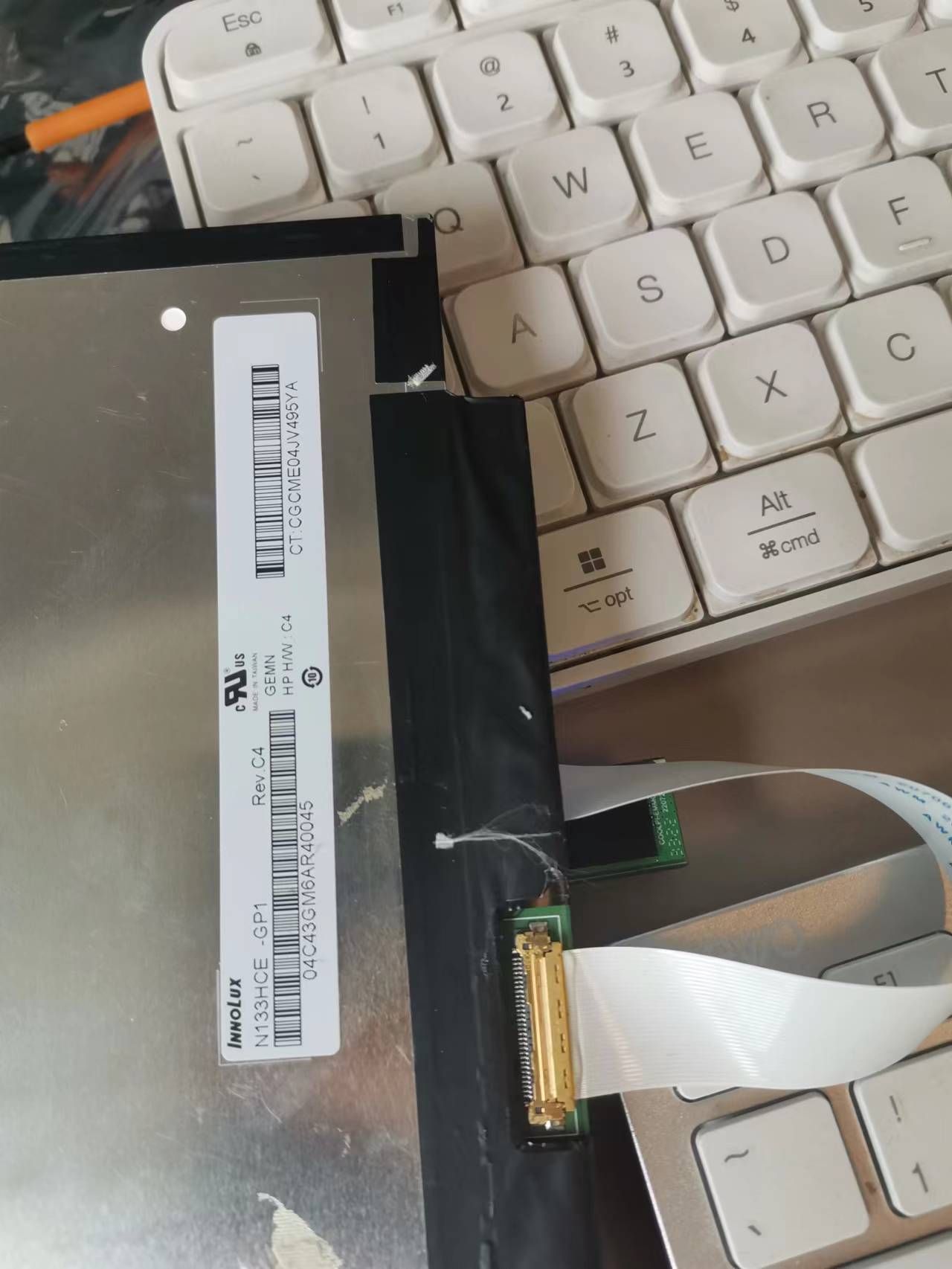

                    george @george last edited by
                    @george 再增加一款13.3寸 1080P N133HCE-GP1
