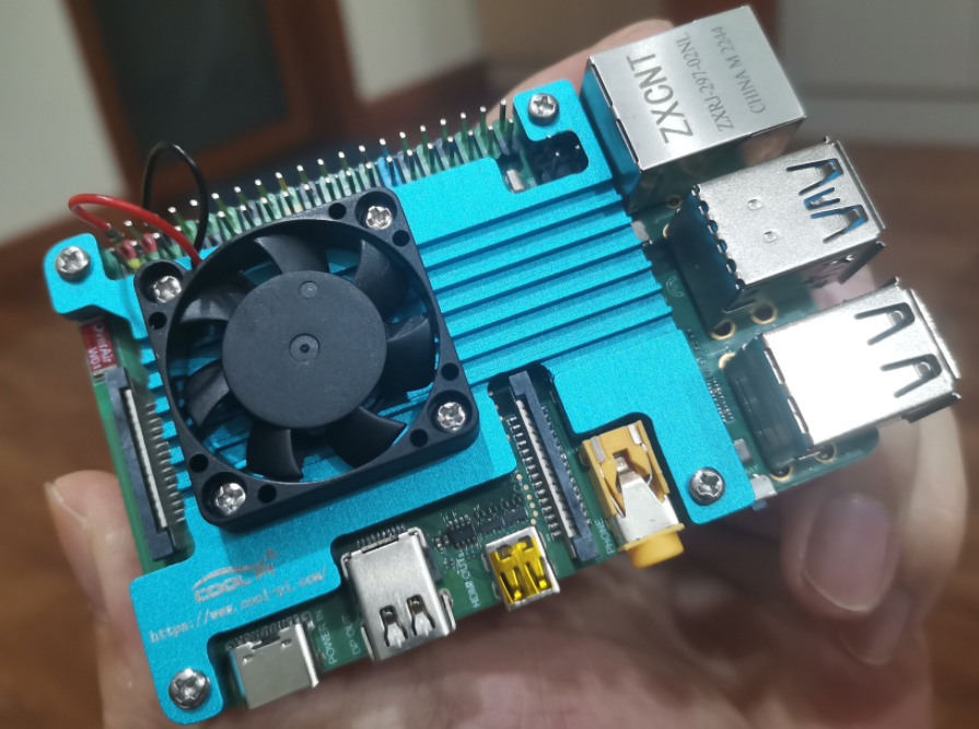

        @spartan50416 As shown in the figure below, the CP4 can have a separate fan heat sink, with EMMC, TF-card, and USB interfaces stored. The USB 3.0 interface can expand SSDs or mechanical hard disks. The machine has independent on-off buttons, which can be customized by modifying software, or external keyboards can be extended through the ADC interface. Firmware upgrades are the same as raspberry pi. You can use the balena Etcher tool to create a startup disk, and the startup media can be a TF card, a USB flash drive, or an EMMC.
