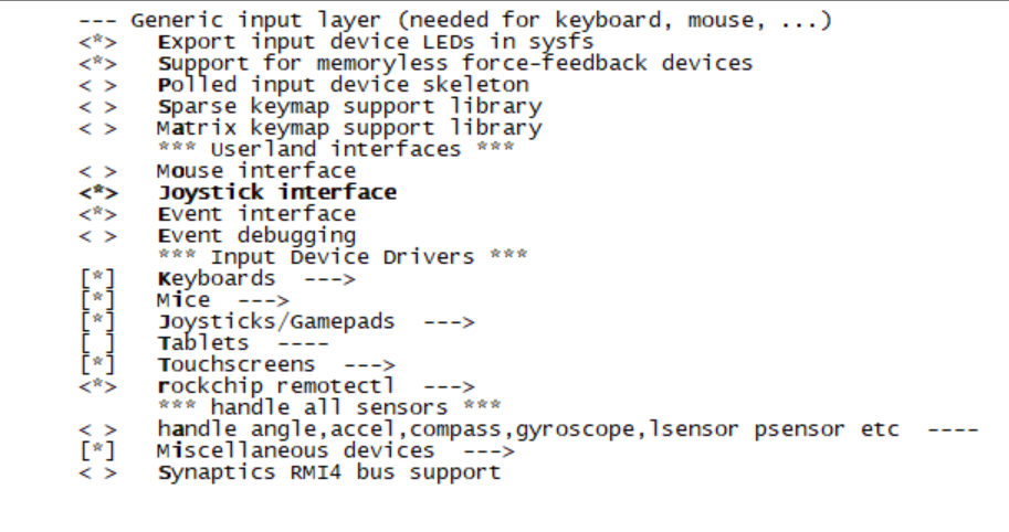

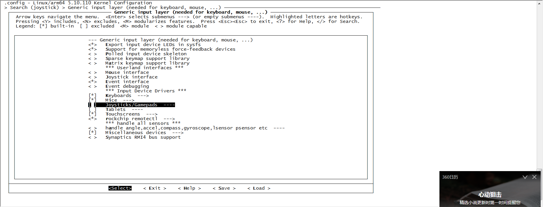

        george @AugustRobot_Zou last edited by
        @AugustRobot_Zou 如下图:
          顾真牛 @AugustRobot_Zou last edited by
          @AugustRobot_Zou 一个小技巧 在内核修改界面按 “/” 搜索
