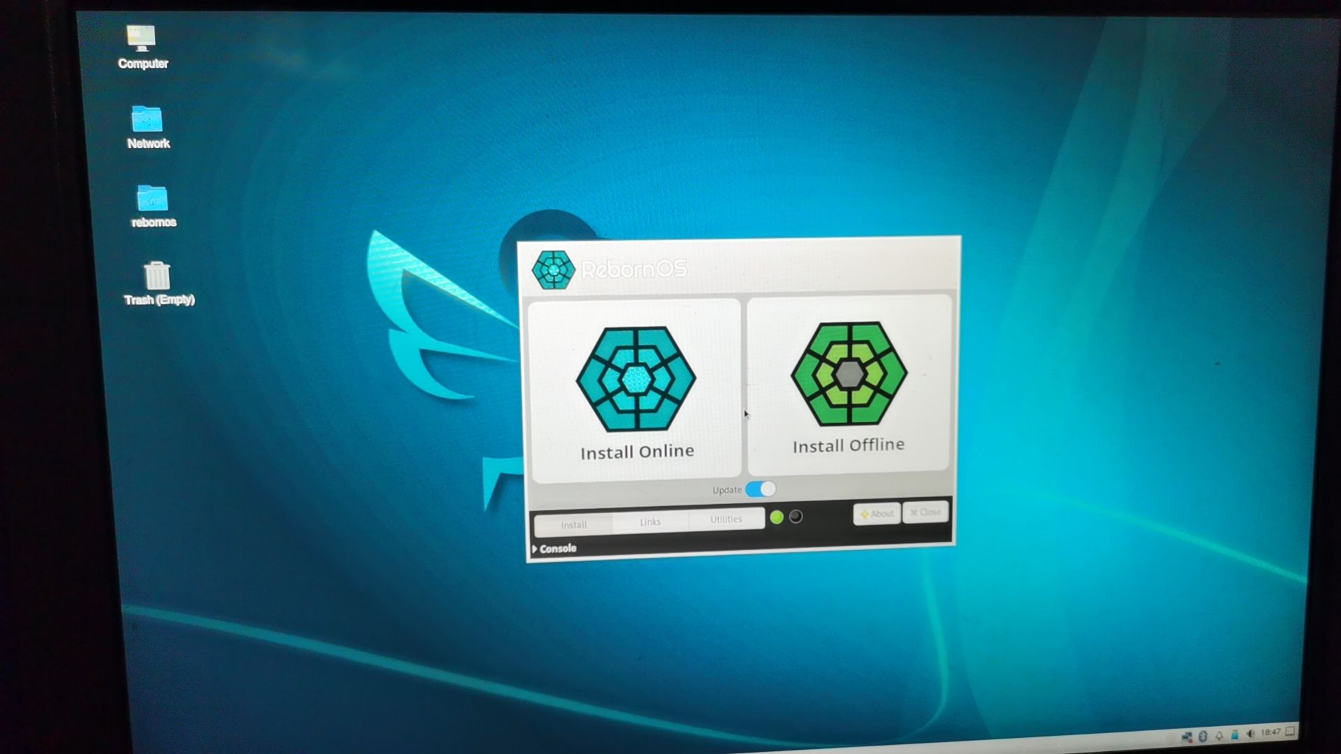

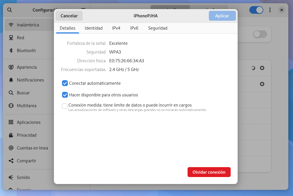

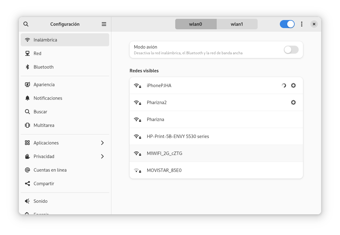

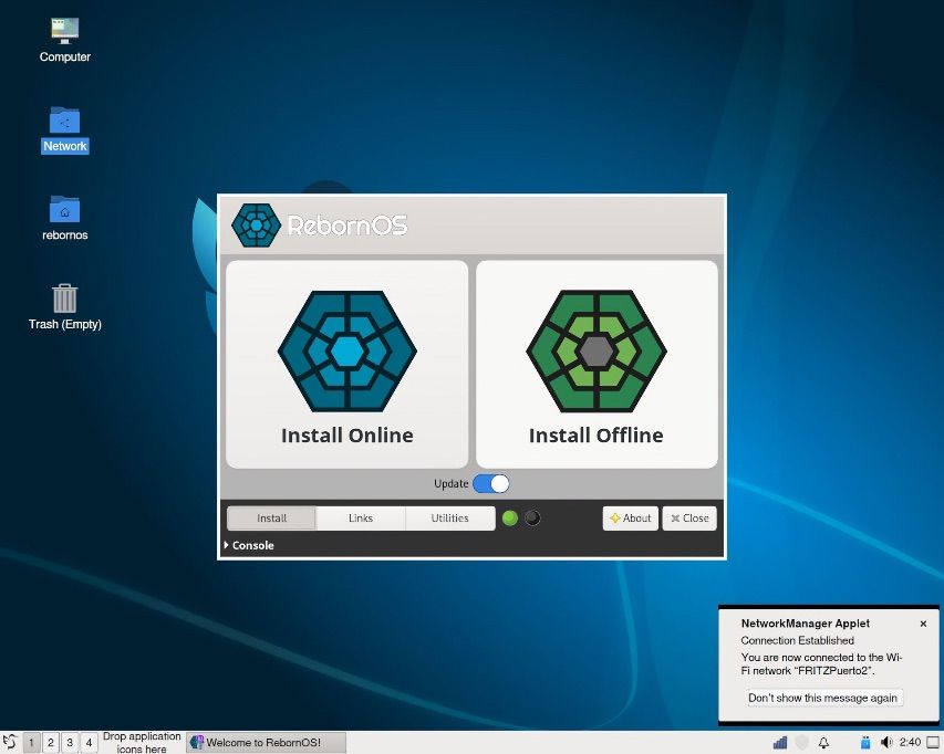

                      Now, I have my CoolPi working fine with RebornOS but... without wireless connection.
                      Wired connections works for Internet but when I tried to enable my wireless connection always ask for my password. CoolPi see without any problems all available wireless networks but it does not accept the password
                        jack_admin @Pharizna last edited by
                        @Pharizna
                        install online through ethernet and restart system.
                        P 1 Reply Last reply Reply Quote 0
                        • P
                          Pharizna @jack_admin last edited by
                          Thank you @jack_admin but the problem remains 😧
                          I format the eMMC and flashed the RebornOS with Balena. Then I installed online through the LAN (wired connection), reboot the device.
                          The problem remains and I can't connect to my LAN using Wireless. It doesn't accept my credentials that are using in my another devices, of course
                          I tried creating an access point in my iPhone with the same problem 😢

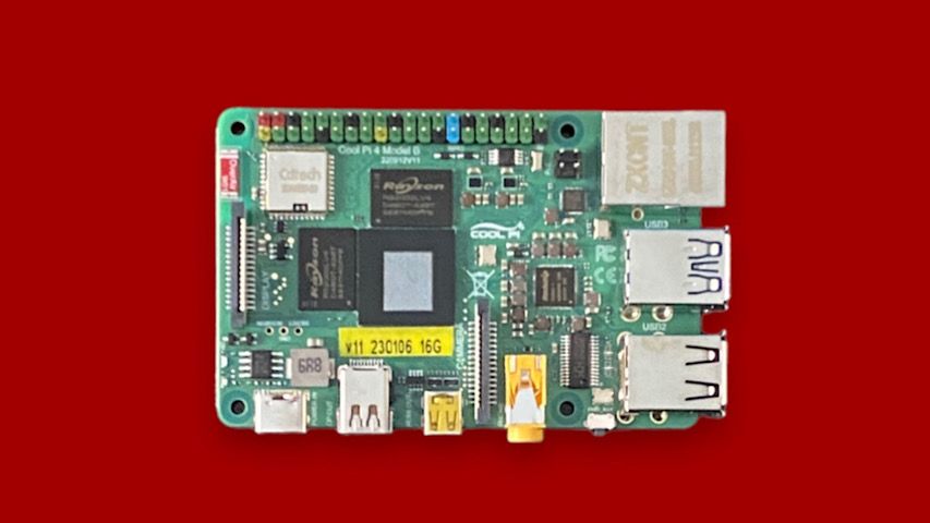

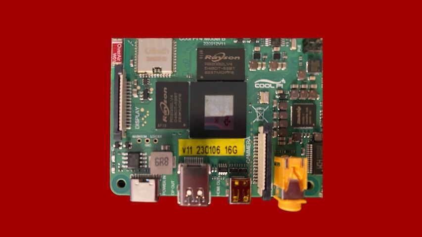

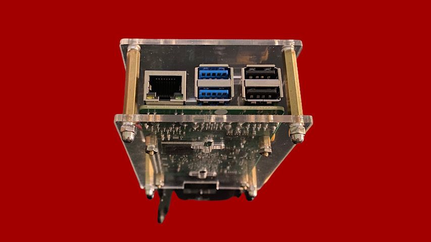

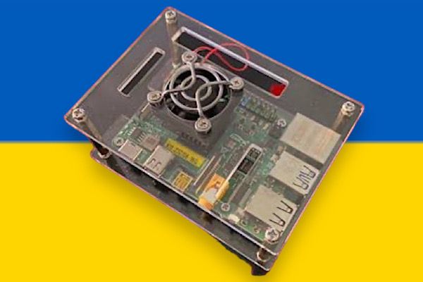

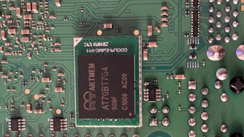

                              @Pharizna Please take a photo of the front of your machine.
                              • P
                                Pharizna @george last edited by
                                Of course @george
                                Here are some of the pictures of my next review of this device in my website www.pcdemano.com
                                IMG_5451.jpg )

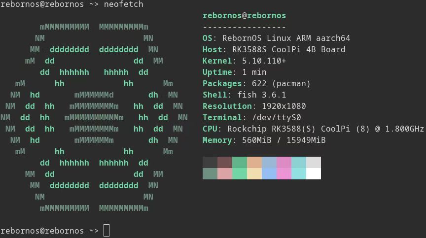

                                      Hello, RebornOS dev here
                                      I just want to address some things
                                      Known issues
                                      • No wifi
                                      • no bt
                                      • only boots from eMMC
                                      rippanda12 P 3 Replies Last reply Reply Quote 0
