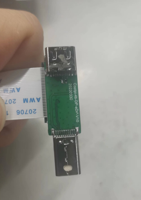

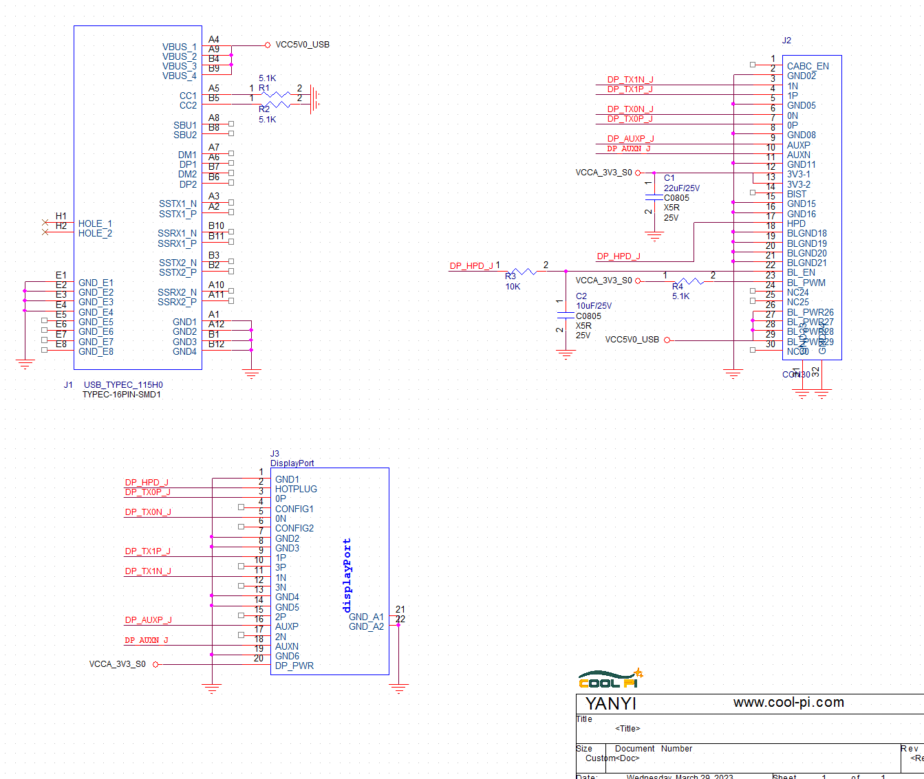

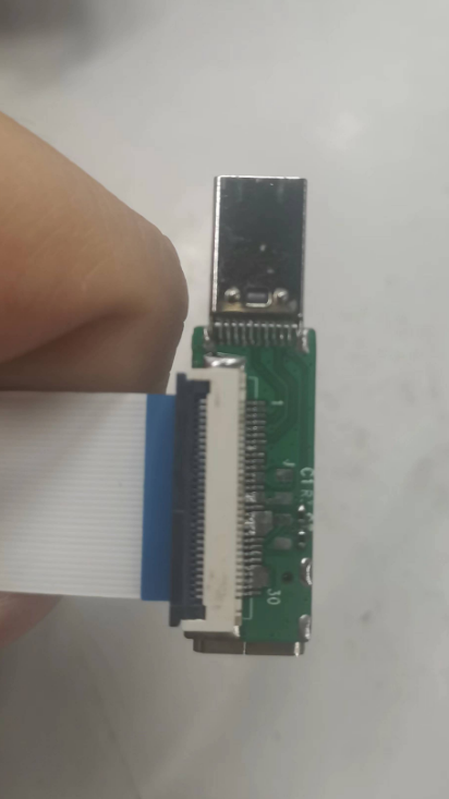

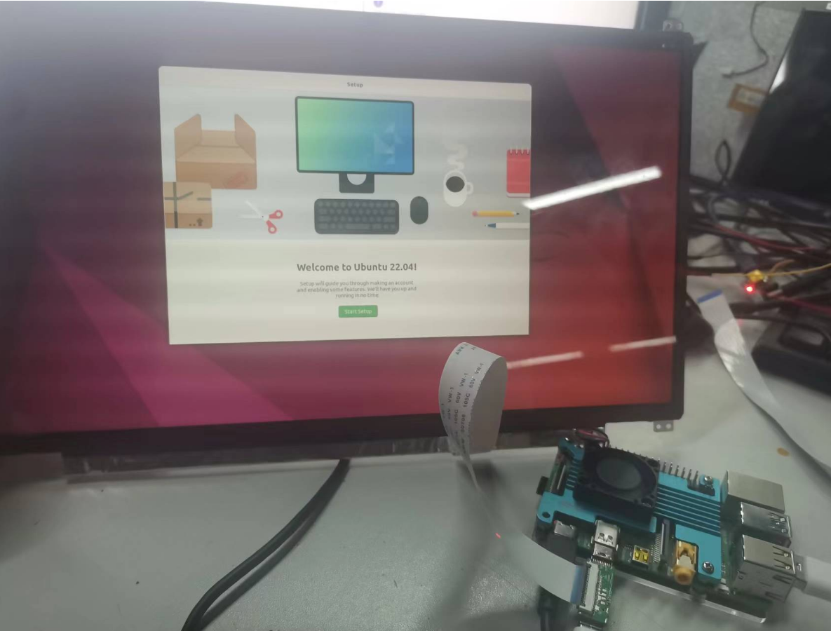

      Some users have been asking what kind of LCD can be compatible with the 4b machine. Due to compatibility with Raspberry Pi, the MIPI interface cannot support high resolution screens. However, the 4b machine has a DP interface, which can drive the eDP interface LCD with a simple transfer, and the software does not need to be modified. The actual debugging effect of the adapter board is as follows:
