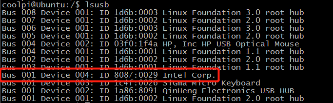

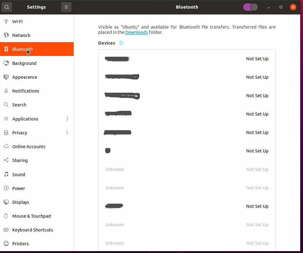

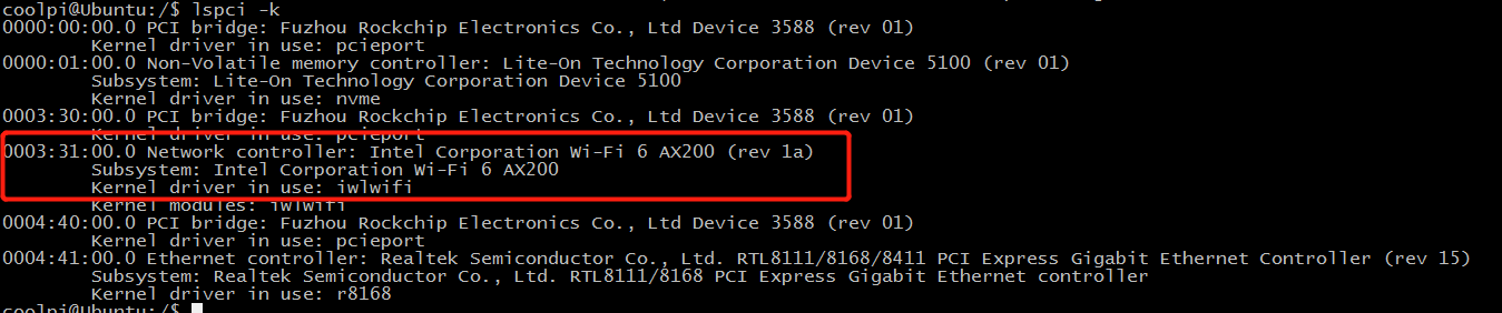

      • Confirm that the network card is properly recognized,Confirm Bluetooth recognition is normal.

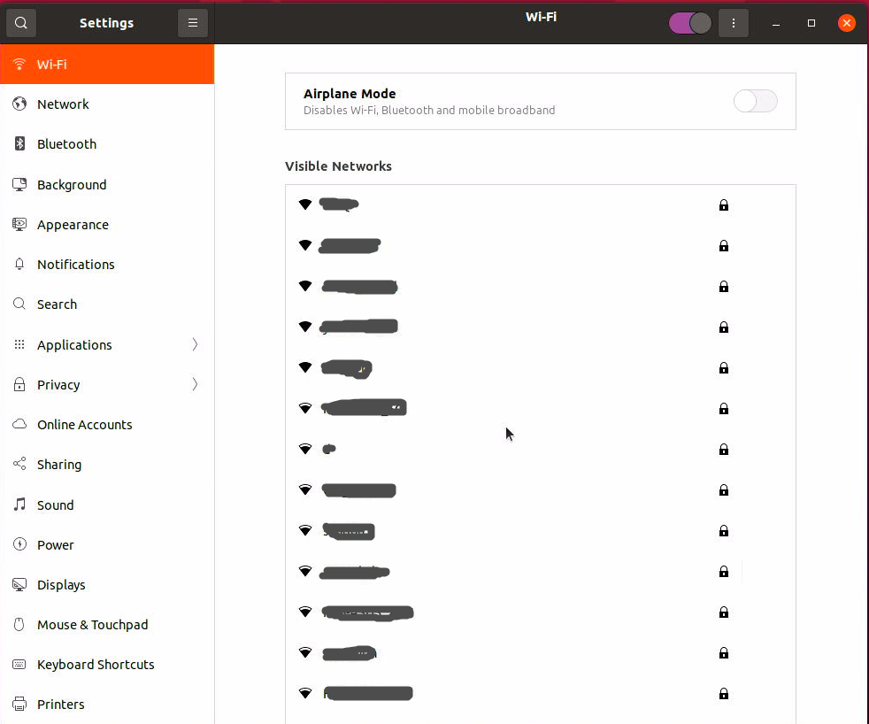

      • Actual measurement effect

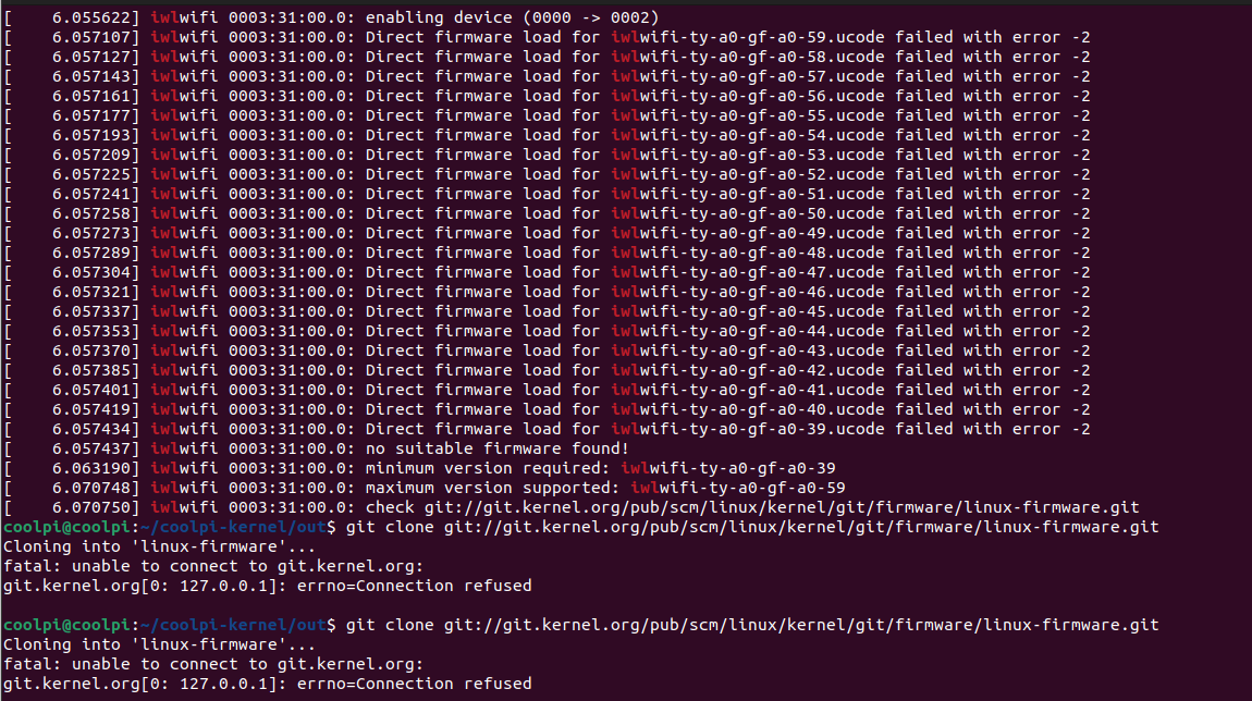

        wuming @george last edited by
          george @wuming last edited by
          @wuming 你的模组需要的固件是iwlwifi-ty-a0-gf-a0-59.ucode
          sudo cp ./linux-firmware/iwlwifi* /lib/firmware
            @george 我的网络不能git文件
