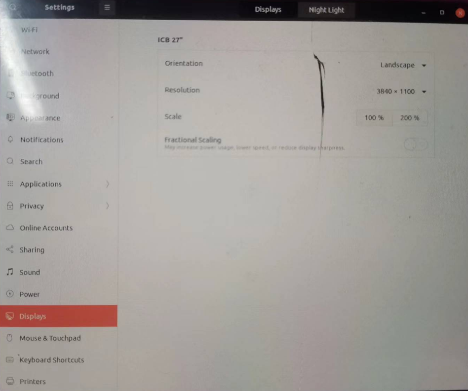

      Users may have various resolutions of displays on their hands, some of which are not included in the xf86EdidModes support list. In this case, the software needs to do some processing to support this type of display. The specific steps are as follows:
      • Obtaining device's edid information
      cat /sys/class/drm/card0-HDMI*/edid > /home/coolpi/share/edid.bin
      • Parsing EDID to obtain timings for various resolutions
      coolpi@Ubuntu:~/share$  sudo apt-get install read-edid edid-decode
      coolpi@Ubuntu:~/share$  parse-edid < edid.bin
      Checksum Correct
      Section "Monitor"
              Identifier "HDMI"
              ModelName "HDMI"
              VendorName "ICB"
              # Monitor Manufactured week 50 of 2017
              # EDID version 1.3
              # Digital Display
              DisplaySize 1200 340
              Gamma 2.20
              Option "DPMS" "true"
              Horizsync 30-180
              VertRefresh 48-120
              # Maximum pixel clock is 600MHz
              #Not giving standard mode: 1152x864, 75Hz
              #Not giving standard mode: 1280x800, 60Hz
              #Not giving standard mode: 1280x720, 60Hz
              #Not giving standard mode: 1280x1024, 60Hz
              #Not giving standard mode: 1440x900, 60Hz
              #Not giving standard mode: 1600x900, 60Hz
              #Not giving standard mode: 1680x1050, 60Hz
              #Extension block found. Parsing...
      #WARNING: I may have missed a mode (CEA mode 97)
      #DOUBLE WARNING: It's your first mode, too, so this may actually be important.
      #WARNING: I may have missed a mode (CEA mode 96)
      #WARNING: I may have missed a mode (CEA mode 90)
      #WARNING: I may have missed a mode (CEA mode 95)
              Modeline        "Mode 11" 297.00 1920 1968 2000 2200 2160 2163 2168 2250 +hsync +vsync
              Modeline        "Mode 0" 282.89 3840 3888 3920 4100 1100 1103 1108 1150 +hsync -vsync
              Modeline        "Mode 1" 540.00 3840 3888 3952 4000 1080 1083 1093 1125 +hsync -vsync
              Modeline        "Mode 2" 148.500 1920 2008 2052 2200 1080 1084 1089 1125 +hsync +vsync
              Modeline        "Mode 3" 74.250 1920 2008 2052 2200 1080 1082 1087 1125 +hsync +vsync interlace
              Modeline        "Mode 4" 74.250 1280 1390 1420 1650 720 725 730 750 +hsync +vsync
              Modeline        "Mode 5" 27.027 720 736 798 858 480 489 495 525 -hsync -vsync
              Modeline        "Mode 6" 27.027 720 736 798 858 480 489 495 525 -hsync -vsync
              Modeline        "Mode 7" 148.500 1920 2448 2492 2640 1080 1084 1089 1125 +hsync +vsync
              Modeline        "Mode 8" 74.250 1280 1720 1760 1980 720 725 730 750 +hsync +vsync
              Modeline        "Mode 9" 27.000 720 732 796 864 576 581 586 625 -hsync -vsync
              Modeline        "Mode 10" 25.200 640 656 752 800 480 490 492 525 -hsync -vsync
              Modeline        "Mode 12" 241.50 2560 2608 2640 2720 1440 1443 1448 1481 +hsync +vsync
              Option "PreferredMode" "Mode 11"
      EndSection
      • Increase special resolution timming to DRM_ dmt_ Modes List
      diff --git a/drivers/gpu/drm/drm_edid.c b/drivers/gpu/drm/drm_edid.c
      index 4fdfb41b91e1..132dd01f28c9 100644
      --- a/drivers/gpu/drm/drm_edid.c
      +++ b/drivers/gpu/drm/drm_edid.c
      @@ -575,6 +575,10 @@ static const struct drm_display_mode drm_dmt_modes[] = {
              { DRM_MODE("4096x2160", DRM_MODE_TYPE_DRIVER, 556188, 4096, 4104,
                         4136, 4176, 0, 2160, 2208, 2216, 2222, 0,
                         DRM_MODE_FLAG_PHSYNC | DRM_MODE_FLAG_NVSYNC) },
      +       /* 0x59 - 3840x1100@59.998Hz RB */
      +       { DRM_MODE("3840x1100", DRM_MODE_TYPE_DRIVER, 282890, 3840, 3888,
      +                  3920, 4100, 0, 1100, 1103, 1108, 1150, 0,
      +                  DRM_MODE_FLAG_PHSYNC | DRM_MODE_FLAG_NVSYNC) },
      • Modify HDMI clock division method
      diff --git a/arch/arm64/boot/dts/rockchip/rk3588-cpcm5-evb-v11.dts b/arch/arm64/boot/dts/rockchip/rk3588-cpcm5-evb-v11.dts
      index 9eee8a7133f0..41155fcfb4fe 100755
      --- a/arch/arm64/boot/dts/rockchip/rk3588-cpcm5-evb-v11.dts
      +++ b/arch/arm64/boot/dts/rockchip/rk3588-cpcm5-evb-v11.dts
      @@ -1308,6 +1308,16 @@ &uart2 {
       &display_subsystem {
              memory-region = <&drm_logo>;
              memory-region-names = "drm-logo";
      +       clocks = <&hdptxphy_hdmi_clk0>, <&hdptxphy_hdmi_clk1>;
      +       clock-names = "hdmi0_phy_pll", "hdmi1_phy_pll";
      +&hdptxphy_hdmi_clk0 {
      +status = "okay";
      +&hdptxphy_hdmi_clk1 {
      +status = "okay";
       &rng {
      • Recompile and replace the kernel, reboot

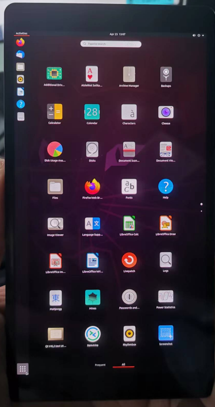

          george @george last edited by george
          @george Add 5.5inch HDMI AMOLED edid
          https://www.waveshare.net/shop/5.5inch-HDMI-AMOLED.htm
          index 4fdfb41b91e1..b1171d8cbf2d 100644
          @@ -575,6 +575,14 @@ static const struct drm_display_mode drm_dmt_modes[] = {
          +       /* 0x60 - 1080x1920@60Hz RB */
          +       { DRM_MODE("1080x1920", DRM_MODE_TYPE_DRIVER, 137520, 1080, 1112,
          +                  1144, 1200, 0, 1920, 1928, 1932, 1936, 0,
          +                  DRM_MODE_FLAG_NHSYNC | DRM_MODE_FLAG_NVSYNC) },
