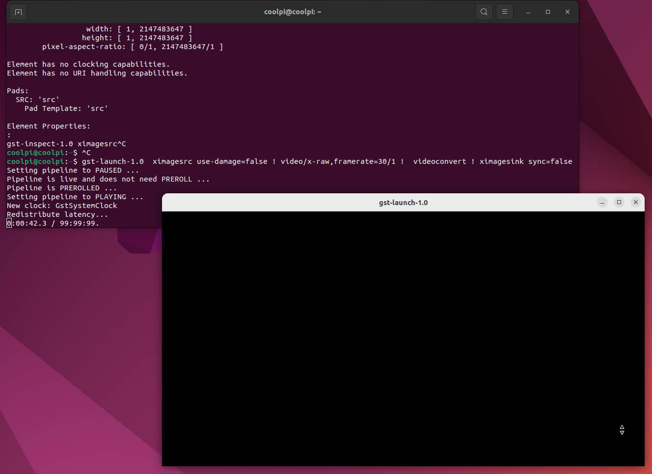

    ximagesrc 抓的是黑的
    rk的有没有硬件支持 能获取到hdmi输出的yuv数据
    G 2 Replies Last reply Apr 27, 2023, 8:29 AM Reply Quote 0

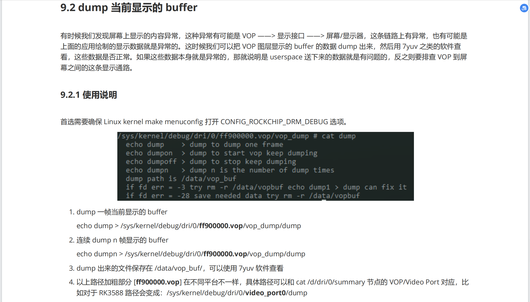

        george @jugg last edited by Apr 27, 2023, 8:29 AM
        @jugg 还可以参考下图方法直接dump出buffer
