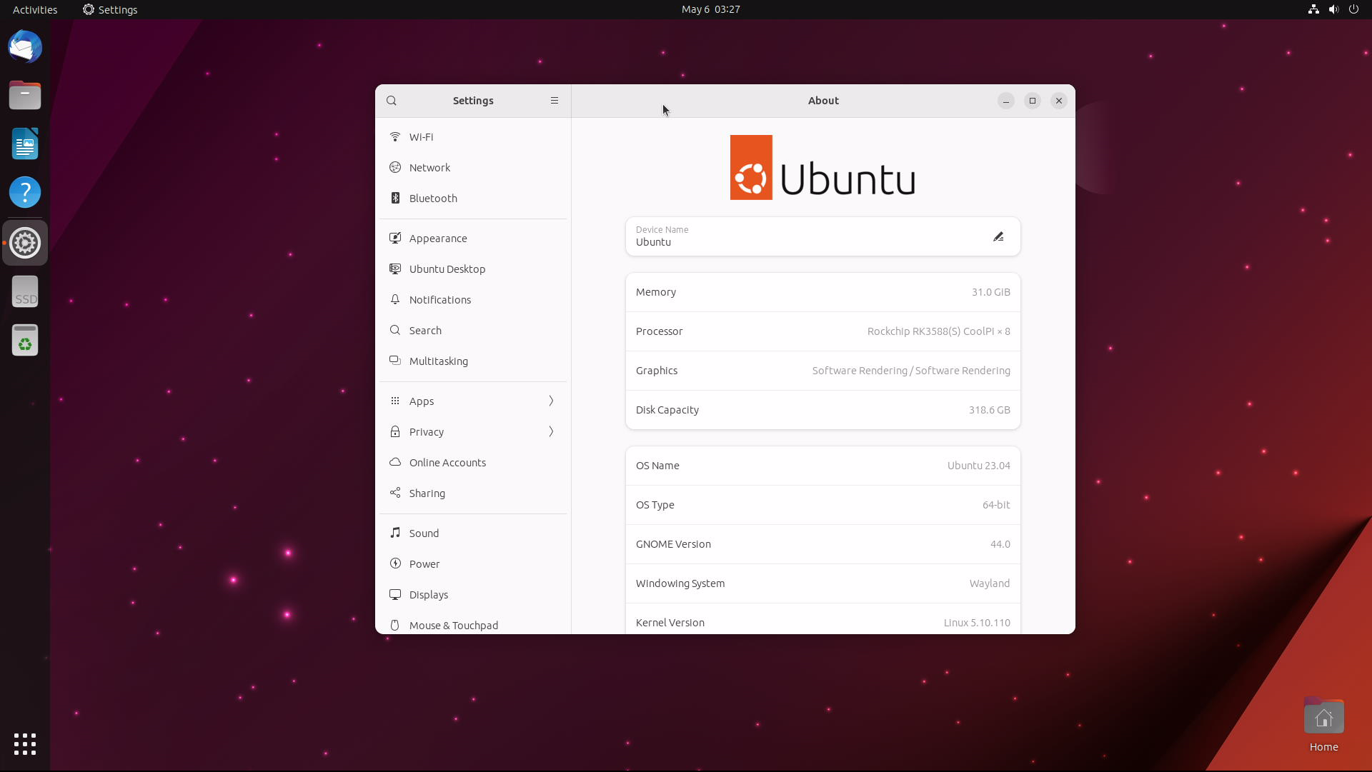

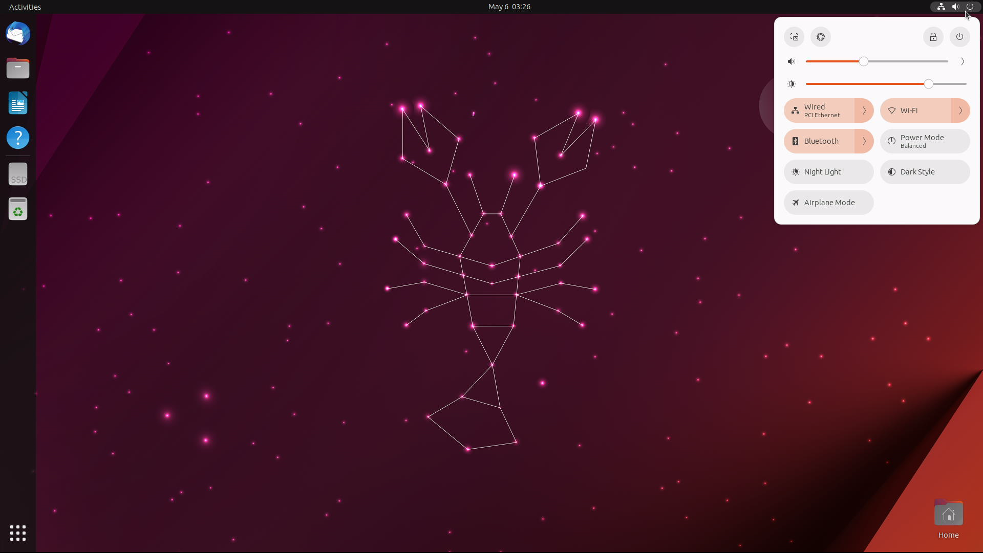

    Ubuntu23.04 for CoolPi
    29
    3016
      Default Account
      username:coolpi password:123
      Update GPU driver
      sudo add-apt-repository ppa:george-coolpi/mali-g610
      sudo apt-get dist-upgrade
      Update multimedia decoding library
      sudo add-apt-repository ppa:george-coolpi/multimedia
