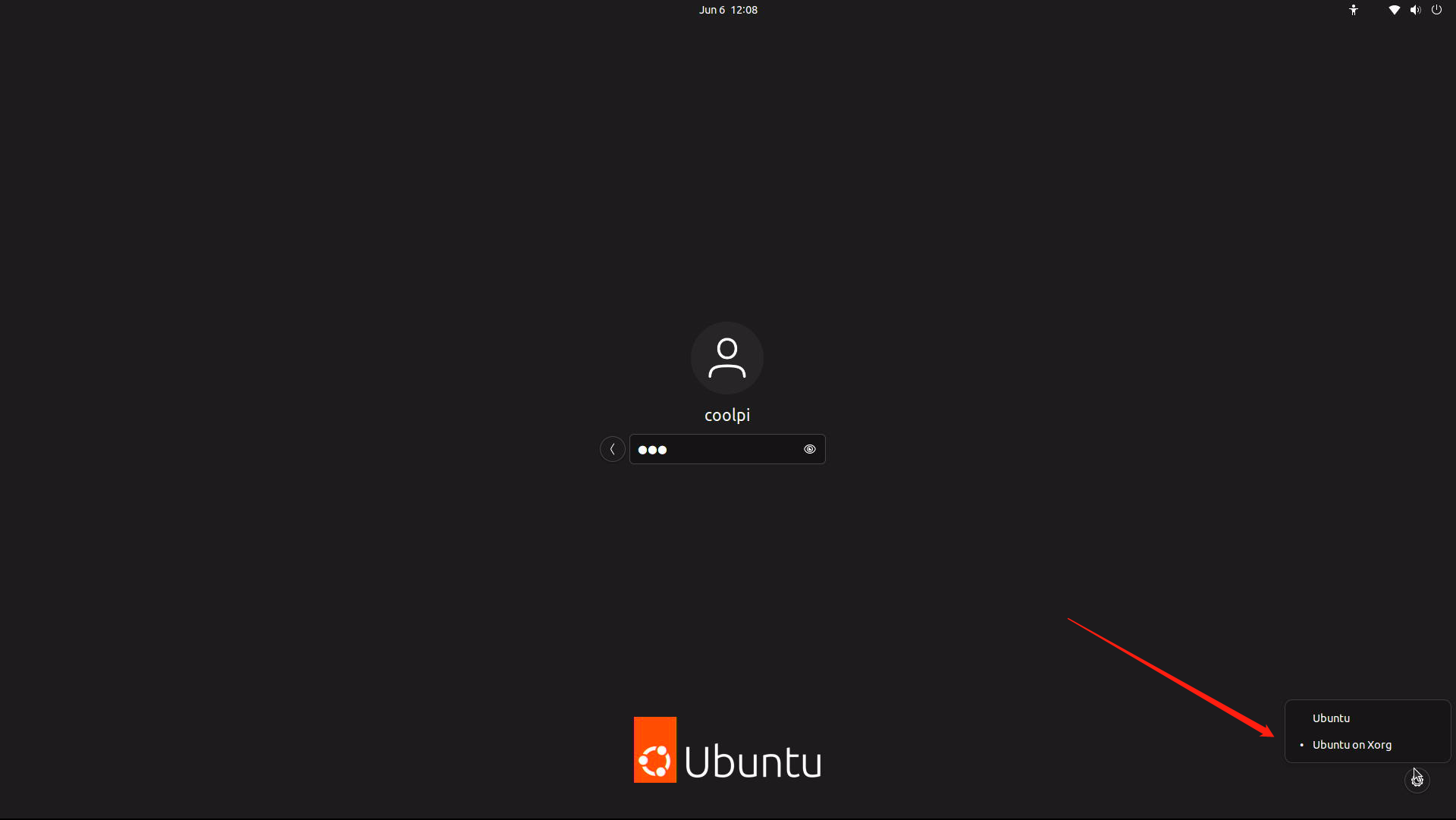

          george @jugg last edited by Jun 6, 2023, 12:08 PM
          @jugg 显示框架改到X11测试,再登录界面选择:
          J 1 Reply Last reply Jun 7, 2023, 1:01 AM Reply Quote 0
            jugg @george last edited by Jun 7, 2023, 1:01 AM
            已经是X11的 而且右下角没有的选 空白的
