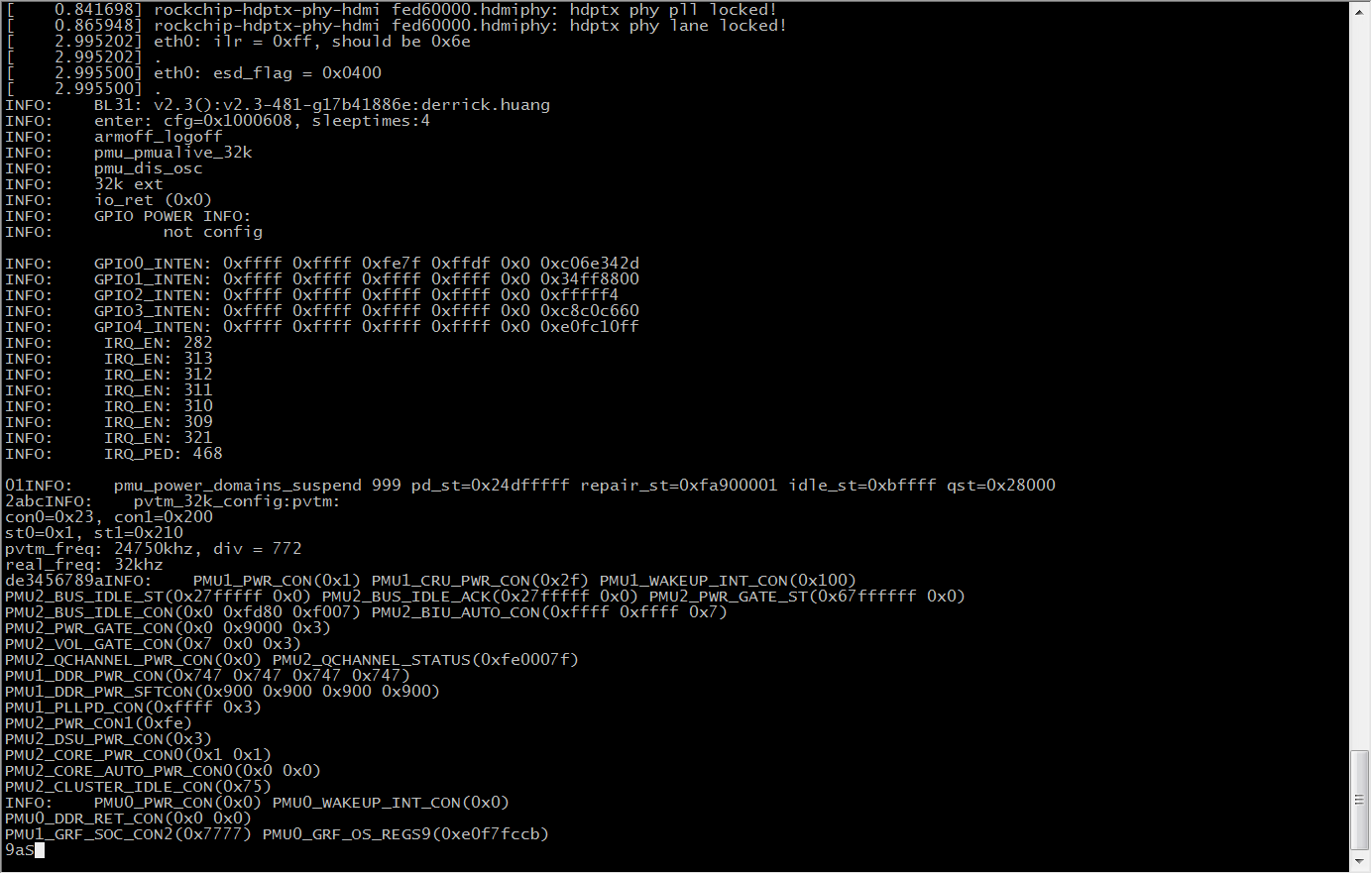

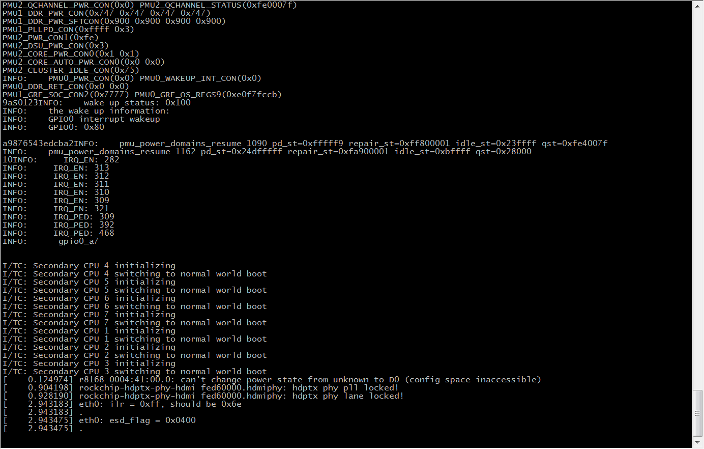

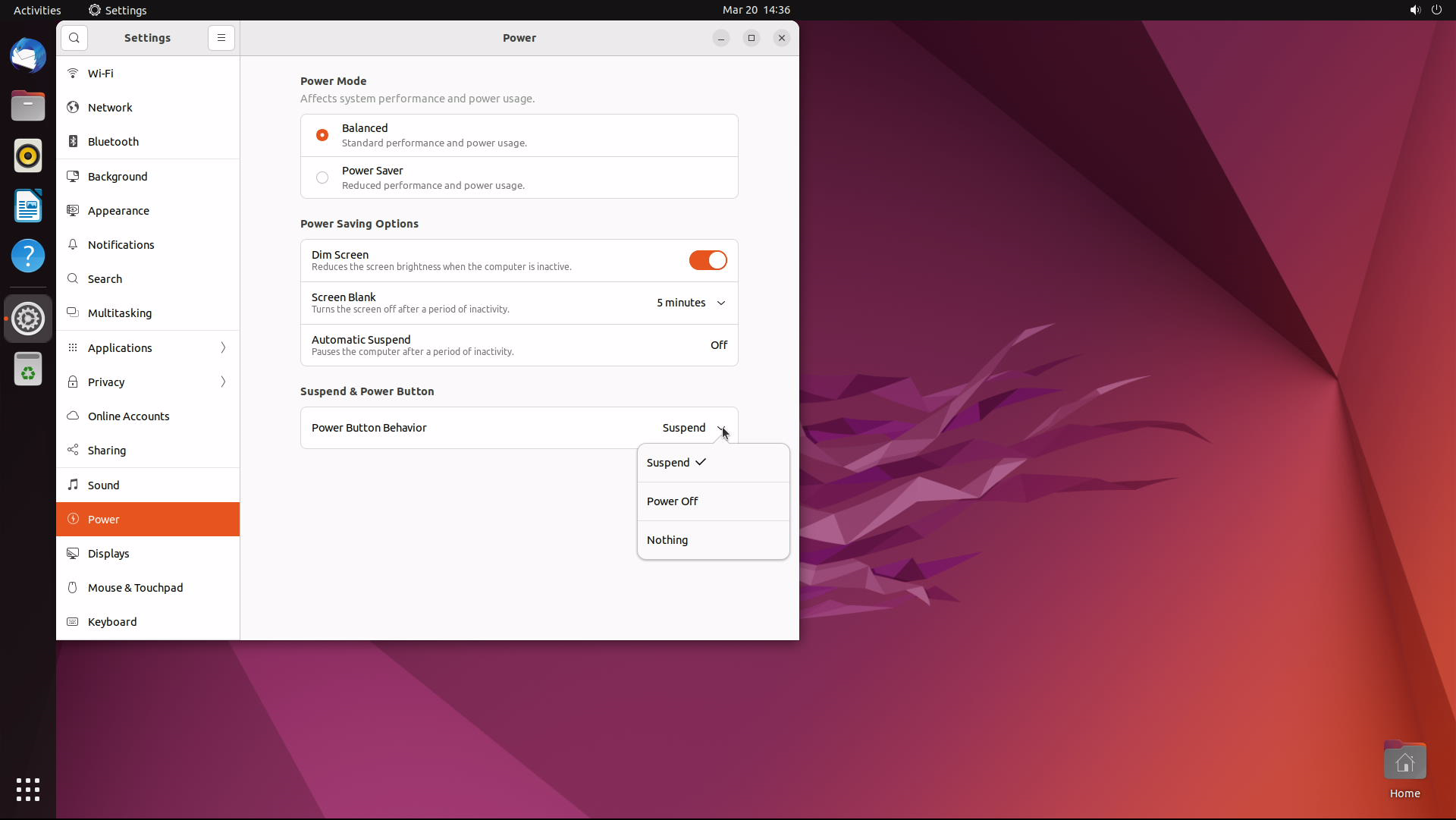

                          george @zensation last edited by
                          @zensation
                          I tested the latest image of ubuntu22.04 and did not find the problem you described. As shown in the following figure, the PWR button is configured as suspend. The first press to enter sleep can be seen from the log information, and the second press to wake up the system.
