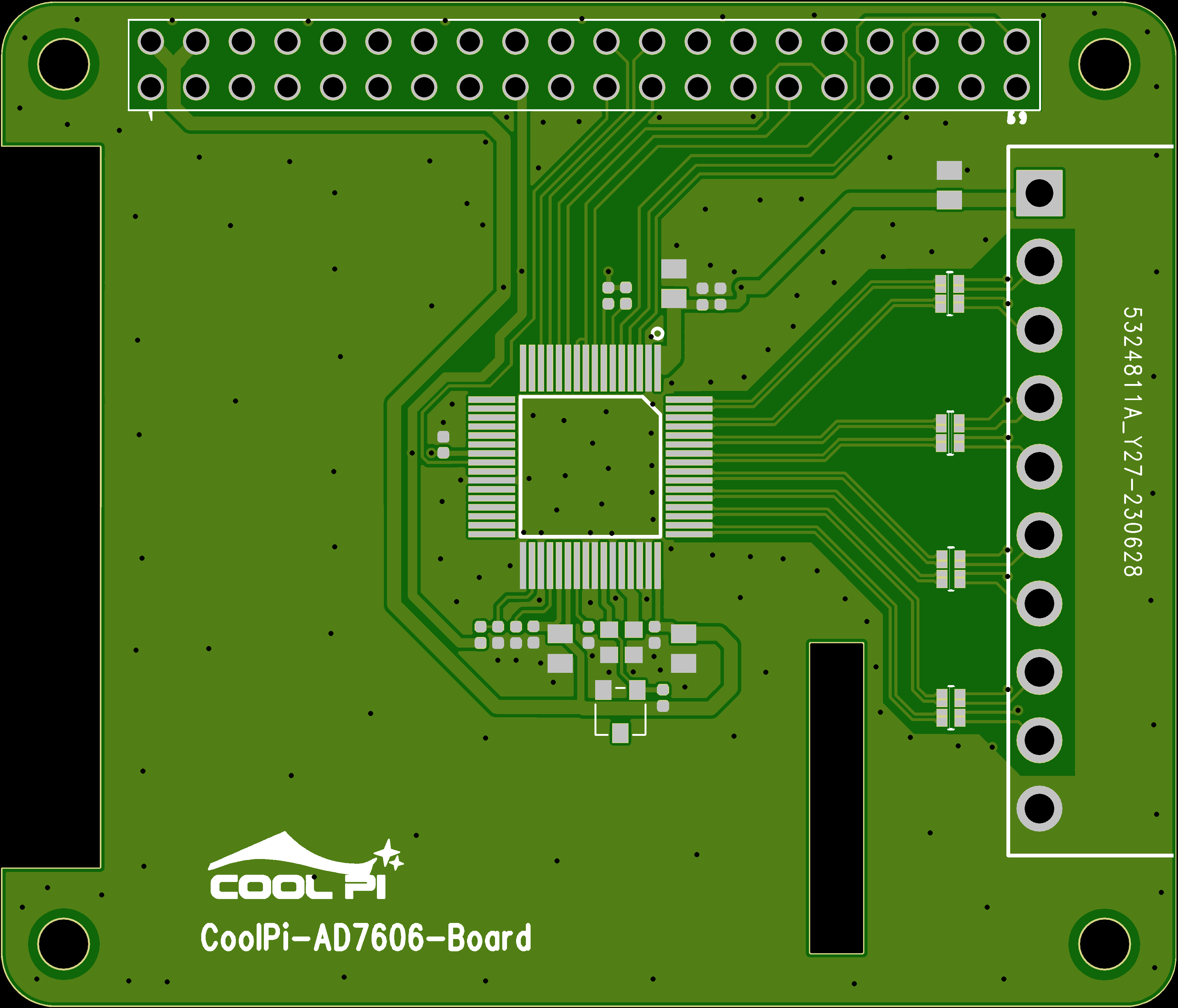

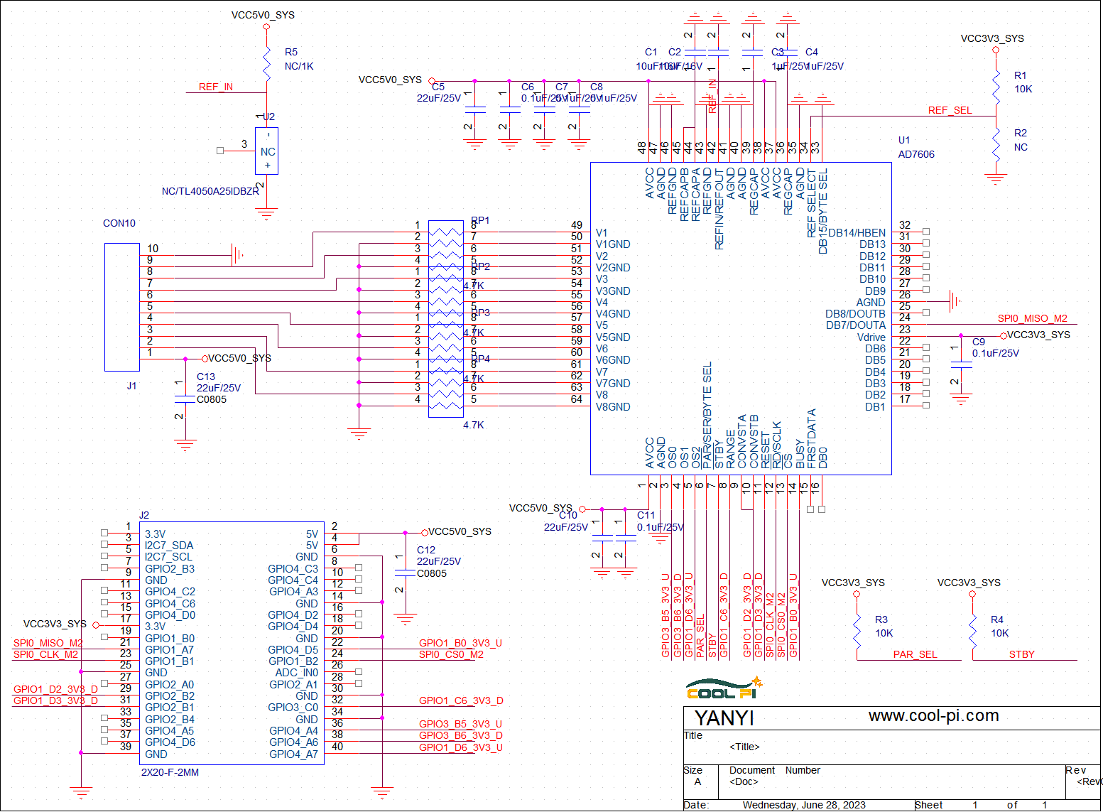

    COOLPI CM5 AD7606 8-channel synchronous sampling
    736
      • Using SPI serial communication interface, the circuit is as follows

      • The schematic and PCB files can be downloaded from the wiki,Some empty PCBs can also be given away for free.
