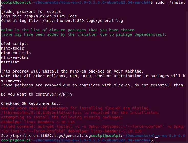

      我在装mellanox的时候遇到无法识别linux内核头文件的问题,这个该怎么解决呢?希望可以解答。
        george @Jake last edited by
        @Jake 这个需要把内核的头文件编译生成DEB包,然后系统上安装。
        J J 4 Replies Last reply Reply Quote 0

            Jachyn @george last edited by
              目前的错误提示如上图所示,问一下怎么把内核的头文件编译生成deb包呢?🤔
                大法师 @Jachyn last edited by
                @Jachyn 我们提供的内核源码,你下载一份,先编译一次。

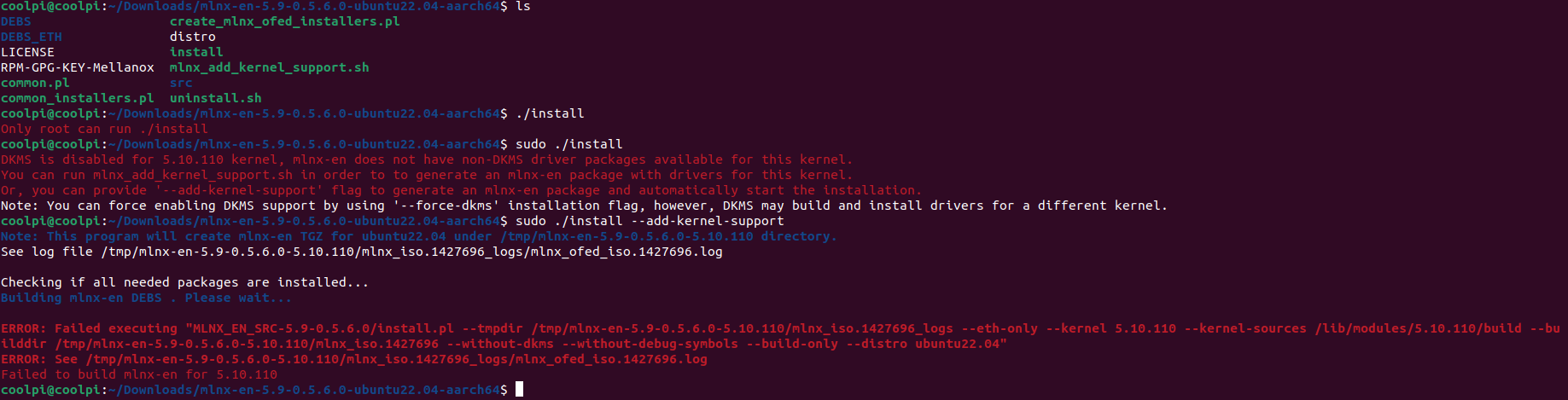

                  @大法师 大师 内核已经编译了 编译之后进行安装 又报如下的错
                  J 大法师 2 Replies Last reply Reply Quote 0

                                        Jachyn @大法师 last edited by
                                        coolpi@coolpi:~/Downloads/mlnx-en-5.9-0.5.6.0-ubuntu22.04-aarch64$ sudo ./install --add-kernel-support
                                        Note: This program will create mlnx-en TGZ for ubuntu22.04 under /tmp/mlnx-en-5.9-0.5.6.0-5.10.110 directory.
                                        See log file /tmp/mlnx-en-5.9-0.5.6.0-5.10.110/mlnx_iso.109096_logs/mlnx_ofed_iso.109096.log
                                        Checking if all needed packages are installed...
                                        Building mlnx-en DEBS . Please wait...
                                        ERROR: Failed executing "MLNX_EN_SRC-5.9-0.5.6.0/install.pl --tmpdir /tmp/mlnx-en-5.9-0.5.6.0-5.10.110/mlnx_iso.109096_logs --eth-only --kernel 5.10.110 --kernel-sources /lib/modules/5.10.110/build --builddir /tmp/mlnx-en-5.9-0.5.6.0-5.10.110/mlnx_iso.109096 --without-dkms --without-debug-symbols --build-only --distro ubuntu22.04"
                                        ERROR: See /tmp/mlnx-en-5.9-0.5.6.0-5.10.110/mlnx_iso.109096_logs/mlnx_ofed_iso.109096.log
                                        Failed to build mlnx-en for 5.10.110
                                        是不是这系统就不支持这个驱动呢

                                                      Preparing to unpack .../mlnx-fw-updater_5.8-1.0.1.1_arm64.deb ...
                                                      Unpacking mlnx-fw-updater (5.8-1.0.1.1) ...
                                                      Setting up mlnx-fw-updater (5.8-1.0.1.1) ...
                                                      Initializing...
                                                      Attempting to perform Firmware update...
                                                      Querying Mellanox devices firmware ...
                                                      Device #1:
                                                        Device Type:      ConnectX4LX
                                                        Part Number:      MCX4121A-ACA_Ax
                                                        Description:      ConnectX-4 Lx EN network interface card; 25GbE dual-port SFP28; PCIe3.0 x8; ROHS R6
                                                        PSID:             MT_2420110034
                                                        PCI Device Name:  0001:11:00.0
                                                        Base MAC:         98039b2ba640
                                                        Versions:         Current        Available
                                                           FW             14.32.1010     14.32.1010
                                                           PXE            3.6.0502       3.6.0502
                                                           UEFI           14.25.0017     14.25.0017
                                                        Status:           Up to date
                                                      Log File: /tmp/DR3i76jLzy
                                                      Real log file: /tmp/mlnx-en.738979.logs/fw_update.log
                                                      Device (0001:11:00.0):
                                                      	0001:11:00.0 Ethernet controller: Mellanox Technologies MT27710 Family [ConnectX-4 Lx]
                                                      	Link Width: x2 ( WARNING - device supports x8 )
                                                      	PCI Link Speed: 2.5GT/s
                                                      Device (0001:11:00.1):
                                                      	0001:11:00.1 Ethernet controller: Mellanox Technologies MT27710 Family [ConnectX-4 Lx]
                                                      Installation passed successfully
                                                      To load the new driver, run:
                                                      /etc/init.d/mlnx-en.d restart
                                                      coolpi@coolpi:~/Downloads/mlnx-en-5.8-1.0.1.1-ubuntu22.04-aarch64$ /etc/init.d/mlnx-en.d restart
                                                      Unloading NIC driver:                                      [  OK  ]
                                                      Loading Mellanox MLX5 NIC driver:                          [FAILED]
                                                      Loading NIC driver:                                        [FAILED]
                                                      Please run /usr/sbin/sysinfo-snapshot.py to collect the debug information
                                                      and open an issue in the http://support.mellanox.com/SupportWeb/service_center/SelfService

                                                        coolpi@coolpi:~/Downloads/mlnx-en-5.8-2.0.3.0-ubuntu22.04-aarch64$ sudo ./install --force-dkms
                                                        [sudo] password for coolpi:
                                                        Logs dir: /tmp/mlnx-en.3438.logs
                                                        General log file: /tmp/mlnx-en.3438.logs/general.log
                                                        Below is the list of mlnx-en packages that you have chosen
                                                        (some may have been added by the installer due to package dependencies):
                                                        ofed-scripts
                                                        mlnx-tools
                                                        mlnx-en-utils
                                                        mlnx-en-dkms
                                                        mstflint
                                                        This program will install the mlnx-en package on your machine.
                                                        Note that all other Mellanox, OEM, OFED, RDMA or Distribution IB packages will be removed.
                                                        Those packages are removed due to conflicts with mlnx-en, do not reinstall them.
                                                        Do you want to continue?[y/N]:y
                                                        Checking SW Requirements...
                                                        Removing old packages...
                                                        Uninstalling the previous version of mlnx-en
                                                        Installing new packages
                                                        Installing ofed-scripts-5.8...
                                                        Installing mlnx-tools-5.2.0...
                                                        Installing mlnx-en-utils-5.8...
                                                        Installing mlnx-en-dkms-5.8...
                                                        Installing mstflint-4.16.1...
                                                        Selecting previously unselected package mlnx-fw-updater.
                                                        (Reading database ... 199866 files and directories currently installed.)
                                                        Preparing to unpack .../mlnx-fw-updater_5.8-2.0.3.0_arm64.deb ...
                                                        Unpacking mlnx-fw-updater (5.8-2.0.3.0) ...
                                                        Setting up mlnx-fw-updater (5.8-2.0.3.0) ...
                                                        Initializing...
                                                        Device #1:
                                                          PSID:             MT_2420110034
                                                          Status:           Up to date
                                                        Log File: /tmp/05iafkfb8h
                                                        Real log file: /tmp/mlnx-en.3438.logs/fw_update.log
                                                        	PCI Link Speed: 8GT/s
                                                        coolpi@coolpi:~/Downloads/mlnx-en-5.8-2.0.3.0-ubuntu22.04-aarch64$ /etc/init.d/mlnx-en.d restart
