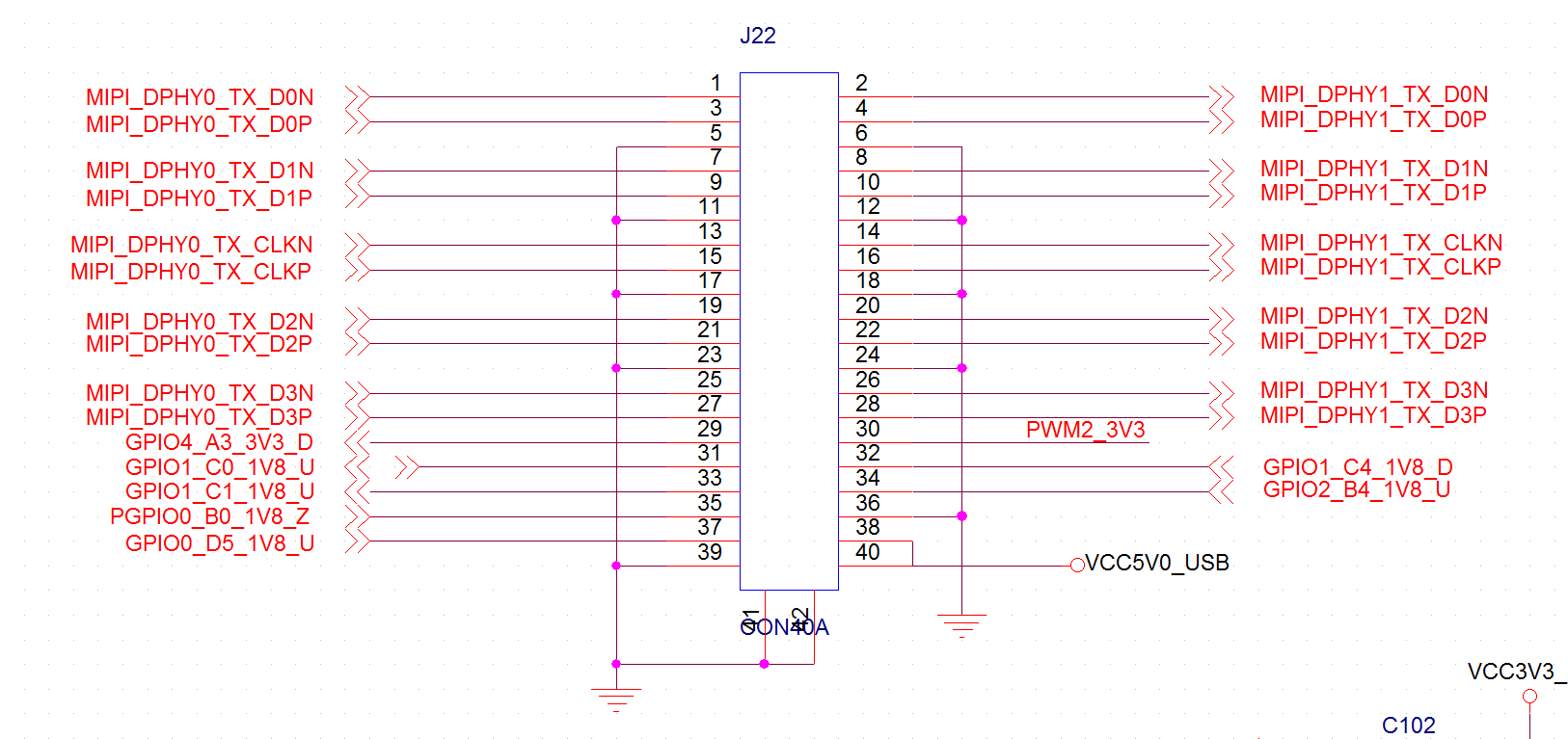

                                            • This screen CM5 can be supported, and you need to create a separate adapter board or adapter cable to be compatible with its PIN sequence.
                                            • The DSI interface of CM5 is shown below, including 2 sets of independent 4LINE DSI channels, 2 sets of I2C interfaces, etc., which can simultaneously drive two DSI interfaces for LCD, with a resolution of 2560 * 1600
                                            • It should be noted that the level of some IO is 1.8V, which requires a level conversion circuit to 3.3V.
                                              anernest @george last edited by
                                              @george Thank you. This is very helpful.
