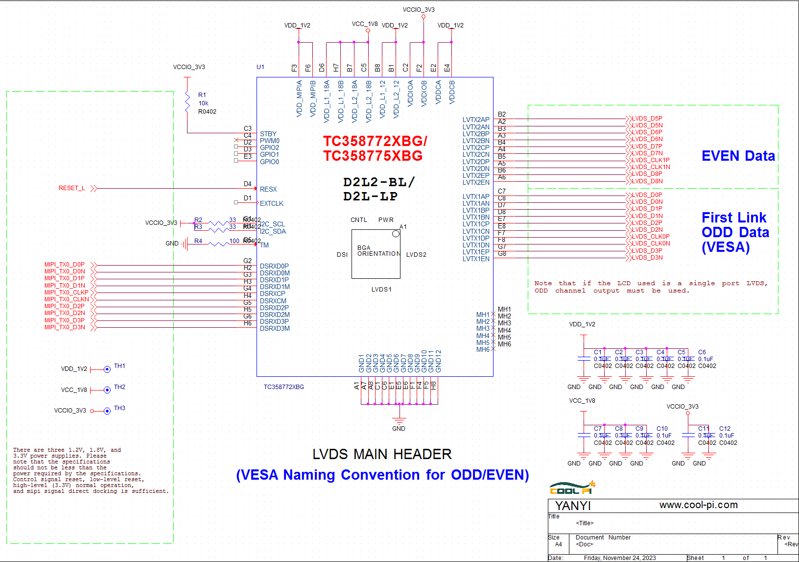

          Xelef2000 @george last edited by
          @george Thanks for the answer.
          The TC358775 seems most suitable for my application. Do you have any reference schematics for this IC?
            george @Xelef2000 last edited by
            @Xelef2000
            MIPI-LVDS-TC358775.pdf
            TC358775.DSN
