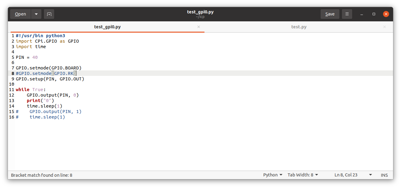

    GPIO port high or low level control invalid! WHY?
    help me!!!!!!!!!!!

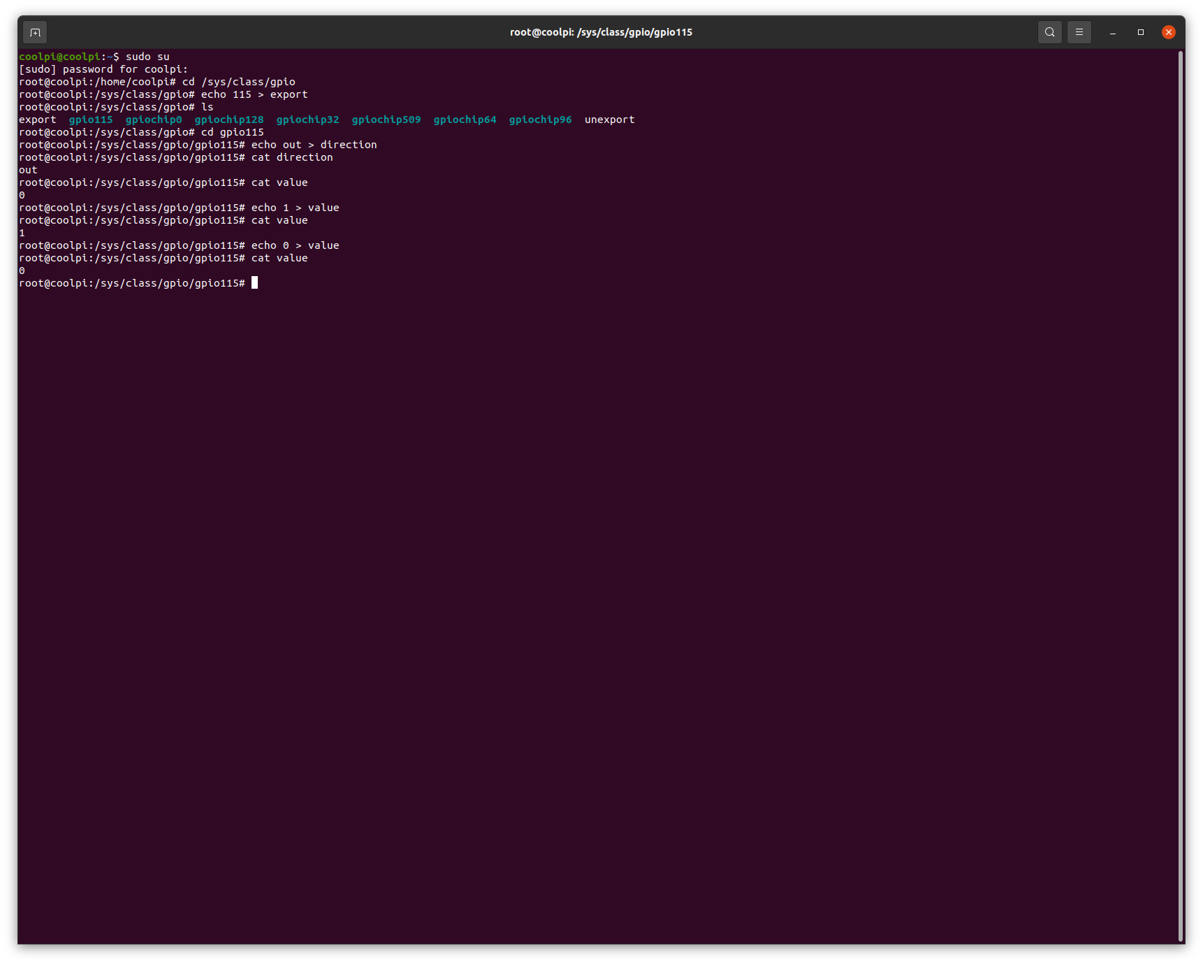

      大法师 @YDY123 last edited by Dec 15, 2023, 3:18 AM
      @YDY123 please use root user or with sudo command prefix.

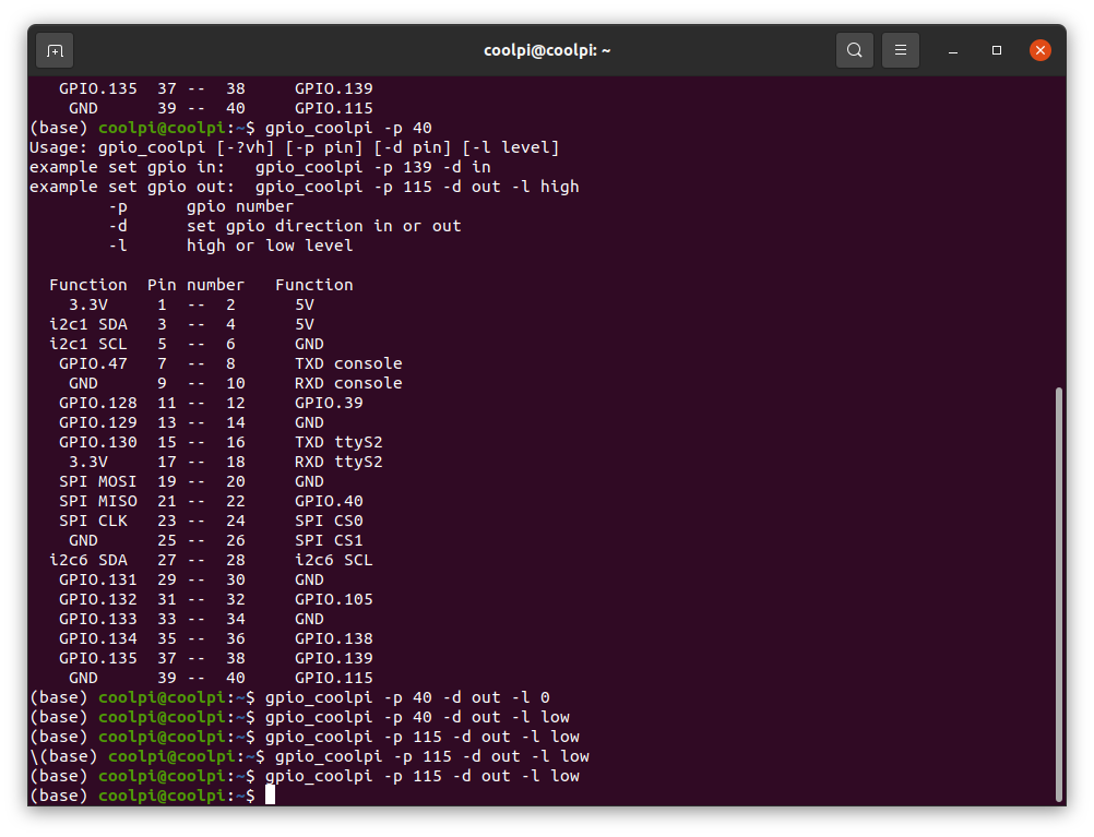

        YDY123 last edited by Dec 15, 2023, 6:41 AM
        命令都可以运行,但是输出一直是高电平
        • Y
          YDY123 last edited by Dec 15, 2023, 6:42 AM
          控制不了输出电平@大法师
