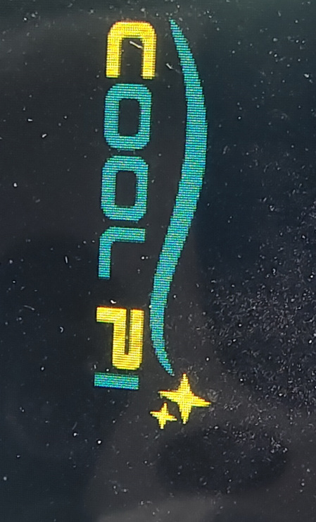

      现在这个是自己做的底板,我现在是随便抽几个接口出来测试的,也不知道有没有把有关核心板启动的重要核心部分电路去掉,这是我根据论坛提供的资料和原理图PDF做的,然后焊接好板子测试串口有输出,网口也正常,电源部分测试没问题,5V正常、3.3V也有,1.8V也有,核心板上面是能亮灯的,现在的问题是开机能进入串口,但没法启动,HDMI一直显示COOL PI这个没法进入系统,希望哪位大佬指正一下,谢谢啦

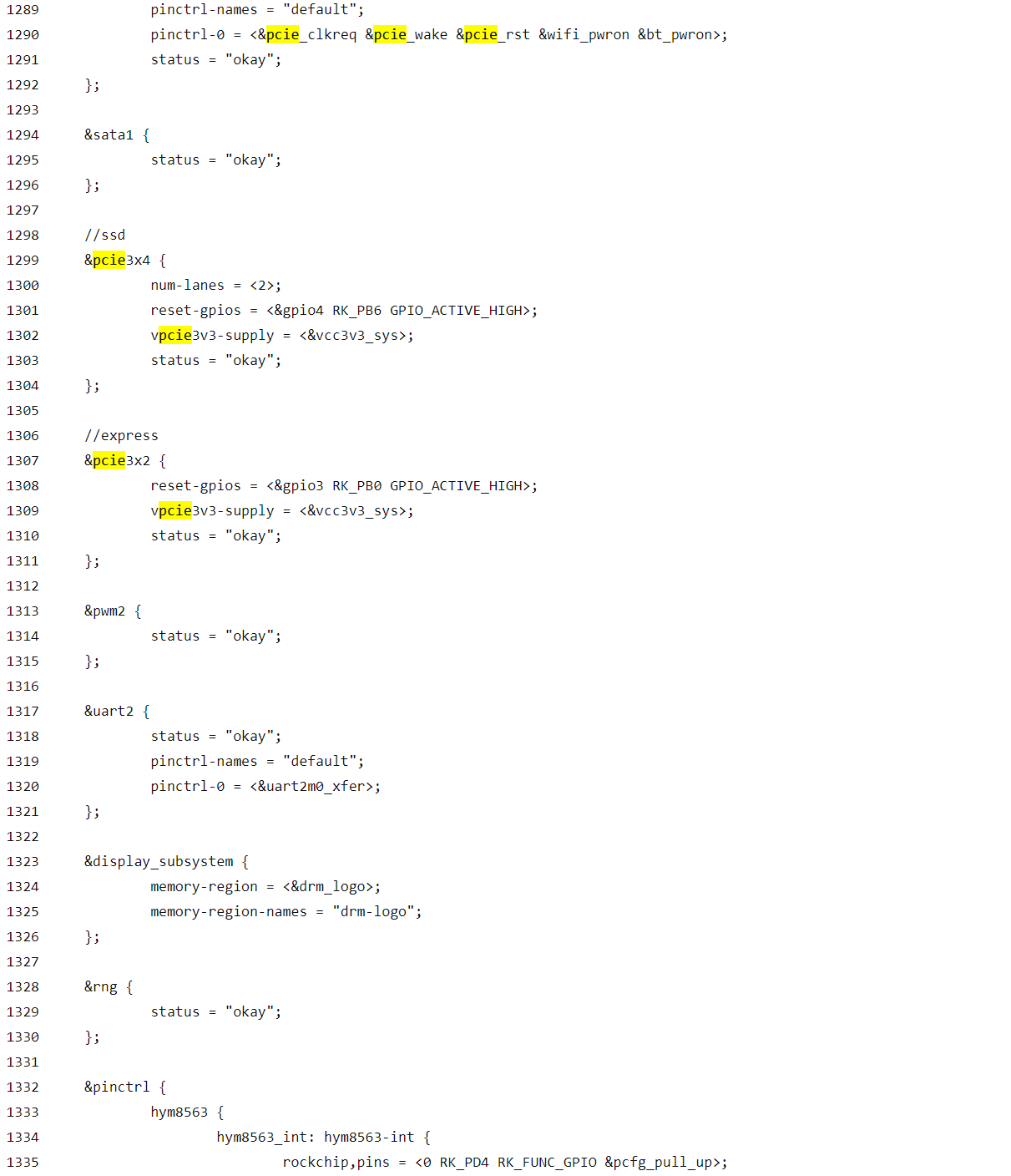

                george @阿里 last edited by
                @阿里
                diff --git a/arch/arm64/boot/dts/rockchip/rk3588-cpcm5-evb-v11.dts b/arch/arm64/boot/dts/rockchip/rk3588-cpcm5-evb-v11.dts
                index 5b04c9d3f354..11db474a1c18 100755
                --- a/arch/arm64/boot/dts/rockchip/rk3588-cpcm5-evb-v11.dts
                +++ b/arch/arm64/boot/dts/rockchip/rk3588-cpcm5-evb-v11.dts
                @@ -1258,7 +1258,7 @@ &mipi_dcphy1 {
                 &pcie30phy {
                        rockchip,pcie30-phymode = <PHY_MODE_PCIE_NANBNB>;
                -       status = "okay";
                +       status = "disabled";
                 &combphy0_ps {
                @@ -1300,14 +1300,14 @@ &pcie3x4 {
                        num-lanes = <2>;
                        reset-gpios = <&gpio4 RK_PB6 GPIO_ACTIVE_HIGH>;
                        vpcie3v3-supply = <&vcc3v3_sys>;
                -       status = "okay";
                 //express
                 &pcie3x2 {
                        reset-gpios = <&gpio3 RK_PB0 GPIO_ACTIVE_HIGH>;
                -       status = "okay";
                 &pwm2 {
                阿 1 Reply Last reply Reply Quote 0

                  @george 好的,那改好这个之后要怎么刷机呀
                    @阿里
                    机器进入UMS模式,电脑会识别到一个system-boot的盘符,然后把新生成的dtb文件拷贝进去,重启即可。
                    阿 2 Replies Last reply Reply Quote 0

                        阿里 @george last edited by
                        @george 可以了,刷好机能进入系统了,谢谢哈
