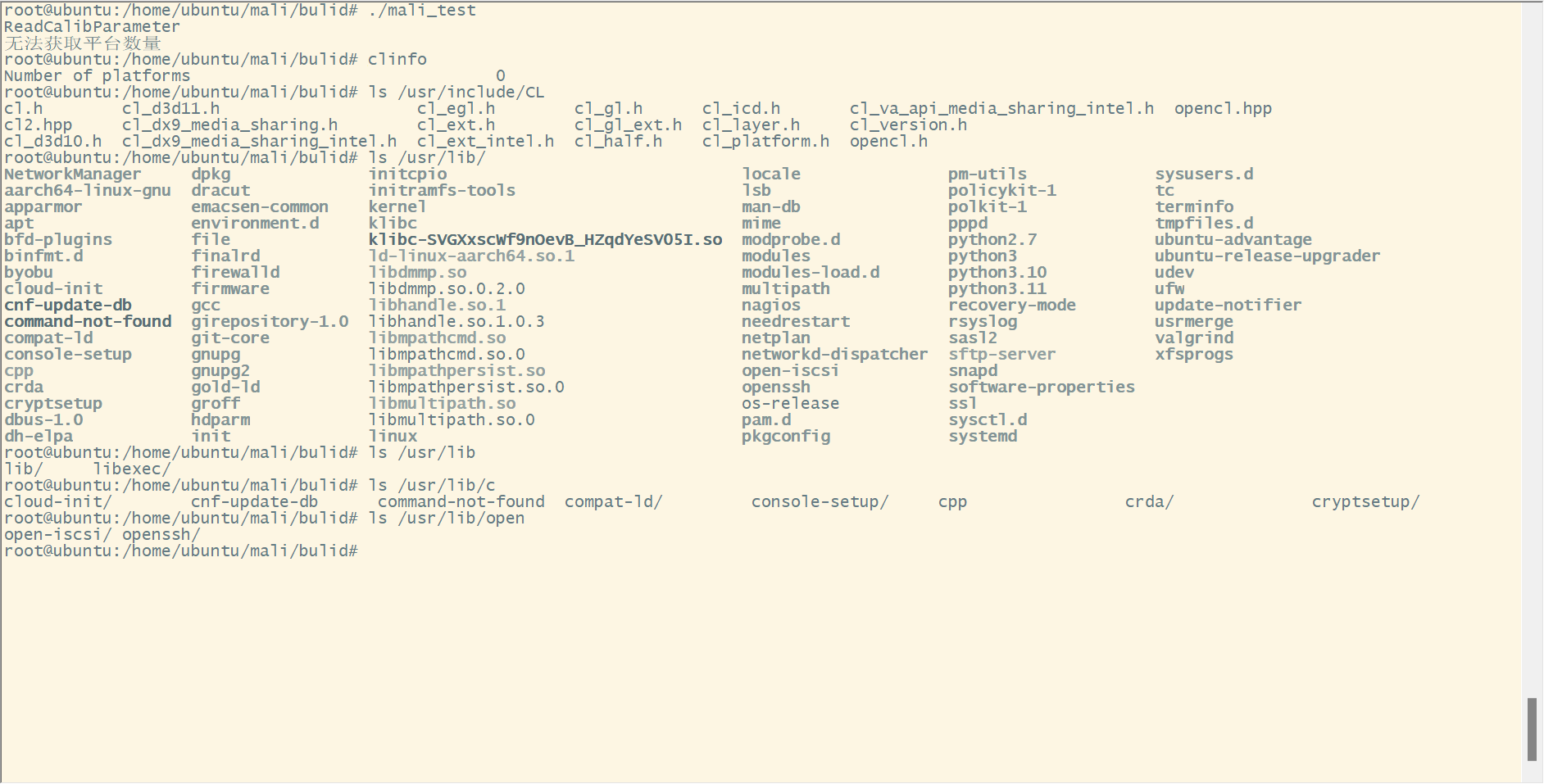

    安装Opencl但是提示找不到
    1632
    • H
      hyx last edited by
      已经执行过的命令
      sudo add-apt-repository ppa:george-coolpi/mali-g610
      sudo apt-get dist-upgrade
      sudo apt-get update
      sudo apt install opencl-headers
      sudo apt install ocl-icd-libopencl1
      sudo apt install ocl-icd-opencl-dev
      sudo apt install clinfo
      现在是能找到CL头文件但不能找到so相关的库
      • H
        hyx last edited by
        系统是ubuntu22.04的版本
        • H
          hyx last edited by
          通过命令找到了opencl库但是, clinfo还是提示数量是0?
          ldconfig -p | grep OpenCL
          libOpenCL.so.1 (libc6,AArch64) => /lib/aarch64-linux-gnu/libOpenCL.so.1
          libOpenCL.so (libc6,AArch64) => /lib/aarch64-linux-gnu/libOpenCL.so
          root@ubuntu:/usr/lib# ls -la /lib/aarch64-linux-gnu/libOpen*
          lrwxrwxrwx 1 root root 18 Sep 30 2021 /lib/aarch64-linux-gnu/libOpenCL.so -> libOpenCL.so.1.0.0
          lrwxrwxrwx 1 root root 18 Sep 30 2021 /lib/aarch64-linux-gnu/libOpenCL.so.1 -> libOpenCL.so.1.0.0
          -rw-r--r-- 1 root root 60856 Sep 30 2021 /lib/aarch64-linux-gnu/libOpenCL.so.1.0.0
          lrwxrwxrwx 1 root root 14 Jan 4 2022 /lib/aarch64-linux-gnu/libOpenGL.so -> libOpenGL.so.0
          lrwxrwxrwx 1 root root 18 Jan 4 2022 /lib/aarch64-linux-gnu/libOpenGL.so.0 -> libOpenGL.so.0.0.0
          -rw-r--r-- 1 root root 370784 Jan 4 2022 /lib/aarch64-linux-gnu/libOpenGL.so.0.0.0
