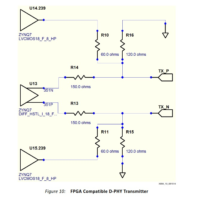

      I have issue with connecting and video streaming from FPGA Xilinx Artix-7 MIPI CSI-2 TX Xilinx IP core to CoolPi CM5.
      I try to use example app and resistive model D-PHY U14.239 from https://docs.xilinx.com/v/u/en-US/xapp894-d-phy-solutions
