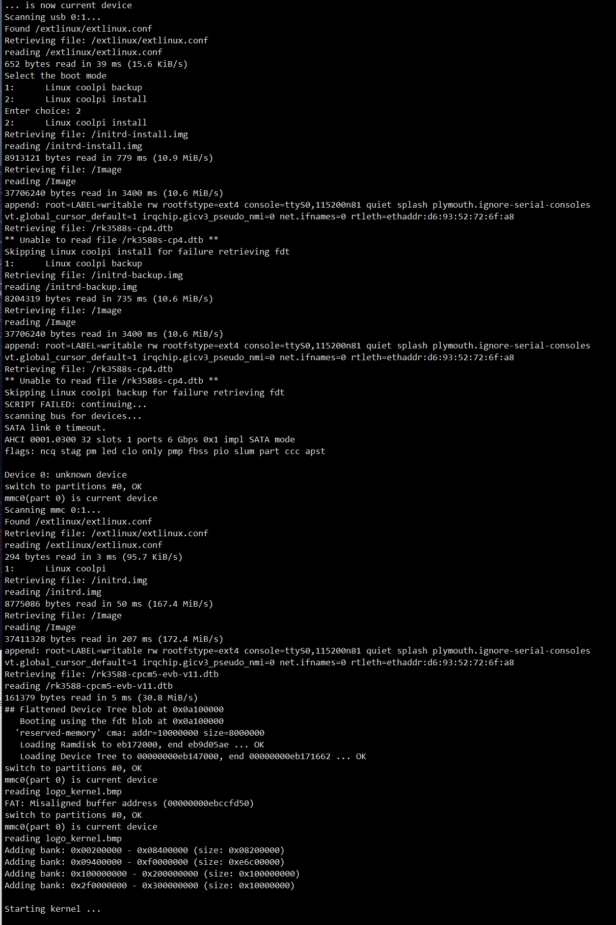

      试了两个不同的U盘 都不能进行还原
      这个有什么要求?需要什么型号的U盘?
        卡在logo那里 屏幕也没有进度条

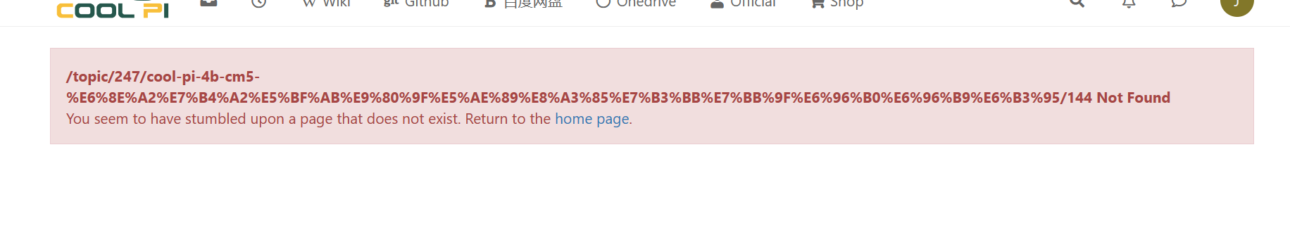

          https://www.cool-pi.com/topic/247/cool-pi-4b-cm5-探索快速安装系统新方法/144?page=8

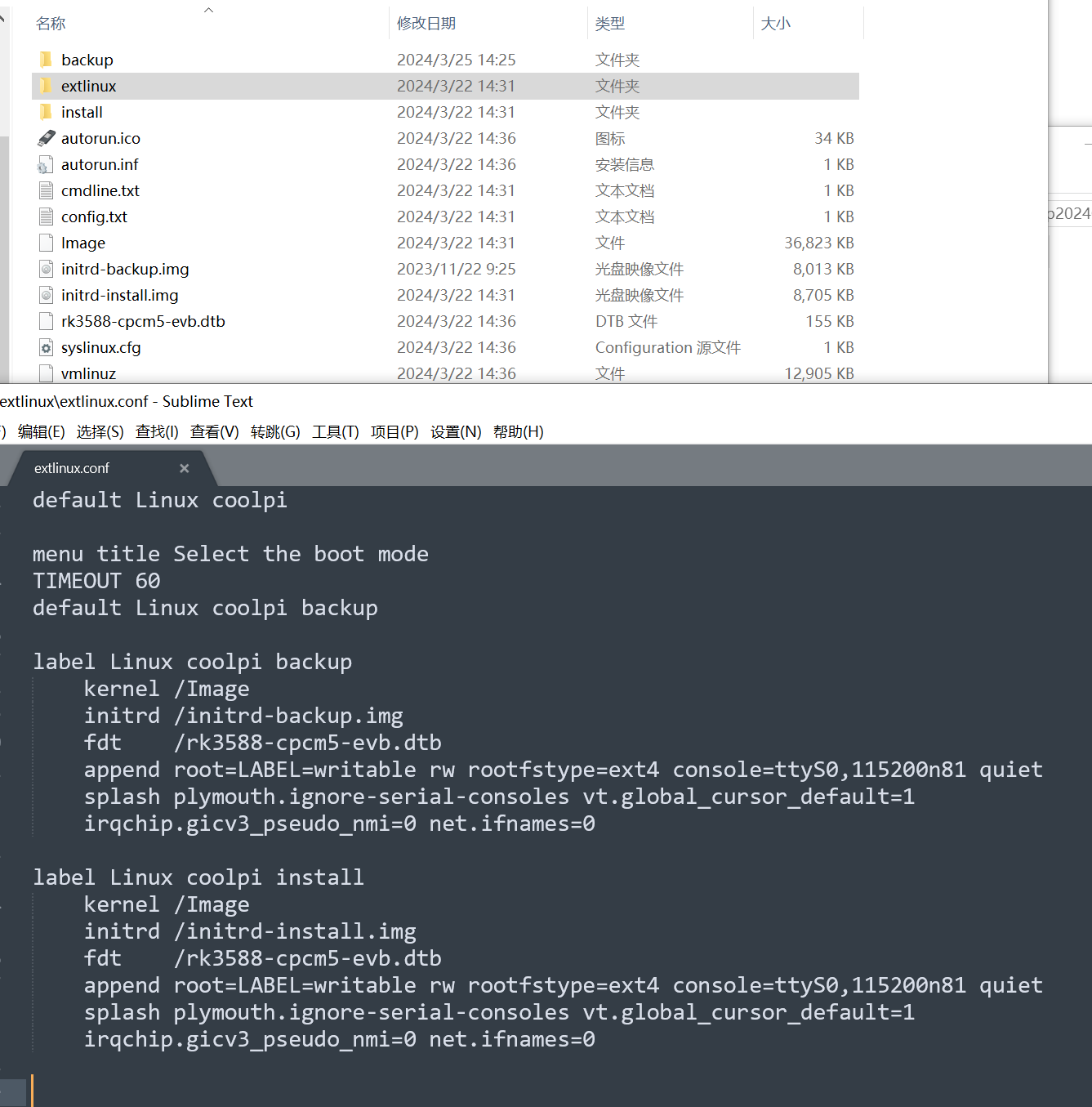

          备份:
          修改U盘默认配置文件extlinux/extlinux.conf
          原始
          label Linux coolpi
          kernel /Image
          initrd /initrd.img
          修改后
          label Linux coolpi
          kernel /Image
          initrd /initrd-backup.img

            链接的页面打不开
            我两块U盘
            安装盘 安装的是这个
            备份盘 备份出来的是这个
            换过去 还原不了
            不换 也还原不了
              jugg @大法师 last edited by jugg
              这个就是原来安装盘的镜像 还原的结果
              没有替换我备份出来的系统
                还原不了

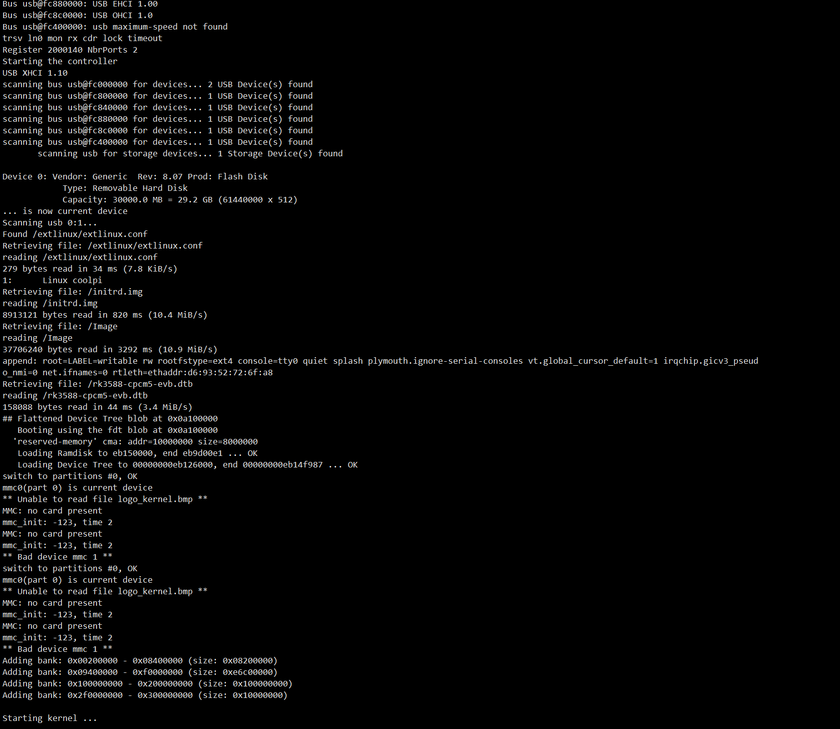

                  wait for device.
                  AT2S9C
                  wait for external disk device...........mount: mounting /dev/sda1 on /tmp/boot failed: No such file or directory
                  Could not mount src boot partition

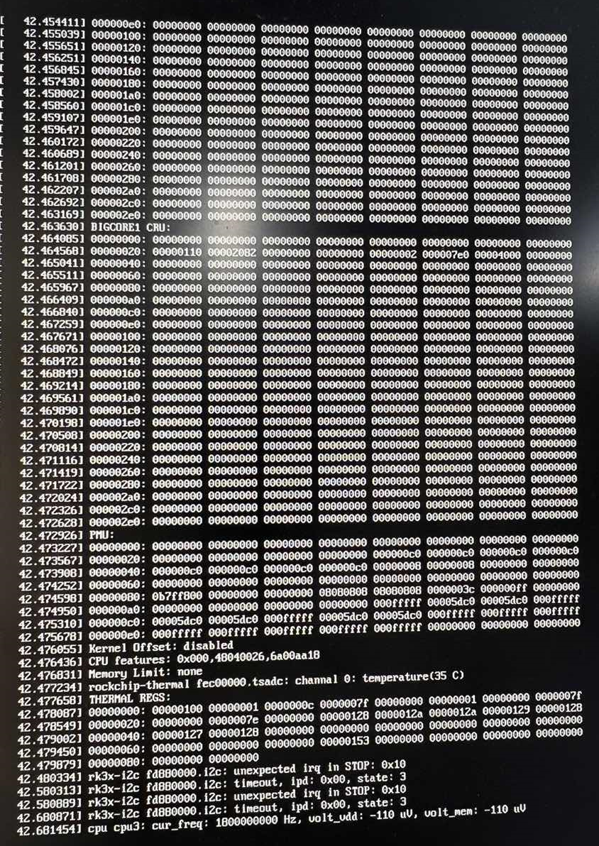

                  [   46.717516] rk3x-i2c fec90000.i2c: timeout, ipd: 0x00, state: 3
                  [   46.723433] es8316 7-0010: ASoC: error at soc_component_write_no_lock on es8316.7-0010: -110
                  [   46.834180] rk3x-i2c fec90000.i2c: timeout, ipd: 0x00, state: 3
                  [   46.840093] es8316 7-0010: ASoC: error at soc_component_write_no_lock on es8316.7-0010: -110
                  [   46.950848] rk3x-i2c fec90000.i2c: timeout, ipd: 0x00, state: 3
                  [   46.956760] es8316 7-0010: ASoC: error at soc_component_write_no_lock on es8316.7-0010: -110
                  [   47.067514] rk3x-i2c fec90000.i2c: timeout, ipd: 0x00, state: 3
                  [   47.073428] es8316 7-0010: ASoC: error at soc_component_write_no_lock on es8316.7-0010: -110
                  [   47.184183] rk3x-i2c fec90000.i2c: timeout, ipd: 0x00, state: 3
                  [   47.190097] es8316 7-0010: ASoC: error at soc_component_write_no_lock on es8316.7-0010: -110
                  [   47.300850] rk3x-i2c fec90000.i2c: timeout, ipd: 0x00, state: 3
                  [   47.306765] es8316 7-0010: ASoC: error at soc_component_write_no_lock on es8316.7-0010: -110
                  [   47.417517] rk3x-i2c fec90000.i2c: timeout, ipd: 0x00, state: 3
                  [   47.423431] es8316 7-0010: ASoC: error at soc_component_write_no_lock on es8316.7-0010: -110
                  [   47.534184] rk3x-i2c fec90000.i2c: timeout, ipd: 0x00, state: 3
                  [   47.540099] es8316 7-0010: ASoC: error at soc_component_write_no_lock on es8316.7-0010: -110
                  [   47.650851] rk3x-i2c fec90000.i2c: timeout, ipd: 0x00, state: 3
                  [   47.656765] es8316 7-0010: ASoC: error at soc_component_write_no_lock on es8316.7-0010: -110
                  [   47.767518] rk3x-i2c fec90000.i2c: timeout, ipd: 0x00, state: 3
                  [   47.773432] es8316 7-0010: ASoC: error at soc_component_write_no_lock on es8316.7-0010: -110
                  [   47.884183] rk3x-i2c fec90000.i2c: timeout, ipd: 0x00, state: 3
                  [   47.890098] es8316 7-0010: ASoC: error at soc_component_write_no_lock on es8316.7-0010: -110
                  [   48.000850] rk3x-i2c fec90000.i2c: timeout, ipd: 0x00, state: 3
                  [   48.006765] es8316 7-0010: ASoC: error at soc_component_write_no_lock on es8316.7-0010: -110
                  [   48.117521] rk3x-i2c fec90000.i2c: timeout, ipd: 0x00, state: 3
                  [   48.123435] es8316 7-0010: ASoC: error at soc_component_write_no_lock on es8316.7-0010: -110
                  [   48.324850] Unable to handle kernel NULL pointer dereference at virtual address 0000000000000290
                  [   48.333624] Mem abort info:
                  [   48.336412]   ESR = 0x96000005
                  [   48.339461]   EC = 0x25: DABT (current EL), IL = 32 bits
                  [   48.344762]   SET = 0, FnV = 0
                  [   48.347808]   EA = 0, S1PTW = 0
                  [   48.350942] Data abort info:
                  [   48.353814]   ISV = 0, ISS = 0x00000005
                  [   48.357640]   CM = 0, WnR = 0
                  [   48.360600] user pgtable: 4k pages, 39-bit VAs, pgdp=0000000106a93000
                  [   48.367028] [0000000000000290] pgd=0000000000000000, p4d=0000000000000000, pud=0000000000000000
                  [   48.375712] Internal error: Oops: 96000005 [#1] SMP
                  [   48.380577] Modules linked in:
                  [   48.383625] CPU: 1 PID: 1 Comm: reboot Not tainted 5.10.110 #21
                  [   48.389530] Hardware name: RK3588 CoolPi CM5 EVB Board (DT)
                  [   48.395090] pstate: 60400009 (nZCv daif +PAN -UAO -TCO BTYPE=--)
                  [   48.401087] pc : fxgmac_disable_rx+0x108/0x120
                  [   48.405519] lr : fxgmac_disable_rx+0x90/0x120
                  [   48.409864] sp : ffffffc01252bb70
                  [   48.413168] x29: ffffffc01252bb70 x28: ffffff8100829d00
                  [   48.418468] x27: 0000000000000000 x26: 0000000000000001
                  [   48.423767] x25: 0000000000000000 x24: ffffff8104ab68c0
                  [   48.429066] x23: 0000000000000000 x22: 0000000000000001
                  [   48.434365] x21: ffffff8104ab6000 x20: 0000000000000004
                  [   48.439665] x19: ffffff8104ab68c0 x18: 0000000000000002
                  [   48.444964] x17: 0000000000000000 x16: 00000072403c3448
                  [   48.450264] x15: ffffffc0113e9630 x14: ffffffc0120e6e38
                  [   48.455563] x13: 0001cbfd4dde56d1 x12: 0000000000000016
                  [   48.460862] x11: 0000000000000000 x10: 0000000000000001
                  [   48.466162] x9 : ffffffc010b30974 x8 : 000000000005ad12
                  [   48.471462] x7 : 00000000000002c5 x6 : 0000000000ff2b3b
                  [   48.476760] x5 : ffffffc011956600 x4 : 0000000000000000
                  [   48.482060] x3 : 0000000000000000 x2 : 0000000000000000
                  [   48.487359] x1 : 00000000000003e8 x0 : 0000000000000004
                  [   48.492658] Call trace:
                  [   48.495098]  fxgmac_disable_rx+0x108/0x120
                  [   48.499184]  fxgmac_net_powerdown+0x164/0x214
                  [   48.503531]  __fxgmac_shutdown+0x68/0xe4
                  [   48.507444]  fxgmac_shutdown+0x48/0xb8
                  [   48.511185]  pci_device_shutdown+0x40/0x50
                  [   48.515272]  device_shutdown+0x150/0x260
                  [   48.519185]  __do_sys_reboot+0x1dc/0x260
                  [   48.523097]  __arm64_sys_reboot+0x30/0x40
                  [   48.527098]  el0_svc_common.constprop.0+0xa4/0x2a0
                  [   48.531877]  do_el0_svc+0x78/0xa0
                  [   48.535183]  el0_svc+0x20/0x30
                  [   48.538229]  el0_sync_handler+0xe8/0xf0
                  [   48.542054]  el0_sync+0x1a0/0x1c0

                  [   49.028696] 0ab4  7100307f 54fffe81 2a2203e3 11000400 5ac00063 531c7c63 92403c02 d2820001
                  [   49.036858] 0ad4  aa1303e0 1ac32283 2a180063 12003c78 97ed934b 12003c00 713ffc1f 54fffc49
                  [   49.045021] 0af4  2a1803e1 2a1803e3 a94363f7 f94506a0 91016000 b9400000 d50331bf 2a0003e2
                  [   49.053183] 0b14  ca020042 b5000002 d50332bf f94506a2 12103c00 2a030000 91016042 b9000040
                  [   49.061345] 0b34  d0006b80 9122c000 942133fe d5384100 f94027e1 f942a002 eb020021 d2800002
                  [   49.069508] 0b54  54000141 52800000 a94153f3 a9425bf5 a8c57bfd d50323bf d65f03c0 52800003
                  [   49.077671]
                  [   49.077671] SP: 0xffffffc01252bb70:
                  [   49.082622] b970  00e86258 ffffff81 4215a600 9fb334b6 1252b9a0 ffffffc0 1003bcdc ffffffc0
                  [   49.090785] b990  96000005 00000000 1252ba20 ffffffc0 1252b9e0 ffffffc0 113ac7c0 ffffffc0
                  [   49.098948] b9b0  1252ba20 ffffffc0 96000005 00000000 123fb000 ffffffc0 00000290 00000000
                  [   49.107111] b9d0  1252ba20 ffffffc0 fee64400 ffffff82 1252ba10 ffffffc0 113acefc ffffffc0
                  [   49.115274] b9f0  04ab68c0 ffffff81 ffffffff 0000007f 1252bb70 ffffffc0 10b309ec ffffffc0
                  [   49.123438] ba10  1252bb50 ffffffc0 10012408 ffffffc0 00000004 00000000 000003e8 00000000
                  [   49.131600] ba30  00000000 00000000 00000000 00000000 00000000 00000000 11956600 ffffffc0
                  [   49.139762] ba50  00ff2b3b 00000000 000002c5 00000000 0005ad12 00000000 10b30974 ffffffc0
                  [   49.147925] ba70  00000001 00000000 00000000 00000000 00000016 00000000 4dde56d1 0001cbfd
                  [   49.156087] ba90  120e6e38 ffffffc0 113e9630 ffffffc0 403c3448 00000072 00000000 00000000
                  [   49.164251] bab0  00000002 00000000 04ab68c0 ffffff81 00000004 00000000 04ab6000 ffffff81
                  [   49.172413] bad0  00000001 00000000 00000000 00000000 04ab68c0 ffffff81 00000000 00000000
                  [   49.180576] baf0  00000001 00000000 00000000 00000000 00829d00 ffffff81 1252bb70 ffffffc0
                  [   49.188738] bb10  10b30974 ffffffc0 1252bb70 ffffffc0 10b309ec ffffffc0 60400009 00000000
                  [   49.196900] bb30  1252bb70 ffffffc0 10b30974 ffffffc0 ffffffff 0000007f 00000003 00000000
                  [   49.205062] bb50  1252bb70 ffffffc0 10b309ec ffffffc0 00000000 00000000 00000000 00000000
                  [   49.213224] bb70* 1252bb90 ffffffc0 10b389c4 ffffffc0 04ac1bc0 ffffff81 00000004 00000000
                  [   49.221387] bb90  1252bbf0 ffffffc0 11393e34 ffffffc0 0485f800 ffffff81 04ab6000 ffffff81
                  [   49.229549] bbb0  1252bc57 ffffffc0 00000000 00000000 00000000 00000000 00000000 00000000
                  [   49.237711] bbd0  11886f08 ffffffc0 0485f930 ffffff81 00000000 00000000 00829d00 ffffff81
                  [   49.245874] bbf0  1252bc30 ffffffc0 11393ef8 ffffffc0 0485f800 ffffff81 122c9cd0 ffffffc0
                  [   49.254038] bc10  022238b0 ffffff81 12466310 ffffffc0 123fb030 ffffffc0 00000000 00000000
                  [   49.262200] bc30  1252bc60 ffffffc0 10779f60 ffffffc0 0485f800 ffffff81 122c9cd0 ffffffc0
                  [   49.270363] bc50  022238b0 ffffff81 4215a600 9fb334b6 1252bc80 ffffffc0 10a4ab60 ffffffc0
                  [   49.278525] bc70  0485f8b8 ffffff81 0485f8b0 ffffff81 1252bcd0 ffffffc0 100cca0c ffffffc0
                  [   49.286688] bc90  00000000 00000000 120e3210 ffffffc0 120e2e78 ffffffc0 fee1dead 00000000
                  [   49.294851] bcb0  ec696050 0000007f 00000000 00000000 00000000 00000000 00000000 00000000
                  [   49.303013] bcd0  1252be20 ffffffc0 100ccac0 ffffffc0 1252beb0 ffffffc0 0000008e 00000000
                  [   49.311176] bcf0  00000000 00000000 113d0a80 ffffffc0 123fb000 ffffffc0 1001ff44 ffffffc0
                  [   49.319338] bd10  00000001 ffffffc0 1244ba50 ffffffc0 1252bd40 ffffffc0 113b08cc ffffffc0
                  [   49.327500] bd30  ffffffff 7fffffff 05b6d800 ffffff81 1252bd60 ffffffc0 113b38d4 ffffffc0
                  [   49.335663] bd50  05b6d870 ffffff81 00000000 00000000 1252bd80 ffffffc0 102e90d8 ffffffc0
                  [   49.343827]
                  [   49.343827] X5: 0xffffffc011956600:
                  [   49.348778] 6400  255b3701 362e362d 63205d73 206c6c61 75716572 5f747365 2879656b 2c73252c
                  [   49.356940] 6420  0a297325 00000000 74656e26 64783e2d 6f6c2e70 00006b63 2d737826 74756d3e
                  [   49.365102] 6440  6e007865 782f7465 782f7064 632e6b73 00000000 00000000 5f6b7378 0070616d
                  [   49.373265] 6460  2f74656e 2f706478 5f6b7378 66667562 6f6f705f 00632e6c 6c696146 74206465
                  [   49.381428] 6480  6964206f 6c626173 657a2065 632d6f72 2179706f 0000000a 6c756f43 6f6e2064
                  [   49.389591] 64a0  69662074 6420646e 6d5f616d 66207061 6420726f 63697665 00000065 00000000
                  [   49.397754] 64c0  76697244 64207265 6e206469 4420746f 6d20414d 7a207061 2d6f7265 79706f63
                  [   49.405917] 64e0  66756220 73726566 74656e00 7064782f 6b73782f 6675625f 6f705f66 632e6c6f
                  [   49.414080] 6500  00000000 00000000 00000000 00000000 00000000 00000000 00000000 00000000
                  [   49.422242] 6520  00000000 00000000 00000000 00000000 100e0de0 ffffffc0 00000000 00000000
                  [   49.430405] 6540  00000000 00000000 100e0d74 ffffffc0 100e0d10 ffffffc0 100e0c70 ffffffc0
                  [   49.438567] 6560  100e0cd0 ffffffc0 100e0c50 ffffffc0 100e0c30 ffffffc0 00000000 00000000
                  [   49.446731] 6580  00000000 00000000 100da040 ffffffc0 00000000 00000000 00000000 00000000
                  [   49.454893] 65a0  100e0c90 ffffffc0 00000000 00000000 00000000 00000000 00000000 00000000
                  [   49.463056] 65c0  100e0d64 ffffffc0 100e0d54 ffffffc0 00000000 00000000 100e0cb0 ffffffc0
                  [   49.471219] 65e0  00000000 00000000 00000000 00000000 00000000 00000000 00000000 00000000
                  [   49.479381] 6600* 00000001 00000000 100e8924 ffffffc0 100e7a50 ffffffc0 100e7174 ffffffc0
                  [   49.487544] 6620  100e7214 ffffffc0 100e6db0 ffffffc0 100ec970 ffffffc0 100e8200 ffffffc0
                  [   49.495707] 6640  100e68d4 ffffffc0 100ec514 ffffffc0 100e3ed0 ffffffc0 100e5b60 ffffffc0
                  [   49.503869] 6660  00000000 00000000 100da040 ffffffc0 100e2610 ffffffc0 100e9600 ffffffc0
                  [   49.512032] 6680  100e72a0 ffffffc0 100e7010 ffffffc0 100e3310 ffffffc0 100e5bf0 ffffffc0
                  [   49.520195] 66a0  100e5fb0 ffffffc0 100e2190 ffffffc0 100e1c40 ffffffc0 100e6b90 ffffffc0
                  [   49.528358] 66c0  100e5d60 ffffffc0 00000000 00000000 00000000 00000000 00000000 00000000
                  [   49.536521] 66e0  00000001 00000000 100efde0 ffffffc0 100f0e20 ffffffc0 100ee380 ffffffc0
                  [   49.544684] 6700  00000000 00000000 100ee2c0 ffffffc0 100ee630 ffffffc0 100f0ea0 ffffffc0
                  [   49.552847] 6720  100ee0d0 ffffffc0 100f13e0 ffffffc0 100eea60 ffffffc0 00000000 00000000
                  [   49.561009] 6740  100f07e4 ffffffc0 100da040 ffffffc0 100eecb4 ffffffc0 100ef9f4 ffffffc0
                  [   49.569172] 6760  100f0cd0 ffffffc0 00000000 00000000 00000000 00000000 100edfc4 ffffffc0
                  [   49.577334] 6780  100ee500 ffffffc0 100edee0 ffffffc0 100eda84 ffffffc0 100f0874 ffffffc0
                  [   49.585497] 67a0  00000000 00000000 00000000 00000000 00000000 00000000 00000000 00000000
                  [   49.593659] 67c0  00000000 00000000 100f4fa0 ffffffc0 100f65a0 ffffffc0 100f6370 ffffffc0
                  [   49.601821] 67e0  00000000 00000000 100f2140 ffffffc0 100f2f60 ffffffc0 100f63d0 ffffffc0
                  [   49.609984]
                  [   49.609984] X9: 0xffffffc010b30974:
                  [   49.614934] 0774  ca010021 b5000001 51000442 72100814 540000a0 35fffec2 f9450660 91045000
                  [   49.623097] 0794  14000049 b94ae660 52800004 34000260 d503201f 531a6480 91342000 14000002
                  [   49.631260] 07b4  340007e2 f9450661 8b000021 b9400021 d50331bf 2a0103e3 ca030063 b5000003
                  [   49.639422] 07d4  51000442 3727fee1 b94ae660 11000484 6b04001f 54fffe08 f9450660 b9400000
                  [   49.647584] 07f4  d50331bf 2a0003e1 ca010021 b5000001 d50332bf 121e7400 f9450661 b9000020
                  [   49.655746] 0814  b94aea60 52800015 34000100 2a1503e1 aa1303e0 97ffff6a 110006b5 b94aea60
                  [   49.663908] 0834  6b15001f 54ffff48 b94ad260 f9456661 35000260 14000014 f9401020 91002000
                  [   49.672071] 0854  b9400000 d50331bf 2a0003e2 ca020042 b5000002 d50332bf f9401022 121f7800
                  [   49.680233] 0874  91002042 b9000040 b94ad260 11000694 910b0021 6b14001f 54000069 f9414820
                  [   49.688396] 0894  b5fffdc0 52800000 a94153f3 f94013f5 a8c37bfd d50323bf d65f03c0 f9450660
                  [   49.696560] 08b4  91002000 b9400000 d50331bf 2a0003e0 ca000000 b5000000 12800000 a94153f3
                  [   49.704722] 08d4  f94013f5 a8c37bfd d50323bf d65f03c0 d503245f aa1e03e9 d503201f d503233f
                  [   49.712883] 08f4  a9be7bfd 910003fd a90153f3 aa0003f3 f9450401 b9400021 d50331bf 2a0103e0
                  [   49.721046] 0914  ca000000 b5000000 d50332bf 121f7821 120a7421 f9450660 b9000001 91001000
                  [   49.729209] 0934  b9400000 d50331bf 2a0003e1 ca010021 b5000001 d50332bf f9450661 120f7800
                  [   49.737371] 0954  91001021 b9000020 b94aea60 34000120 52800014 2a1403e1 aa1303e0 97ffff18
                  [   49.745533] 0974* 11000694 b94aea60 6b14001f 54ffff48 d50332bf f9450660 91028000 b900001f
                  [   49.753697] 0994  b94ad260 f9456662 340002c0 52800003 14000012 f9401041 91002021 b9400021
                  [   49.761860] 09b4  d50331bf 2a0103e0 ca000000 b5000000 d50332bf f9401040 121f7821 91002000
                  [   49.770023] 09d4  b9000001 b94ad260 11000463 910b0042 6b03001f 54000069 f9414840 b5fffdc0
                  [   49.778185] 09f4  a94153f3 a8c27bfd d50323bf d65f03c0 d503245f aa1e03e9 d503201f d503233f
                  [   49.786348] 0a14  a9bb7bfd d5384101 910003fd a90153f3 d2800002 a9025bf5 aa0003f5 91150020
                  [   49.794510] 0a34  f9400001 f90027e1 d2800001 913562b3 aa1303e0 d2820001 97ed9371 12003c00
                  [   49.802672] 0a54  713ffc1f 540008c8 52906416 a90363f7 91011bf7 52800018 72bdb716 52800034
                  [   49.810835] 0a74  d503201f 52800004 12800002 52800003 79008fe0 f240087f 54000061 13037c64
                  [   49.818997] 0a94  3864cae4 4a020086 53017c42 4a160045 11000463 f24000df 53017c84 1a8210a2
                  [   49.827160] 0ab4  7100307f 54fffe81 2a2203e3 11000400 5ac00063 531c7c63 92403c02 d2820001
                  [   49.835323] 0ad4  aa1303e0 1ac32283 2a180063 12003c78 97ed934b 12003c00 713ffc1f 54fffc49
                  [   49.843485] 0af4  2a1803e1 2a1803e3 a94363f7 f94506a0 91016000 b9400000 d50331bf 2a0003e2
                  [   49.851648] 0b14  ca020042 b5000002 d50332bf f94506a2 12103c00 2a030000 91016042 b9000040
                  [   49.859810] 0b34  d0006b80 9122c000 942133fe d5384100 f94027e1 f942a002 eb020021 d2800002
                  [   49.867973] 0b54  54000141 52800000 a94153f3 a9425bf5 a8c57bfd d50323bf d65f03c0 52800003
                  [   49.876136]
                  [   49.876136] X14: 0xffffffc0120e6e38:
                  [   49.881174] 6c38  00001388 00000000 00000000 000005dc 0000000a 00000000 00000000 00000000
                  [   49.889337] 6c58  00000000 00000000 00000000 00000000 00000000 000005dc 0000000a 00000000
                  [   49.897499] 6c78  00000000 00000000 00000000 00000000 00000000 00000000 00000000 00000000
                  [   49.905662] 6c98  00000000 00000000 120e6ca0 ffffffc0 120e6ca0 ffffffc0 0000001e 00000000
                  [   49.913825] 6cb8  00000000 00000000 00000000 00000000 120e6cc8 ffffffc0 120e6cc8 ffffffc0
                  [   49.921988] 6cd8  00000000 00000000 00000000 00000000 120e6ce8 ffffffc0 120e6ce8 ffffffc0
                  [   49.930149] 6cf8  00000000 00000000 00000000 00000000 120e6d08 ffffffc0 120e6d08 ffffffc0
                  [   49.938312] 6d18  0000005a 00400000 00000064 00000000 ffffffff 00000001 00000000 00000000
                  [   49.946474] 6d38  00000000 00000000 120e6d40 ffffffc0 120e6d40 ffffffc0 120e6d78 ffffffc0
                  [   49.954636] 6d58  00000000 00000000 00000000 00000000 120e6d68 ffffffc0 120e6d68 ffffffc0
                  [   49.962799] 6d78  10a83bd0 ffffffc0 100faa14 ffffffc0 00000000 00000000 00000000 00000000
                  [   49.970962] 6d98  00000000 00000000 00000000 00000000 00000000 00000000 117af210 ffffffc0
                  [   49.979125] 6db8  100faa00 ffffffc0 00000000 00000000 00000000 00000000 00000000 00000000
                  [   49.987287] 6dd8  00000000 00000000 00000000 00000000 00000000 00000000 117af218 ffffffc0
                  [   49.995449] 6df8  00000000 00000000 00000000 00000000 00000000 00000000 00000000 00000000
                  [   50.003612] 6e18  00000000 00000000 00000000 00000000 00000000 00000000 00000000 00000000
                  [   50.011774] 6e38* 00000020 0000ba7e 113e9630 ffffffc0 00000020 00000000 fffea070 00000000
                  [   50.019937] 6e58  117b0770 ffffffc0 00000000 00000000 00000000 0000016d 00157400 ffffff81
                  [   50.028099] 6e78  00000000 00000000 00000000 00000000 00000000 00000000 00000000 00000000
                  [   50.036262] 6e98  00000000 00000000 00000000 00000000 00000000 00000000 00000000 00000000
                  [   50.044424] 6eb8  00000000 00000000 00000000 00000000 00000000 00000000 00000000 00000000
                  [   50.052587] 6ed8  1179e0d8 ffffffc0 00000000 00000000 00000000 0000016d 120e6e58 ffffffc0
                  [   50.060750] 6ef8  00000000 00000000 00000000 00000000 00000000 00000000 00000000 00000000
                  [   50.068912] 6f18  00000000 00000000 00000000 00000000 00000000 00000000 00000000 00000000
                  [   50.077074] 6f38  00000000 00000000 00000000 00000000 00000000 00000000 00000000 00000000
                  [   50.085237] 6f58  121cfde0 ffffffc0 120e7030 ffffffc0 00000000 00000000 00000000 00000000
                  [   50.093399] 6f78  120e6f78 ffffffc0 120e6f78 ffffffc0 120e6f88 ffffffc0 120e6f88 ffffffc0
                  [   50.101562] 6f98  120e6f98 ffffffc0 120e6f98 ffffffc0 00000001 0000000b 00000003 00000000
                  [   50.109724] 6fb8  00000001 00000000 00000000 00000000 00000000 00000000 00000000 00000000
                  [   50.117886] 6fd8  00000000 00000000 00000000 00000000 00000000 00000000 00000000 00000000
                  [   50.126049] 6ff8  00000000 00000000 00000000 00000000 00000000 00000000 00000000 00000000
                  [   50.134212] 7018  00000000 00000000 11b75850 ffffffc0 11b75740 ffffffc0 10104750 ffffffc0
                  [   50.142375]
                  [   50.142375] X15: 0xffffffc0113e9630:
                  [   50.147413] 9430  08d3dcb0 0b21642c 0e38e38e 11111111 656c6573 665f7463 626c6c61 5f6b6361
                  [   50.155575] 9450  00007172 00000000 63726f66 6f635f65 7461706d 656c6269 7570635f 6c615f73
                  [   50.163739] 9470  65776f6c 74705f64 00000072 00000000 3b9aca00 00000000 65686373 00000064
                  [   50.171902] 9490  74617473 6b5f6369 735f7965 5f776f6c 00636e69 00000000 65686373 66635f64
                  [   50.180064] 94b0  65705f73 646f6972 6d69745f 00007265 00000005 00000000 117af220 ffffffc0
                  [   50.188226] 94d0  00000005 00000000 117af238 ffffffc0 00000005 00000000 117af248 ffffffc0
                  [   50.196389] 94f0  00000005 00000000 117af258 ffffffc0 00000001 00000000 117af268 ffffffc0
                  [   50.204552] 9510  00000006 00000000 117af278 ffffffc0 00000005 00000000 117af290 ffffffc0
                  [   50.212715] 9530  00000005 00000000 117af2a8 ffffffc0 00000006 00000000 117af2c0 ffffffc0
                  [   50.220878] 9550  00000005 00000000 117af2d0 ffffffc0 00000004 00000000 117af2e0 ffffffc0
                  [   50.229041] 9570  00000006 00000000 117af2f8 ffffffc0 00000006 00000000 117af308 ffffffc0

                    @jugg 4B和CM5不能混用。看log,你的U盘是4b的dtb、内核
                      已经改过来了
                        结果就是崩溃
                          @jugg 找一个能正常安装系统的U盘,确认安装没问题之后,把配置文件改为备份功能
                            现在就是在CM5的安装盘里面改的
                            U盘我用来装WIn10都没问题
