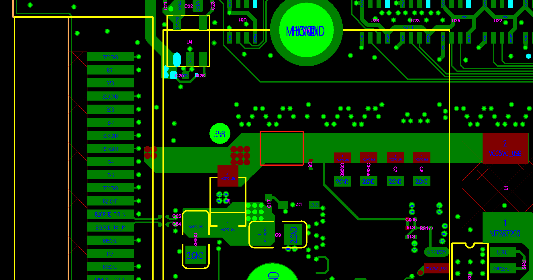

      where can I see the current on VCC5V0_USB?
        george @alfek last edited by
        @alfek
        Sorry, CM5-EVB is currently unable to directly test the VCC5V0_USB current. If you have some hands-on ability, you can try adding a 100 milliohm sampling resistor at the position shown in the diagram to determine the current by testing the voltage at both ends of the resistor.
