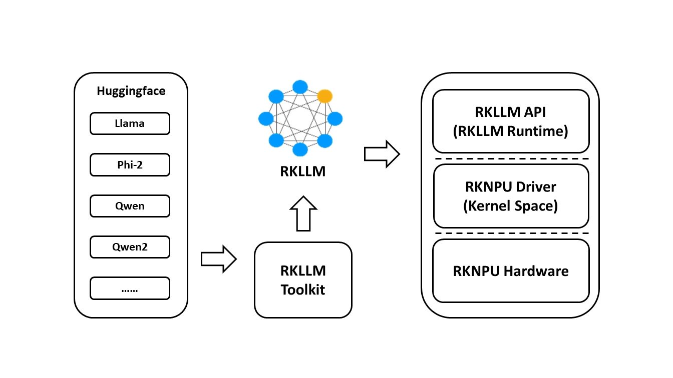

        Description
        RKLLM software stack can help users to quickly deploy AI models to Rockchip chips. The overall framework is as follows:
        In order to use RKNPU, users need to first run the RKLLM-Toolkit tool on the computer, convert the trained model into an RKLLM format model, and then inference on the development board using the RKLLM C API.
        • RKLLM-Toolkit is a software development kit for users to perform model conversionand quantization on PC.
        • RKLLM Runtime provides C/C++ programming interfaces for Rockchip NPU platform to help users deploy RKLLM models and accelerate the implementation of LLM applications.
        • RKNPU kernel driver is responsible for interacting with NPU hardware. It has been open source and can be found in the Rockchip kernel code.
        Support Platform
        • RK3588 Series
        • RK3576 Series
        Download
        • You can also download all packages, docker image, examples, docs and platform-tools from RKLLM_SDK, fetch code: rkllm

        Notes
        Due to recent updates to the Phi2 model, the current version of the RKLLM SDK does not yet support these changes.
        Please ensure to download a version of the Phi2 model that is supported.
        CHANGELOG
        v1.0.0-beta
        • Supports the conversion and deployment of LLM models on RK3588/RK3576 platforms
        • Compatible with Hugging Face model architectures
        • Currently supports the models LLaMA, Qwen, Qwen2, and Phi-2
        • Supports quantization with w8a8 and w4a16 precision
