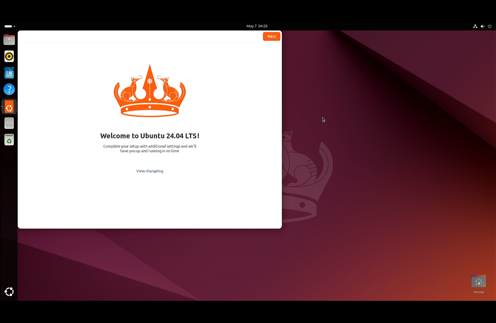

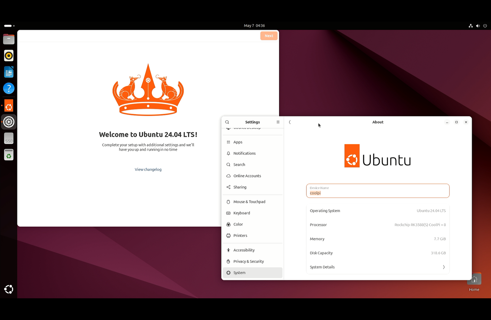

    Coolpi Ubuntu 24.04 is coming soon!!

        @george It looks pretty good ! Hope it will go live by the end of May.

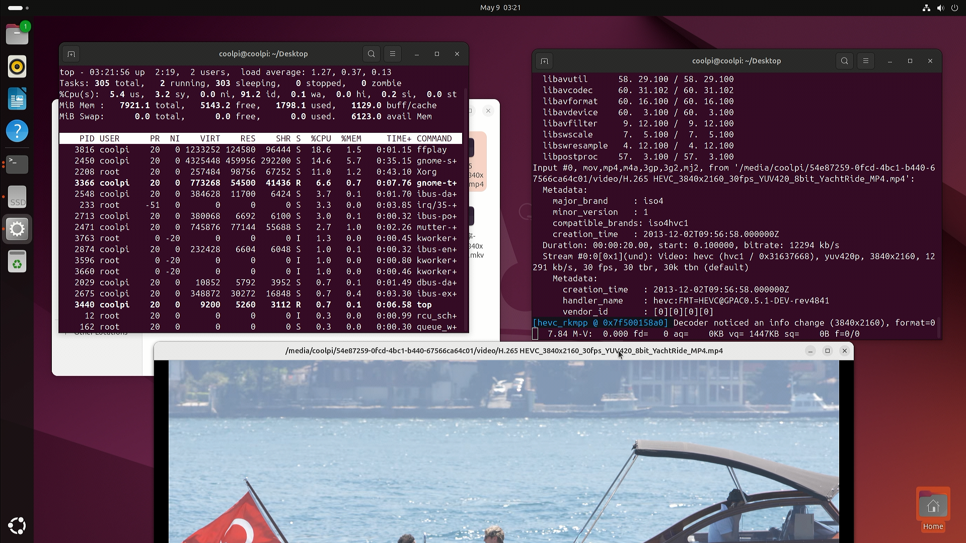

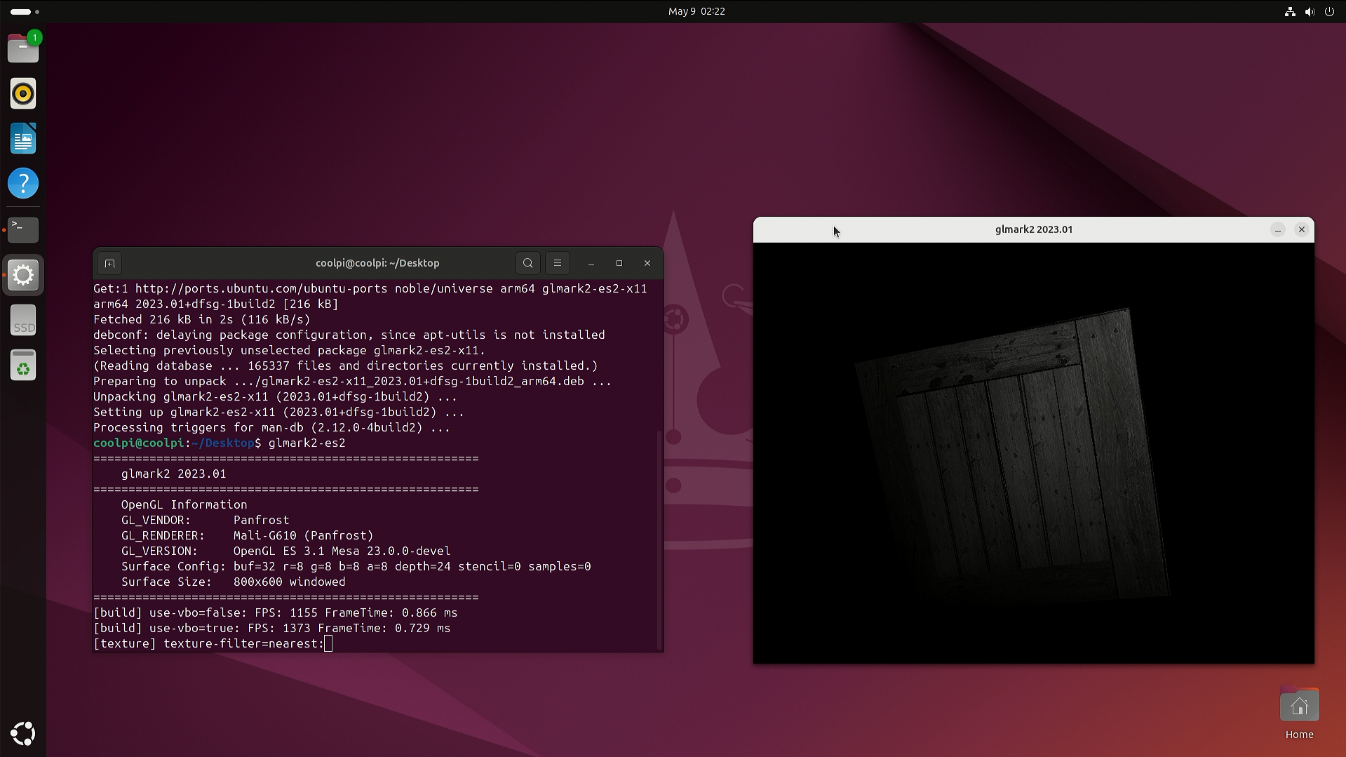

          Add GPU driver
          Add hardware decoding for FFMPEG videos

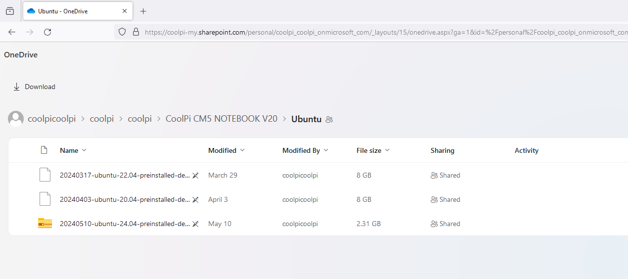

            The Ubuntu 24.04 image has really been released and can be obtained from Baidu Cloud or Onedrive. Thank you for your support.

                  The cloud storage provides a 22.04 image, which you can download and upgrade.

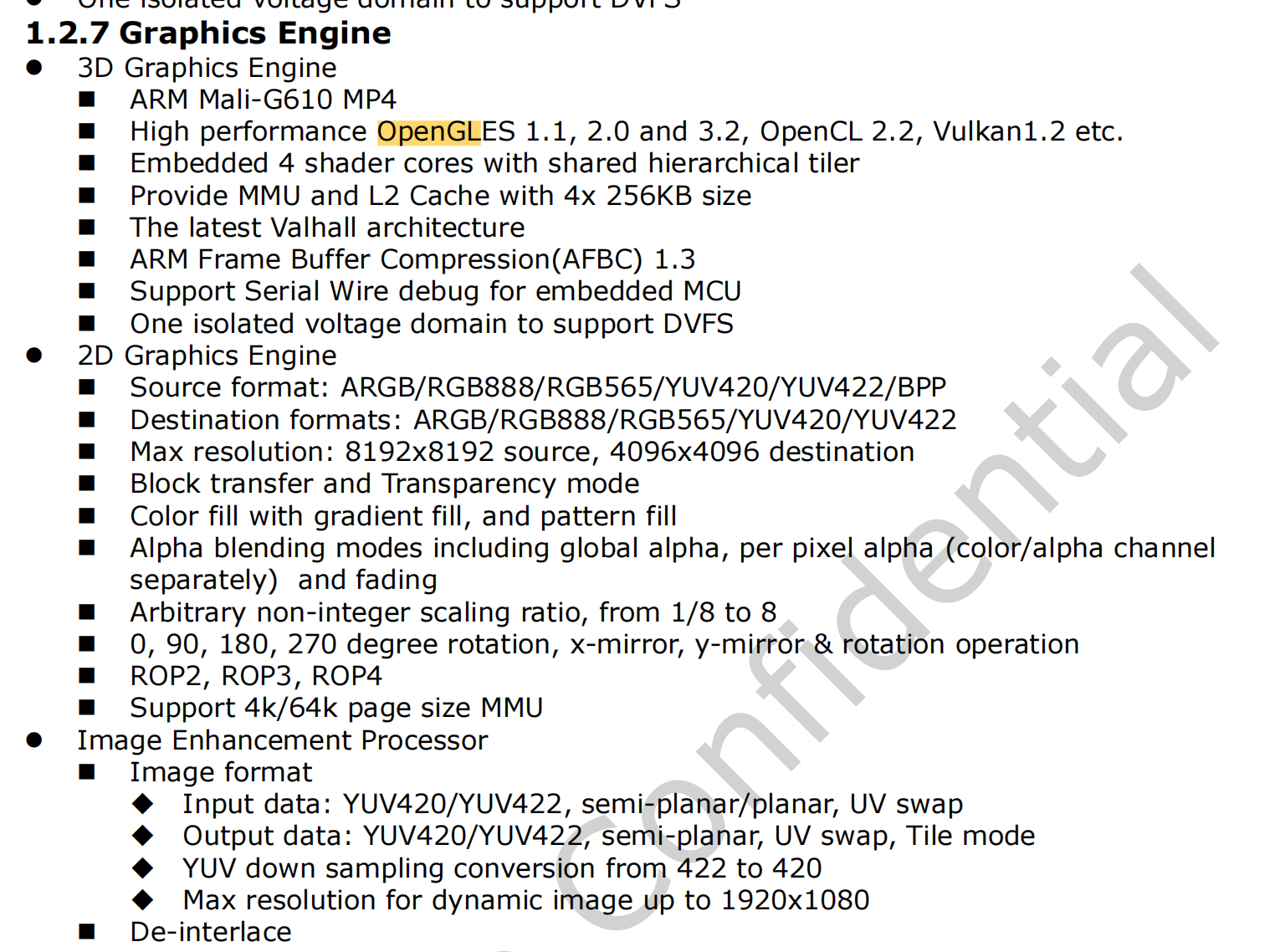

                                  1.RK3588 MALIG610 can only support OPENGLES-3.2, I am not sure if this 4.5 is compatible. The GPU driver of Coolpi will be switched to Panthor in the future.
