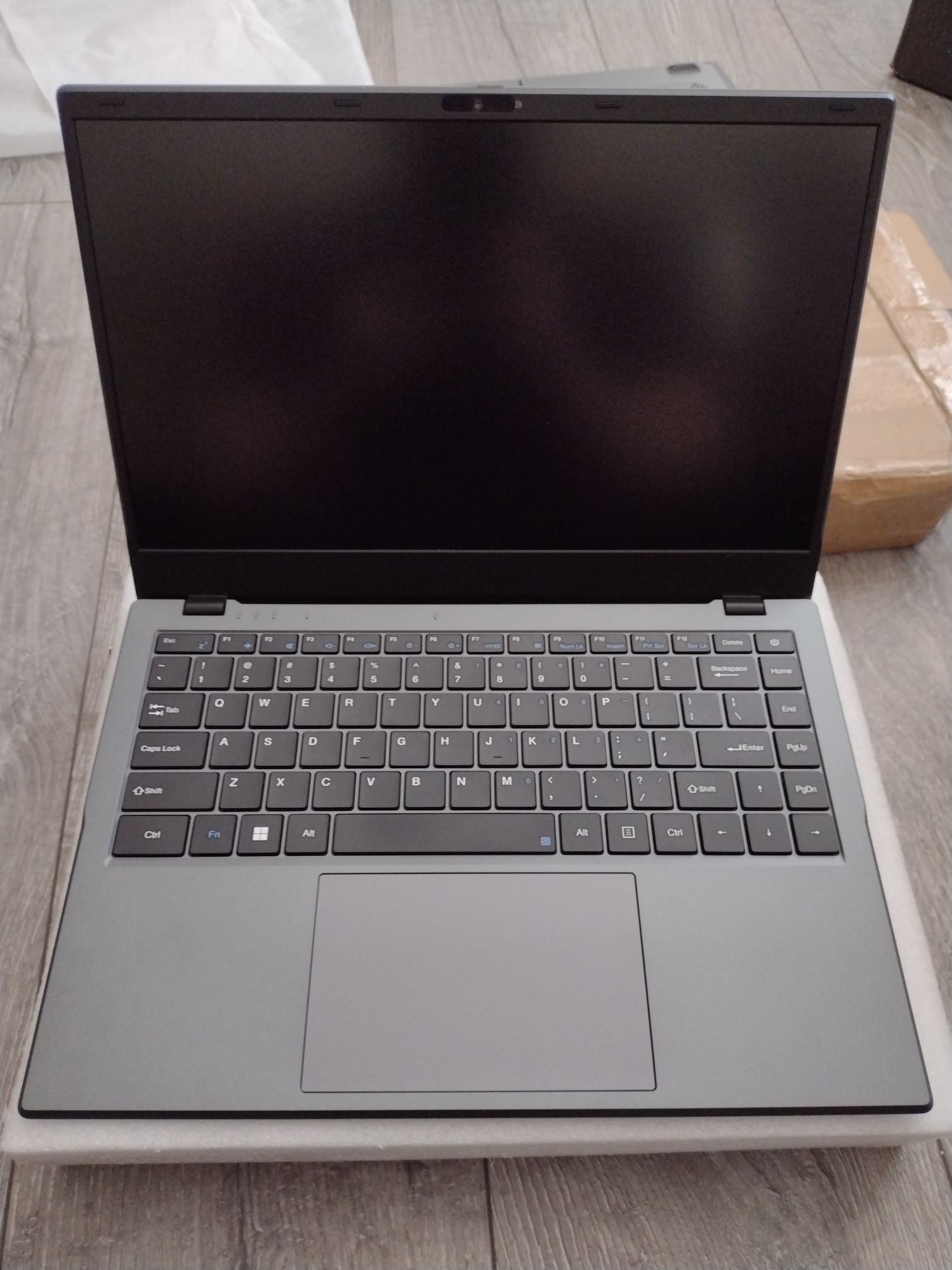

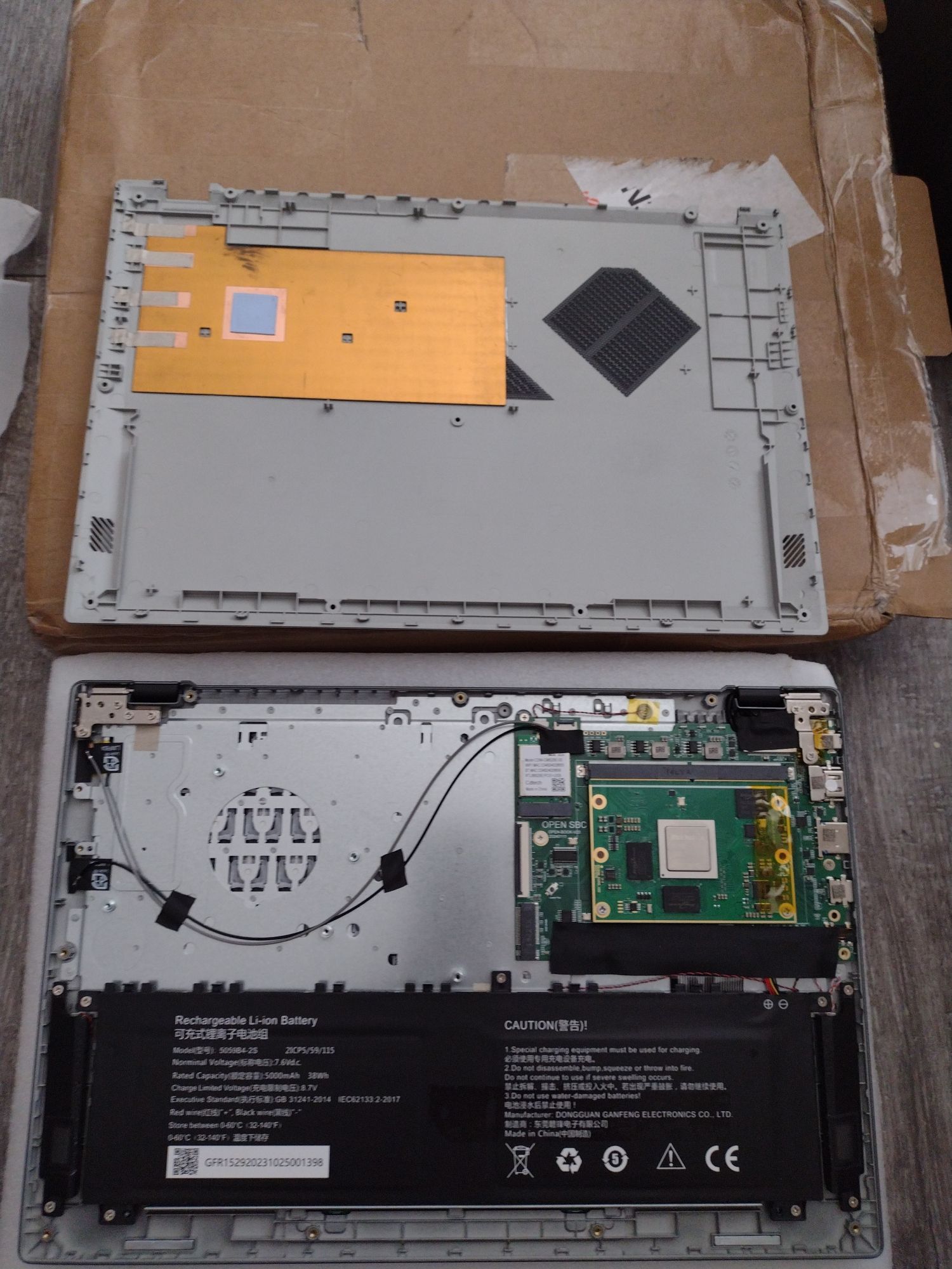

      The laptop has a unusually thick shell (about 2,0mm+ and more in other places) Can`t think of any 14" laptop that feels as sturdy as this one, very little flex. The Keyboard has a quality feel to it, good to type on and low noise.
      Touch-pad is large, a bit noisy when clicking, otherwise okay.
      Screen is a 14" IPS, fair brightness (250nits) and vibrant colors, some light bleeding in the lower corners, but that is to be expected.
      Ah and the "intel inside" sticker made me chuckle (before i removed it)

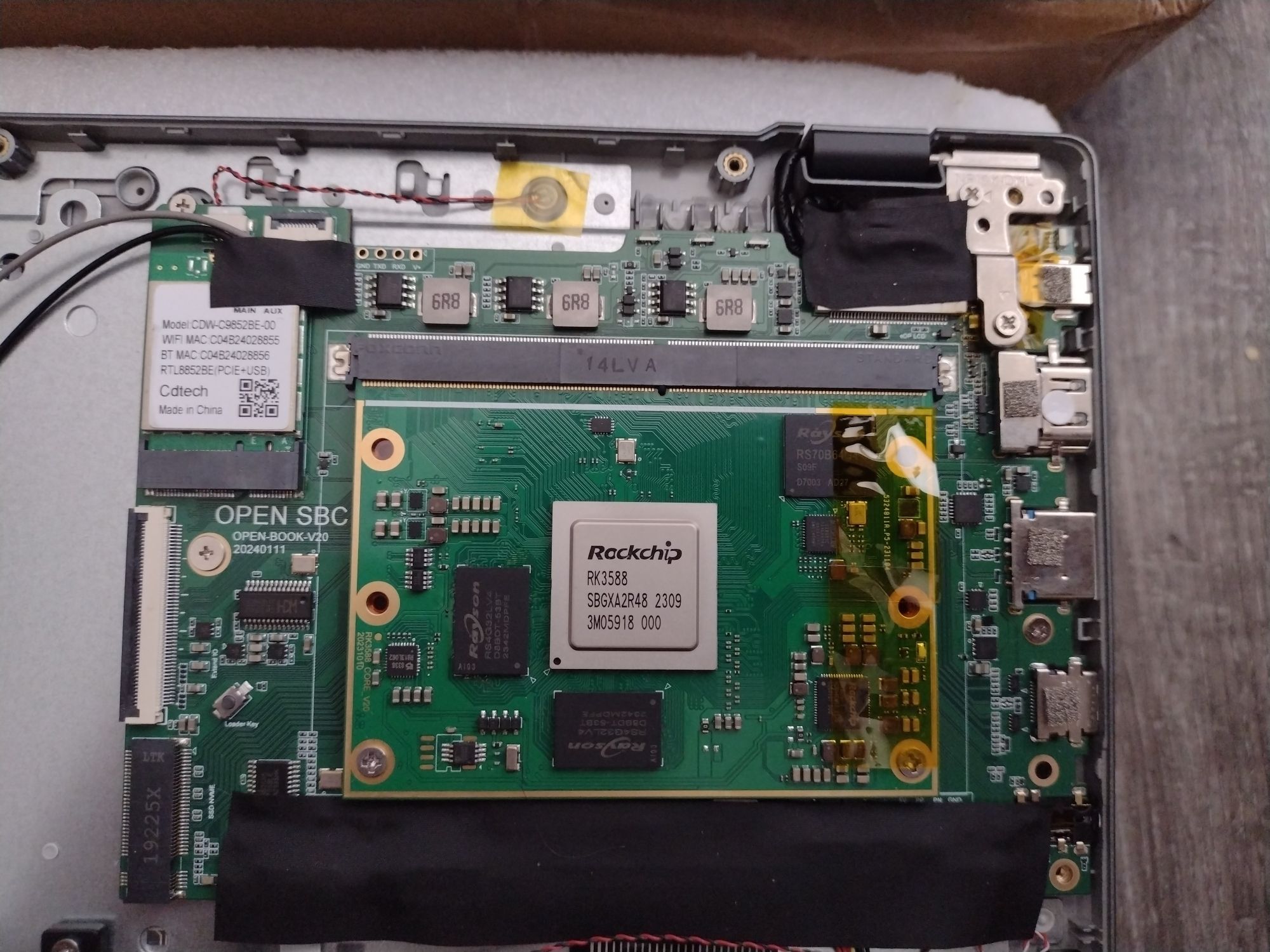

      The hardware is impressive, 8 core RK3588, 32gb lpddr4x (on a core board) Mainboard with Nvme, pcie slot for wlan, 1x USB3 and 1x USB-C port and internal connectors for additional boards and HW.

        Thank you very much for your support of Coolpi products. As a DIY laptop, the extreme thickness is not very user-friendly, and the main issue is that there may be a lack of sufficient internal space for secondary development.
        Regarding the issue with the kernel version, as the original factory has not yet submitted an update to the hardware encoding and decoding part of the 6. x kernel video, the machine is currently using 5.10.110. We will synchronize the submission once this issue is resolved.
        After the mainline kernel 6.8, devices that natively support CM5 have also been designed for laptops based on the CM5 core board, allowing for synchronous use of the mainline kernel. The mainline version of uboot has also been merged into the mainline recently.

          Regarding the issue of startup speed, it is mainly due to the initialization time of the RTL8852BE driver, not the speed of the EMMC. We are still trying to find ways to optimize this.Think you.

            Thanks for your reply and insight. As for the thickness of the shell, i actually think that is a positive point, the thick shell makes it very well suited for people like me (ict-manager) I feels like it will travel well: The sturdiness, passive cooling, power efficiency and having a large battery is just what i need.
