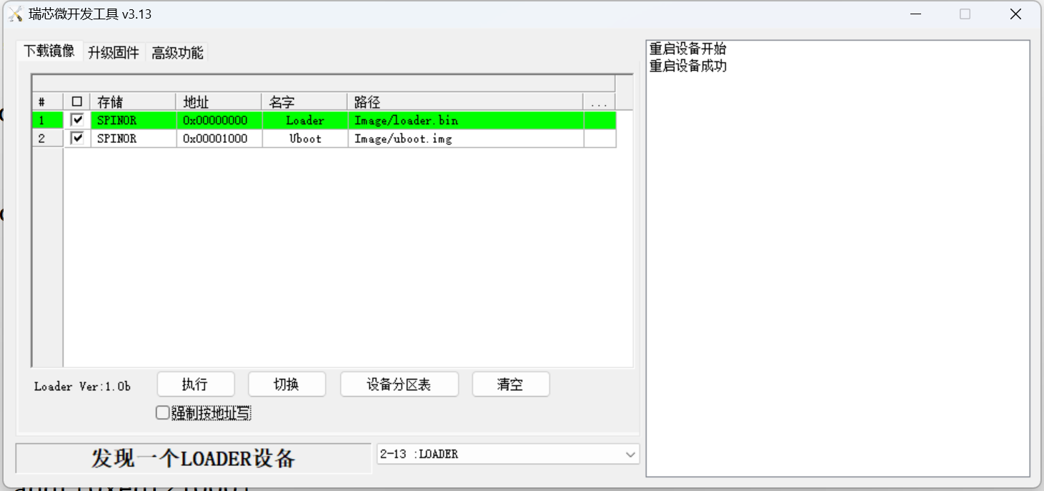

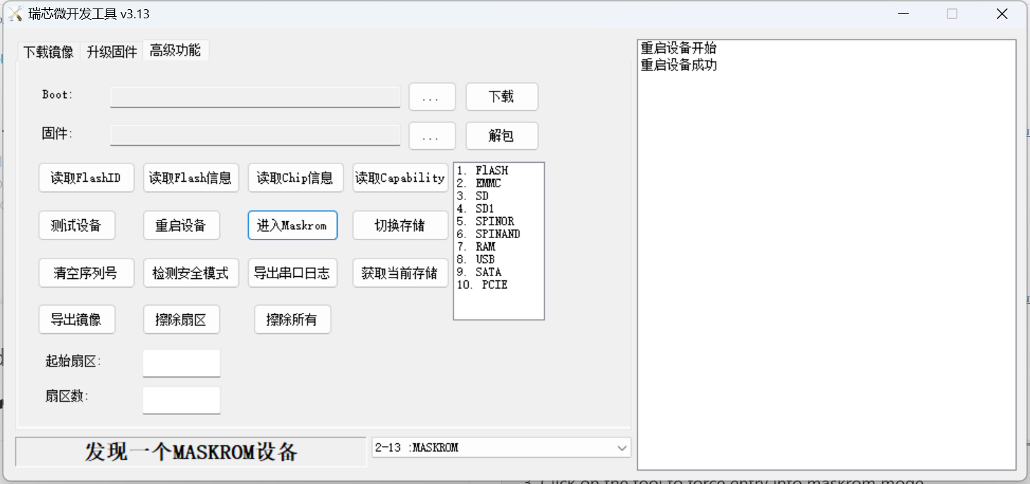

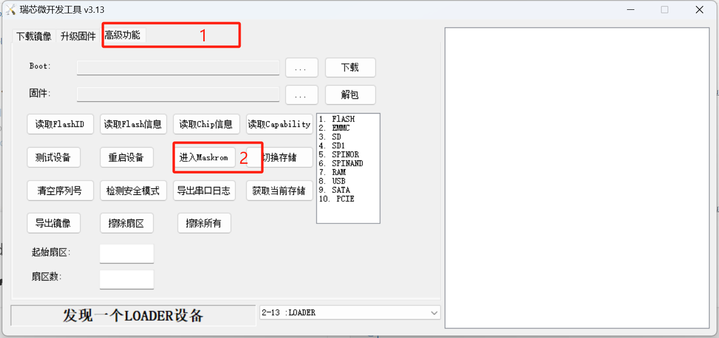

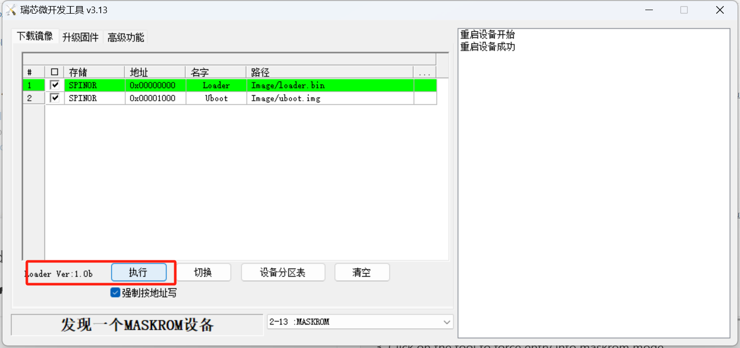

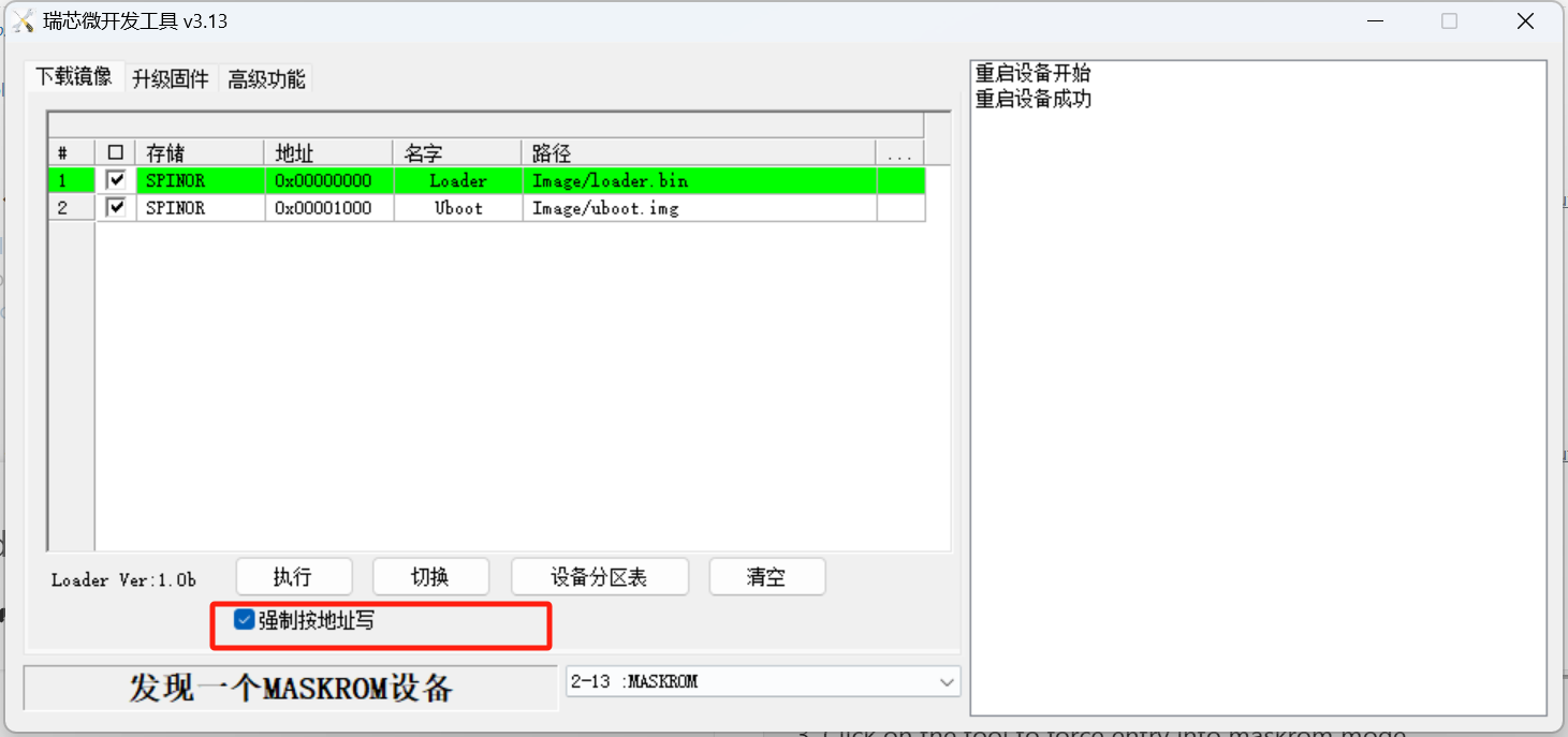

                                                        Follow the steps below to operate:
                                                        1.USB cable for TYPEC interface and X86 computer connection
                                                        2. Run sudo reboot loader on the shell,The machine will enter loader mode, as shown in the following figure
                                                        3. Click on the tool to force entry into maskrom mode
                                                        4. Check the option to force writing by address
                                                        5. Burning, the machine will automatically restart after completion
                                                        plumlis 1 Reply Last reply Reply Quote 0
