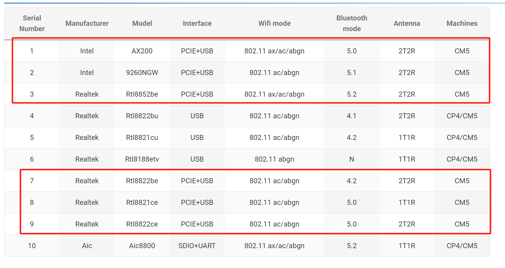

        george @plumlis last edited by
        @plumlis
        The AX200 has been tested before and can be used, but the AX210 is still not working. Waiting for subsequent kernel upgrades. The model shown in the figure has been previously verified.
