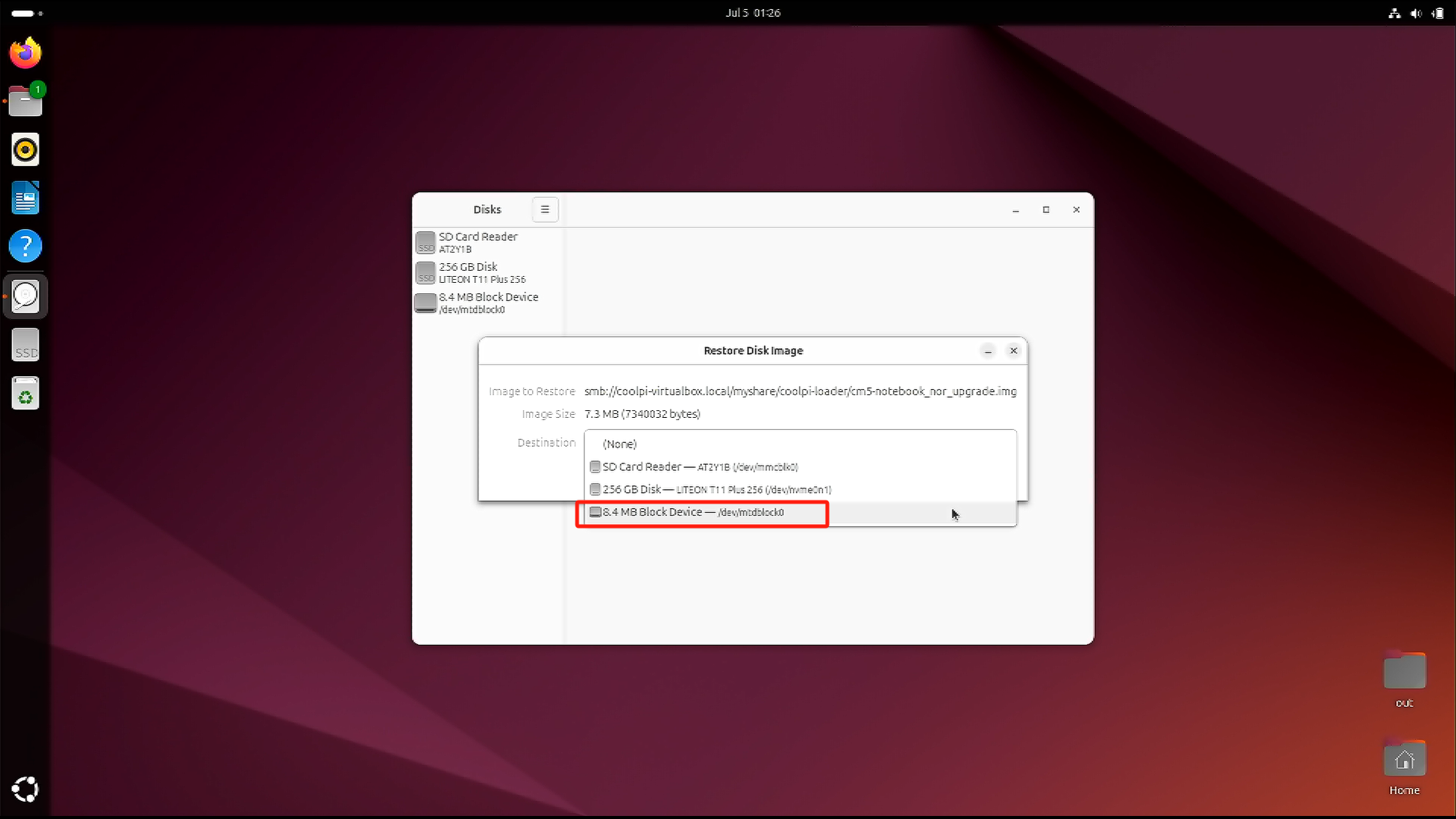

      • When the coolpi-kernel is synchronized to the latest compiled and updated kernel, the system will display a device node of /dev/mtdblock0.

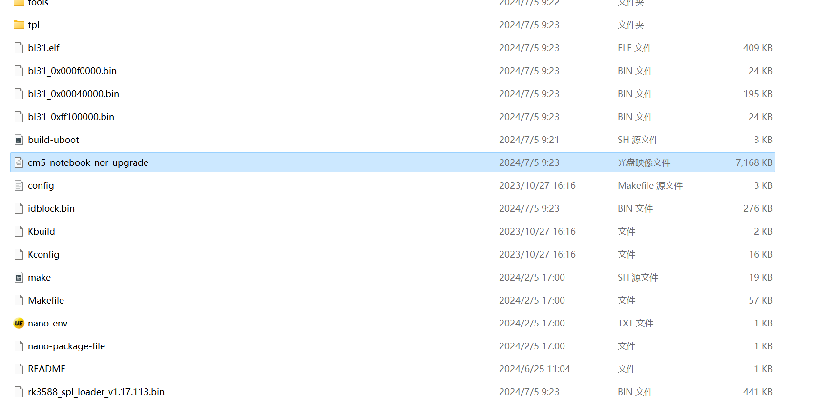

      • Synchronize the coolpi-loader code to the latest version, switch to the develop branch, compile and generate cm5-notebook-nor-upgrade. img
      • Use the following command to update:
        sudo dd if=/**/cm5-notebook-nor-upgrade.img of=/dev/mtdblock0 bs=1k count=8192
      • You can also directly use the Disk Image Writer built-in in the Ubuntu system to update

        在x86机器上的docker环境 ubuntu:20.04 下可以构建成功。arm 笔记本上发现最后一步不形,估计是使用的工具有x86下的二进制文件.
        apt install build-essential device-tree-compiler bc python2
        ./build-loader.sh cm5-notebook
