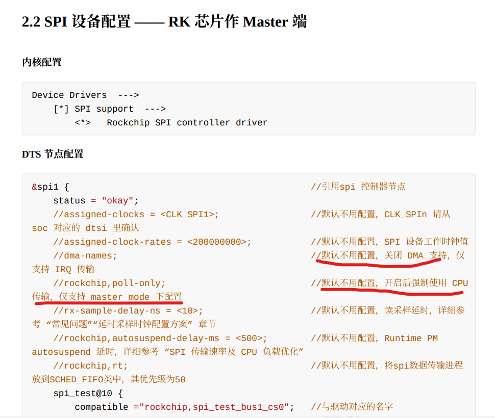

      我做设备驱动,测试过,默认SPI传输不开启DMA,如何打开master mode,用DMA传输
        george @happyday last edited by
        @happyday
        下图是SPI1对应的属性配置,把dmas和dma-names复制到DTS文件对应节点即可。
        	spi1: spi@feb10000 {
        		compatible = "rockchip,rk3066-spi";
        		reg = <0x0 0xfeb10000 0x0 0x1000>;
        		interrupts = <GIC_SPI 327 IRQ_TYPE_LEVEL_HIGH>;
        		#address-cells = <1>;
        		#size-cells = <0>;
        		clocks = <&cru CLK_SPI1>, <&cru PCLK_SPI1>;
        		clock-names = "spiclk", "apb_pclk";
        		dmas = <&dmac0 16>, <&dmac0 17>;
        		dma-names = "tx", "rx";
        		pinctrl-names = "default";
        		pinctrl-0 = <&spi1m1_cs0 &spi1m1_cs1 &spi1m1_pins>;
        		num-cs = <2>;
        		status = "disabled";

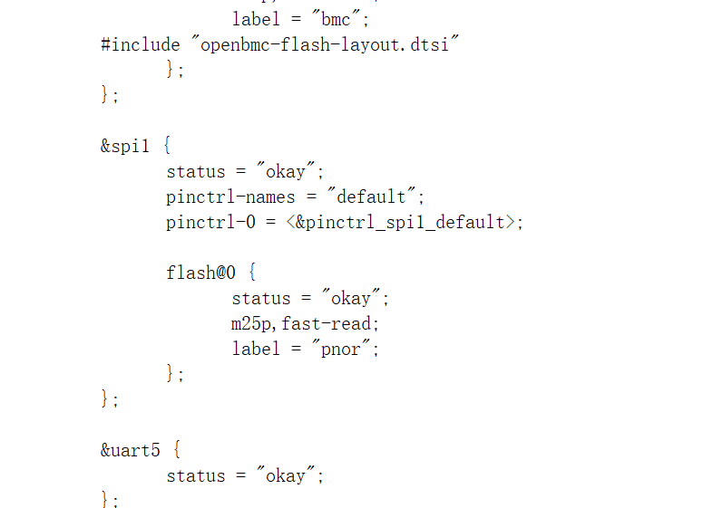

          @george 我用的ubuntu的操作系统,下载的ubuntu的内核源码,在aspeed-bmc-supermicro-x11spi.dts中找到了SPI1的,我可以直接把你提供的代码粘进去,编译替换吗
            @happyday
            这个是不一样的,关于DTS的配置参考之前发的文档,或者在rockchip的DTS目录里边找一下对应的配置,其它平台的不适用。

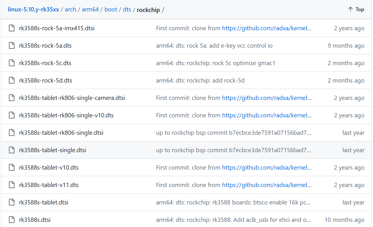

              @george 是让我去github下载arch/arm64/boot/dts/rockchip/rk3588s-cp4.dts
              这个源码吗,我没找到
              • H
                happyday @george last edited by
                只找到了这个
