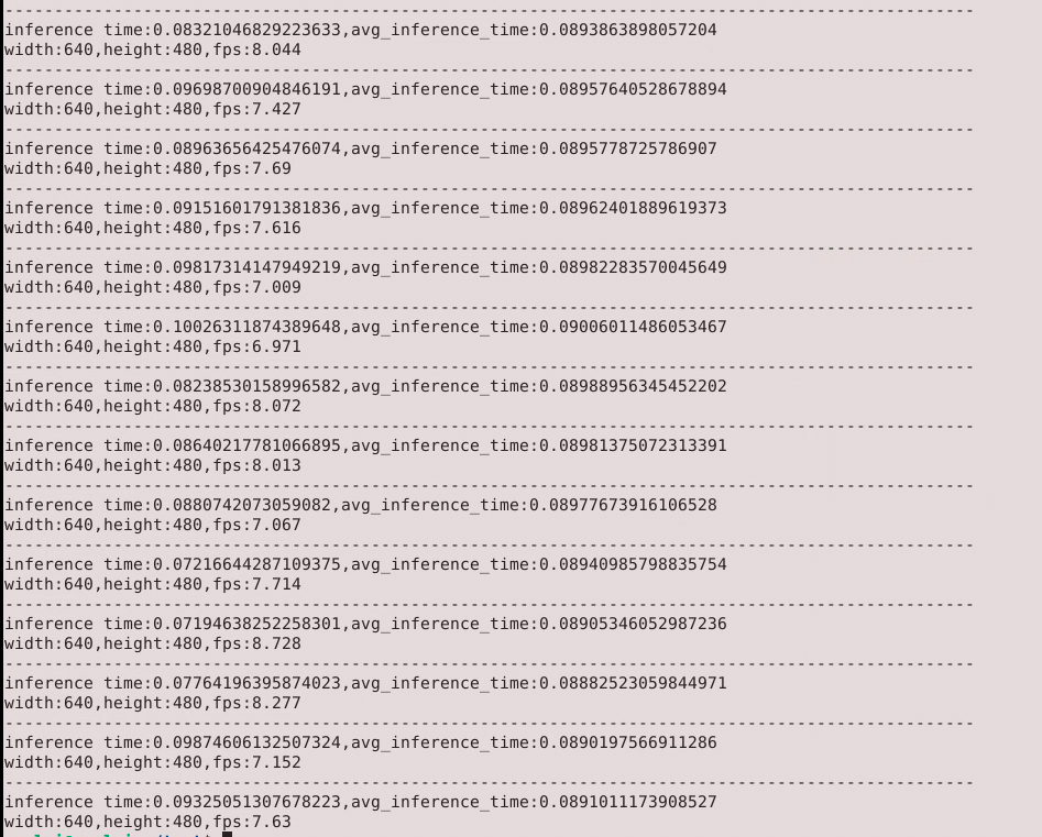

                        ccjjww1222 @zhengbicheng last edited by Oct 23, 2022, 1:11 PM
                        @zhengbicheng 这个是我摄像头推理的时间:
                        inference time:当前这一帧的推理时间
                        avg_inference_time:以上所有帧平均推理时间
                        width:宽
                        height:高,
                        fps:fps
                        这样的推理时间正常不 ?
                        zhengbicheng 1 Reply Last reply Oct 23, 2022, 6:24 PM Reply Quote 0
                        • zhengbicheng
                          zhengbicheng @ccjjww1222 last edited by Oct 23, 2022, 6:24 PM
                          @ccjjww1222 正常,确实就是100ms左右
