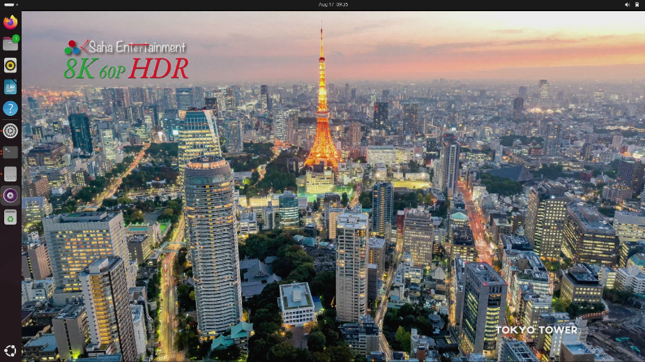

    6.1 Kernel Notebook Image Release
    25
    2426
      • Customize the kernel using 6.1.75
      • NPU driver updated to 0.9.7
      • Support rkmpp video hardware decoding, with a maximum resolution of 8KP60
      • Delete default username and password, register upon startup
      • GPU driver defaults to using Panfrost
