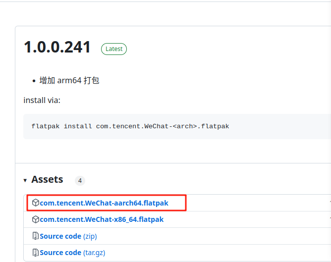

      • Open the following address and download the file with the. flatpak suffix.
        https://github.com/web1n/wechat-universal-flatpak/releases
        Select the following aarch64 version

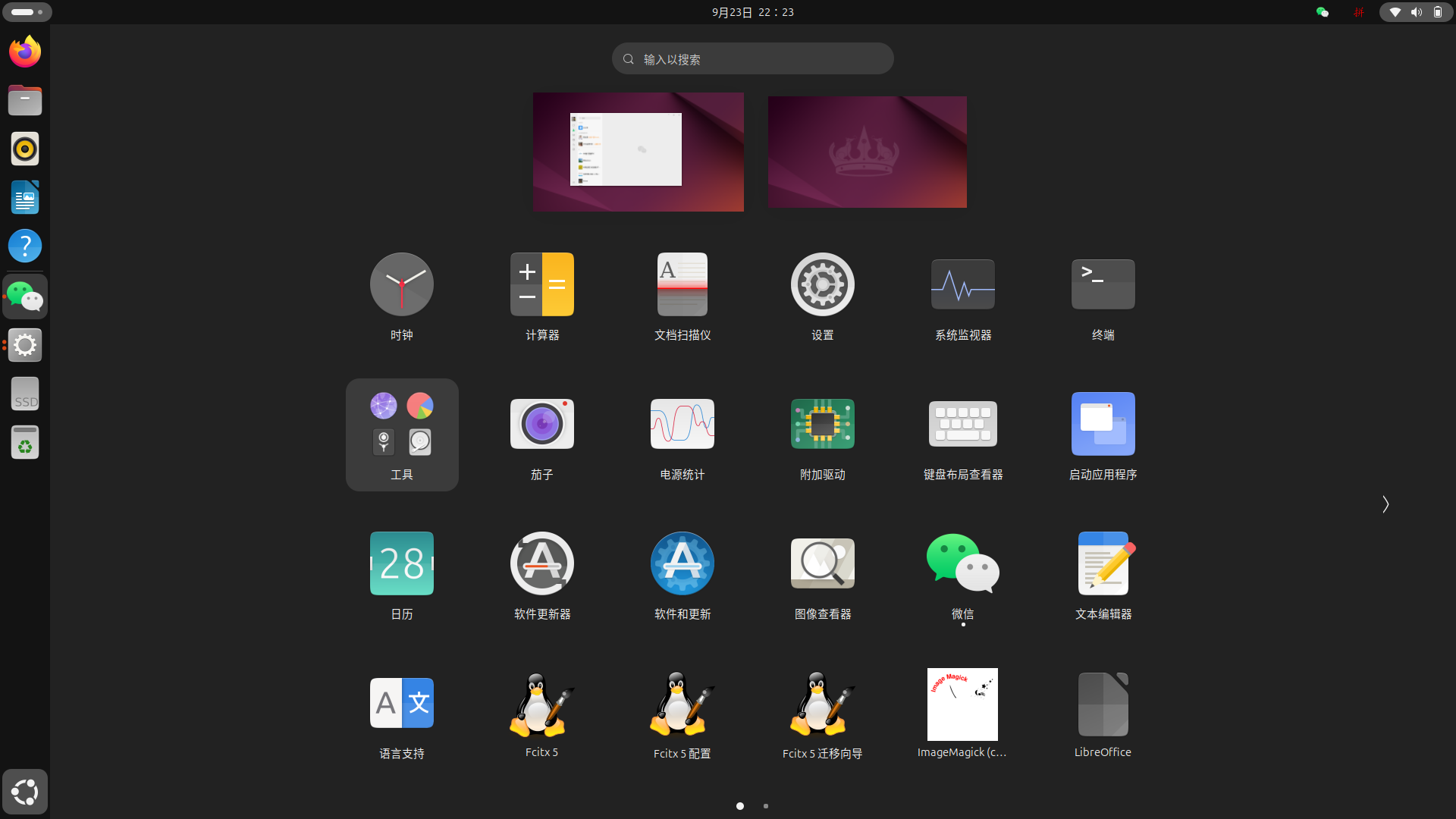

      • Copy icon
        sudo cp /var/lib/flatpak/app/com.tencent.WeChat/current/active/export/share/        applications/com.tencent.WeChat.desktop /usr/share/applications/
        sudo cp -R /var/lib/flatpak/app/com.tencent.WeChat/current/active/export/share/icons/hicolor/* /usr/share/icons/hicolor/
