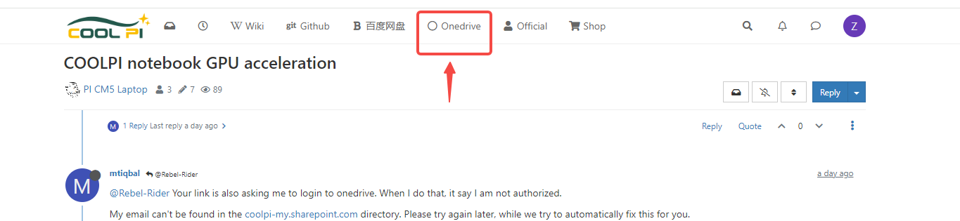

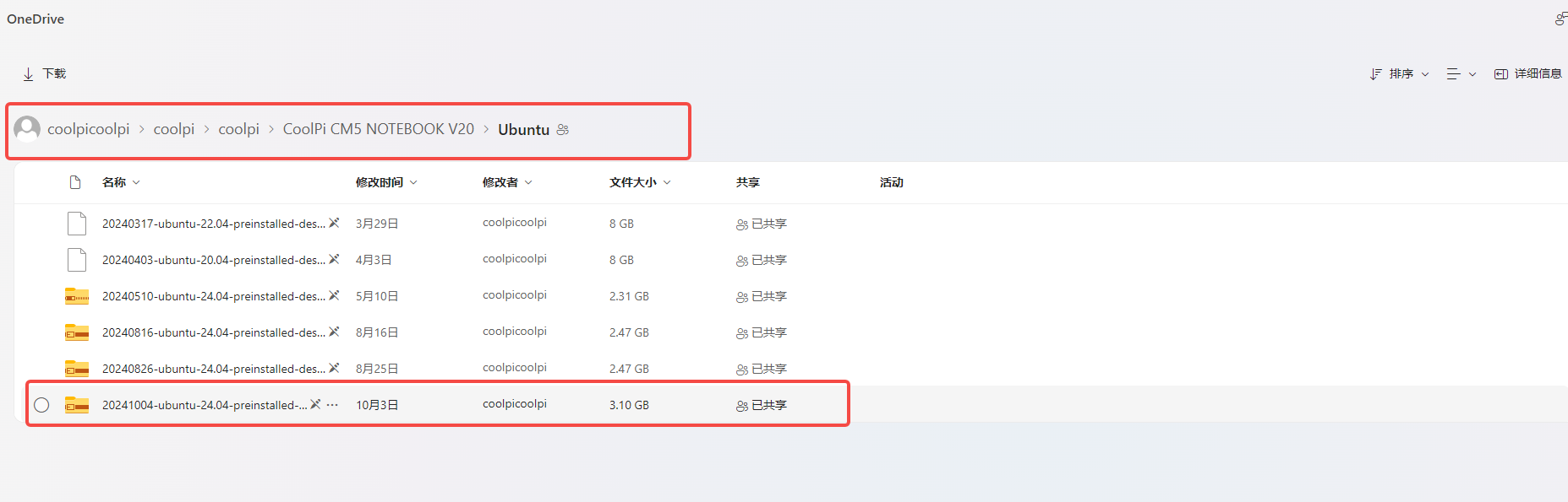

                    zehui @mtiqbal last edited by
                    @mtiqbal try this link: https://coolpi-my.sharepoint.com/personal/coolpi_coolpi_onmicrosoft_com/_layouts/15/onedrive.aspx?ga=1&id=%2Fpersonal%2Fcoolpi_coolpi_onmicrosoft_com%2FDocuments%2Fcoolpi%2Fcoolpi%2FCoolPi CM5 NOTEBOOK V20%2FUbuntu
                    Or you can manually navigate to the file:
                    1. click one drive on the top bar of the forum:
                    2. navigate to the right path, and download the 3.10 GB file:
                      mtiqbal @zehui last edited by
