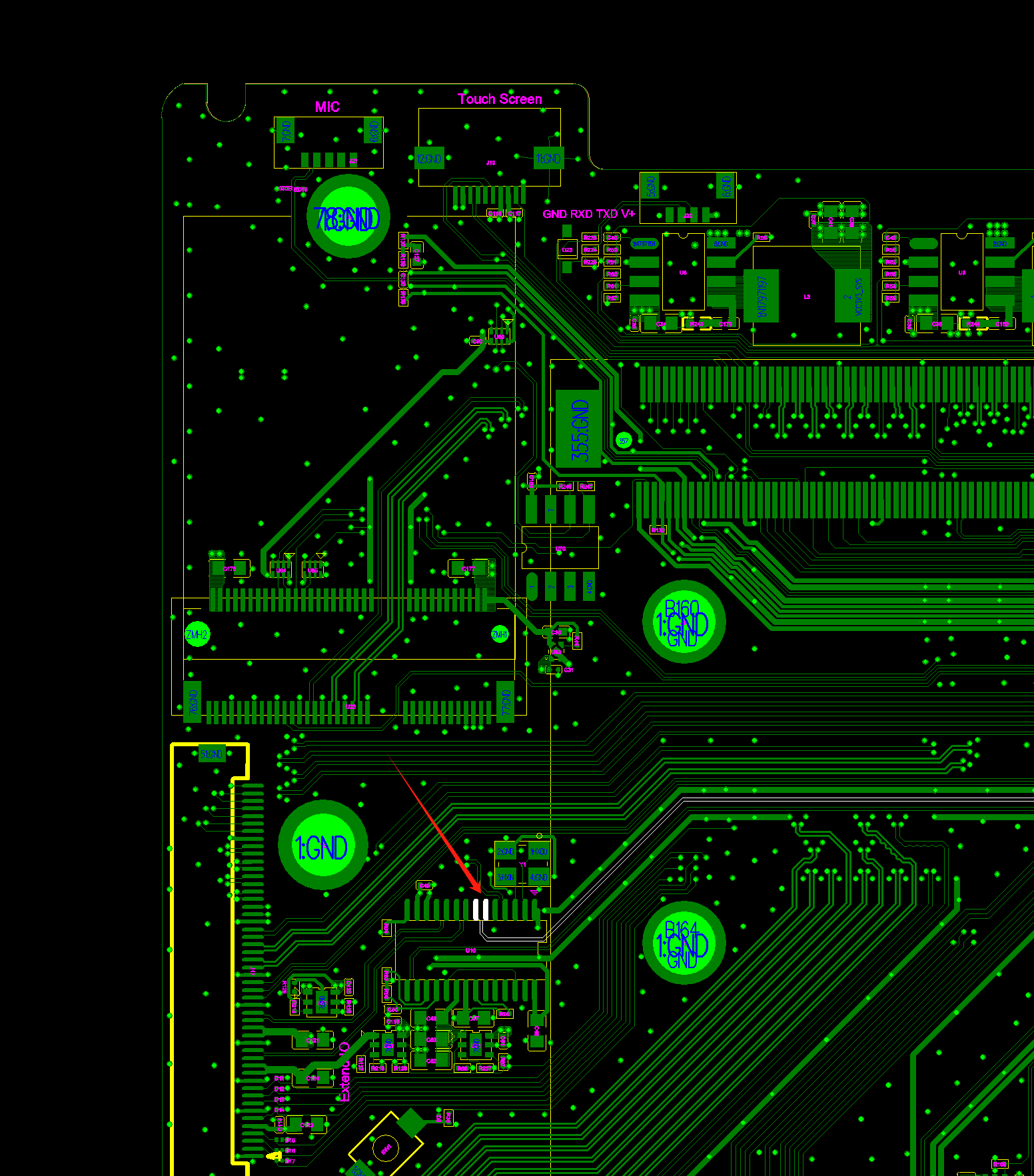

                      george @Momo 0 last edited by
                      @Momo-0
                      Need to cooperate with testing first to determine where the problem lies?
                      1. Connect the LCD cable and use a multimeter to test the ground impedance of the two PINs shown in the figure below
                      2. Disconnect the LCD cable and use the same method to test the ground impedance of two PINs
                        Test method: Set the multimeter to the diode position, connect the red probe to GND, and connect the black probe to the signal.
                        Momo 0 @Momo 0 last edited by
                        @Momo-0 I tested both Pins with and without the LCD cable attached, but I get no connectivity between them and ground. No beeping
